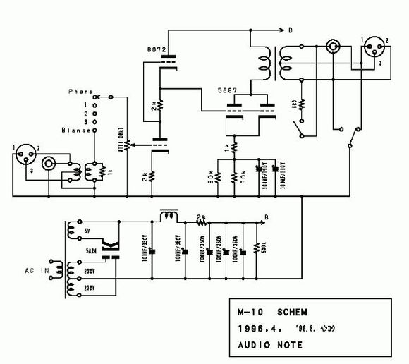

I am planning to build M10 tube preamp. Does anyone know the primary and secondary impedance values of the output transformer?
http://www.diyparadiso.com/schemas/pre amps/m10 schema duidelijk.gif
Here is additional info on Chinese web site
Trans 027 data:
PRI DCR 397,Inductance 110H,Sec DCR 20 Ohms *2 , Impedance ratio 33:1
Trans 027 data:
