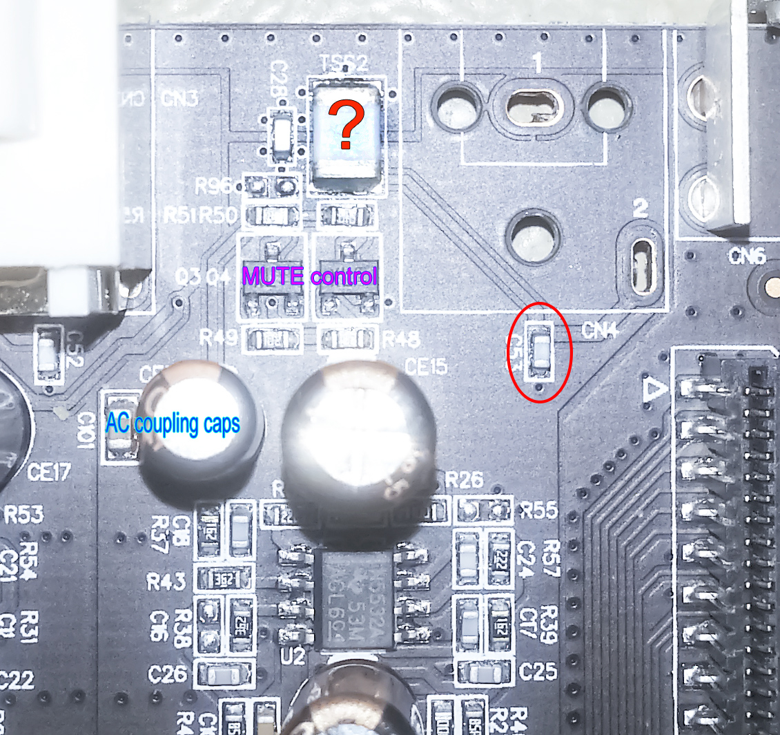

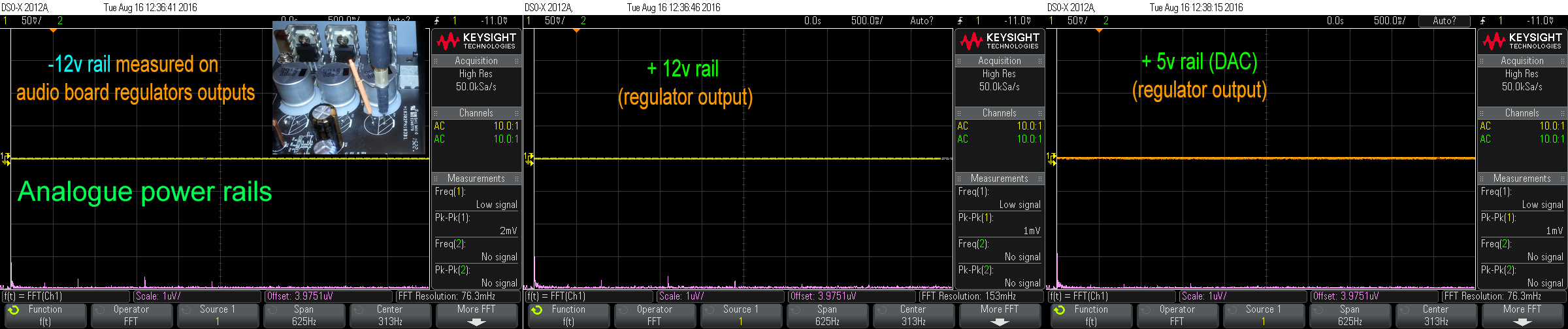

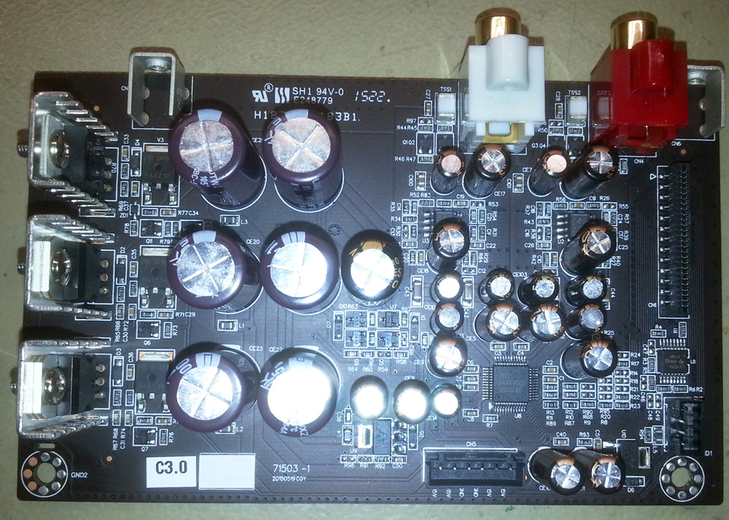

When about the audio board, this model is based on a AK4490 DAC. This device is very much integrated, it output fully differential directly, no I/V converter involved, and it sounds well enough (so as it is implemented by Oppo). BTW, the DAC chip AK4490 is priced at Digikey for 5$ (one piece)...
The sound board/DAC is powered by two differential raw rails (+/-15v from SMPS), which are further linear regulated (LM317/337) to 12v. Also a 5v regulator it is used for the analogue stage of the DAC chip. This 5v is down regulated from the raw +15v rail, while the analogue 3,3v for the DAC chip is regulated down from the +12v line. The 3,3v for DAC digital stage it is regulated from the digital 5v rail, created on main board, and also used for USB ports. The linear regulators on this board are switched on power up, by some FET transistors, while the main +/- 15v rails are always on.
The DAC chip is AC coupled to the final buffer, which is further AC coupled to the outputs. I`m not very impressed by this chosen approach...
The final buffer it include a double opamp chip (N5532), which is not a very special quality device... Common, standard, low cost chip...
The DAC it looks like it works in a synchronised modus, and it is clocked by the main digital audio signals (PCM/DSD).
At least not so many clocks/oscillators in this device, than the one for the main processor. And this one is a resonator actually...
Examining closer the audio board, I was intrigued by the last components in this chain. After so many AC coupling stages used into the signal path, I could see more (see picture here), a cap to the ground right on the RCA output, as a component market TSS also tied to the ground. This component it looks like a big ceramic cap, and I can not figure out what its role it may be. I seems like a protection device for some static protection on audio outputs... Well, I do not know what this it may be, but I really do not like it in the signal path at the very end of the chain... Also the MUTE mechanism is based on transistors switching. I would prefer more the relais... Maybe another improvement idea in this respect...
So, we shall only see forward to the improvement steps to come. First and sure big improvement: the power supply (replacing the original SMPS, with my LPM).

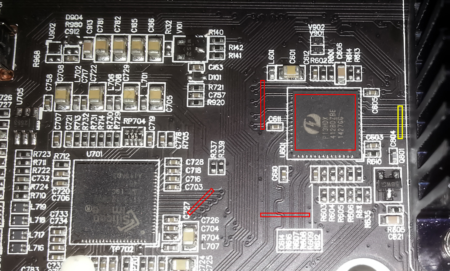

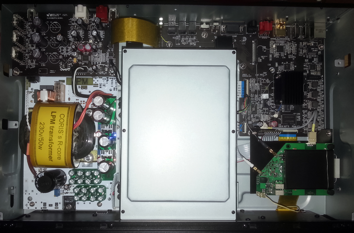

Main Board mods...

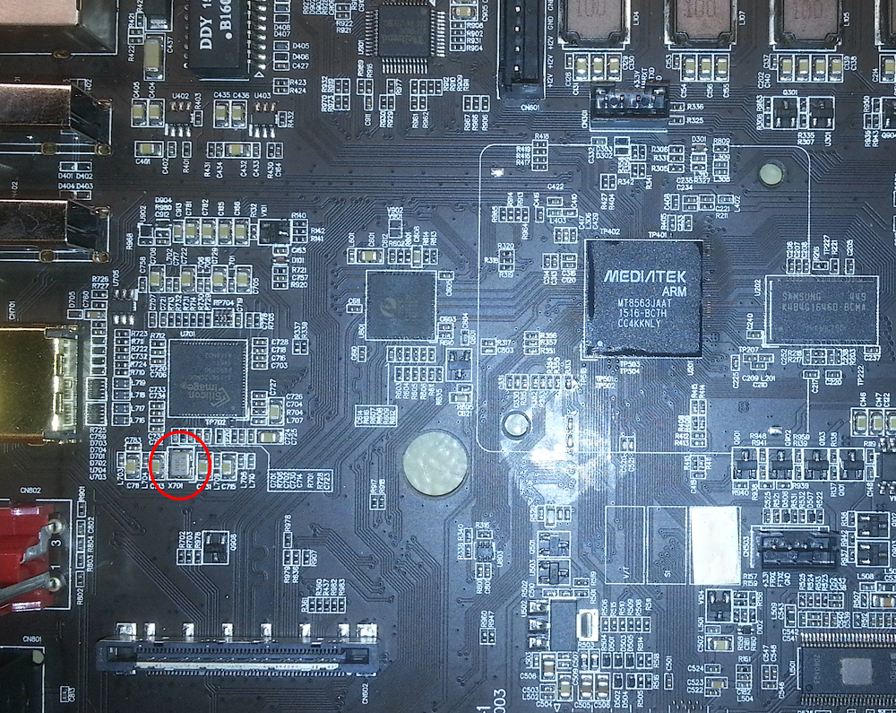

I think to make a correction to one of my previous posts. This Oppo model it have more clocks inside, than only one...
There is the HDMI chip which it have its own (27Mhz) resonator, and it internally generate its clock signal, as the main processor in Oppo`s design. Why they used separate 27Mhz clocks for these two main chips, is of course not known (except them self).
It seems that these resonators are so cheap as the designers can use a lot of... Every resonator for every single chip which it may need to be clocked...
Personally, I appreciate that the quality parameters of the device it gain more if these two chips, which hopefully it work on the same clock frequency, it may have one master oscillator to run it both with the same syncro clock signal.
As you see here, I used on this mod an Abracon 27Mhz oscillator, powered by battery, and distributed the same clock signal to these chips. Another option is to use my custom made SAW 54 Mhz oscillator, and then dividing the frequency, to get 27Mhz. This option is already in production...
The improvement of the main board is not yet finalised, so please ignore some remaining improvisations.
The next step is to install my new version LPM into this device...
P.S. I finally decided to remove the original mute circuits on audio board. The improvement of the audio signal quality it was immediate and obvious. Well, there are some pops on start up, on outputs. So, I designed a simple mute circuit, using relays, which it will be added accordingly to this board... Transistors control in a mute circuit is definitely not something good at all, for the outputted signal... I got fully confirmed this, once more, in this 101 player.

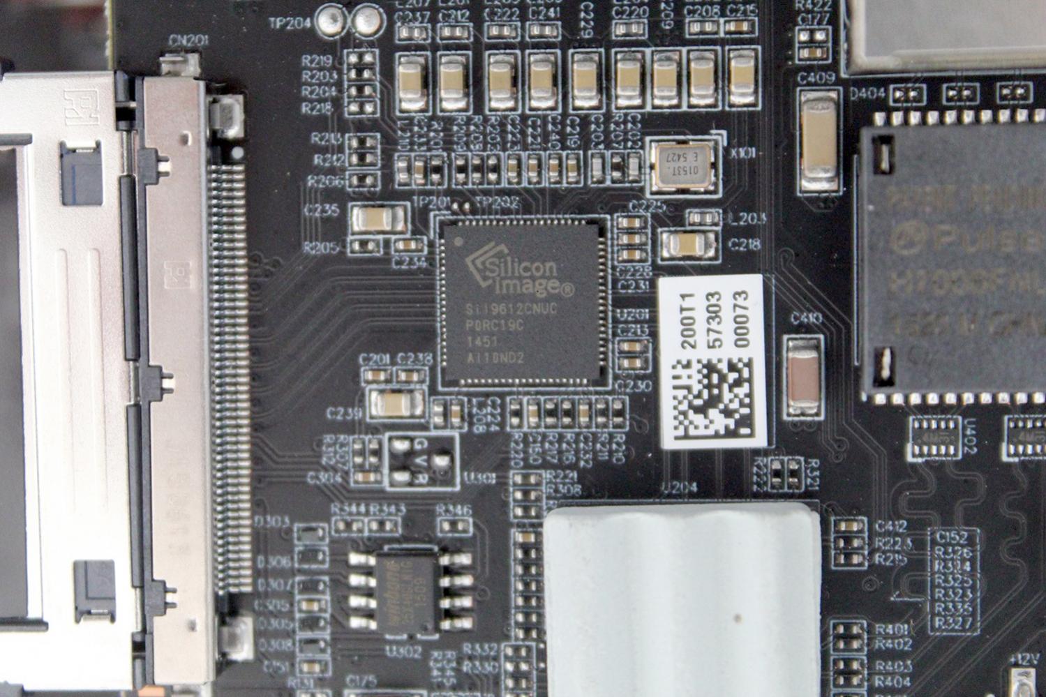

Yes, it is bizarre indeed...
The main processor it have integrated a HDMI processor too. However, Oppo still use the same approach with two HDMI channels (as these are also available). In this 101 model, there is a HDMI chip (Silicone Image xxxx), which it process on its own the video signal, and it send it to the standard HDMI output. The another HDMI channel, integrated into Mediatek ARM, it goes to another chip (processor), then it goes to the HDMI module (optional). For this second HDMI channel, it may be used the clock provided by the main processor (based on its 27Mhz resonator), or, indeed, it may be another clock on that module too... I did not investigated yet, closer this aspect....
The Silicone Image chip it have its own similar resonator, 27Mhz. Even the same marking, as for the Mediatek one... Mediatek resonator is on the down side of the PCB.
However, is better to unify the clock for these two chips...

Looking once again, and closer at the picture I already posted here, I think I may review my above assumption concerning the HDMI processing in 101 model.
As I can see, it seems that the four HDMI differential lines going out of the main processor (marked on the picture here), are getting into the P13HDX chip. The denomination of this component it suggest to me a kind of transmitter, driver or distributor for HDMI signals...From this chip, the HDMI lines are send further out in two channels. One HDMI channel it goes to the Silicon Image chip, and another channel it goes to the optional HDMI module connector. It looks like this P13HDX it distribute further the HDMI signals, processed into the Mediatek ARM (integrated HDMI co processor, or decoder). If it may be some more processing involved in this distribution, we may not know so far...
I found at least a picture for the optional second HDMI output module for 101. There is indeed a second Silicone Image chip on this module, with of course its own 27Mhz clock resonator (same marking on that as on the one for the main processor).
So, only one main oscillator 27Mhz it can be used to clock the whole device (if a such oscillator it may be able to drive three clock receivers chips...). I think it may works fine also.

One thought more about the clocks approach in 101...
I suppose the designers chosen to use a resonator for each of these processors internal clock system, because it is more easy, simple and cheap so, than implementing a master clock distribution circuit, with quite long clock (27Mhz) signal traces on the large enough main board. Such clock distribution circuit, it could be more complicated, when about to clock so a remote (optional) module, as this second HDMI output it is. In this case, The clock signal it should goes through a cable, through connectors, it had to be particular shielded, and so on... Much ore complicated, and more expensive... So, it was chosen each (internal generated) clock for each processor chip, even there is about the same frequency...
I used coaxes for my mod as unified clock system, but such approach it not fit for a production line (mass production)... However the main processor and the HDMI chip om main board are quite near to each other, so these two chips it could be clocked by the same signal... Anyway...

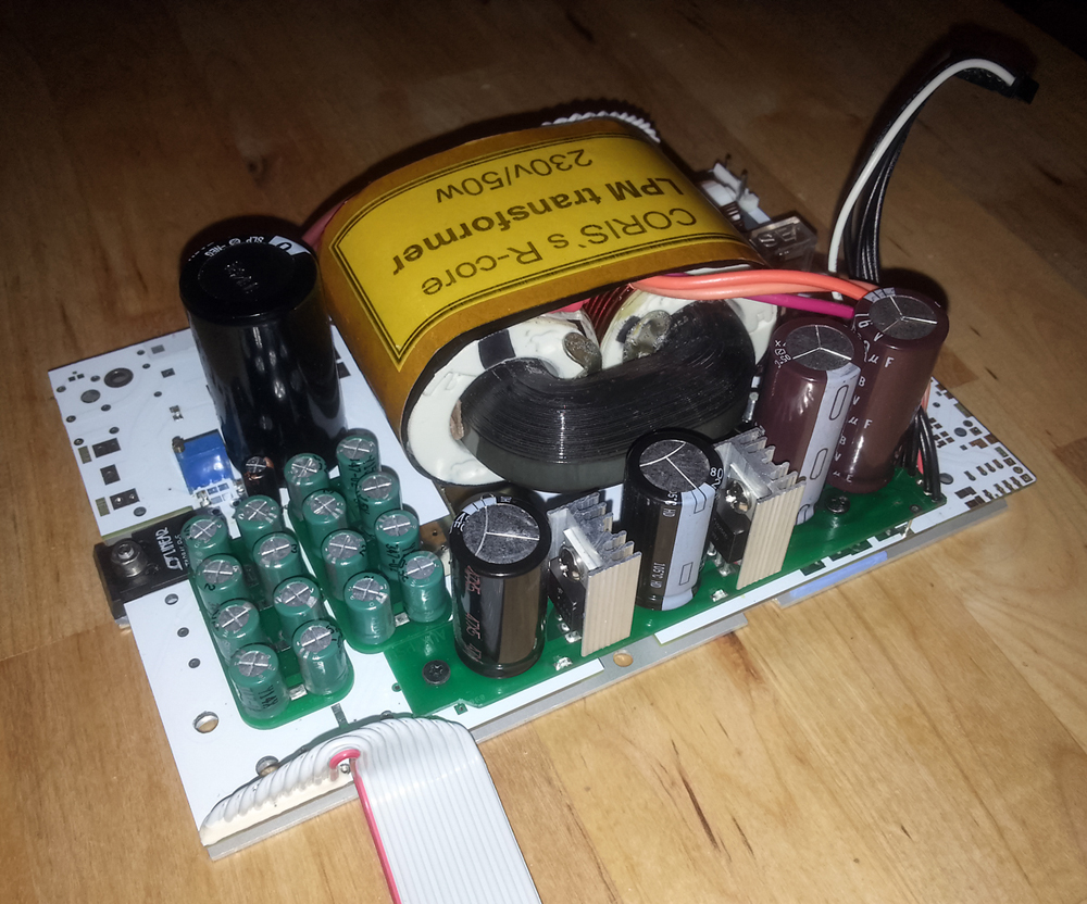

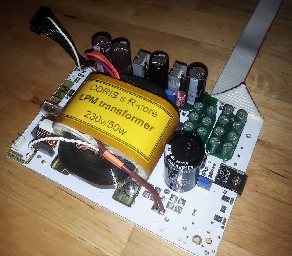

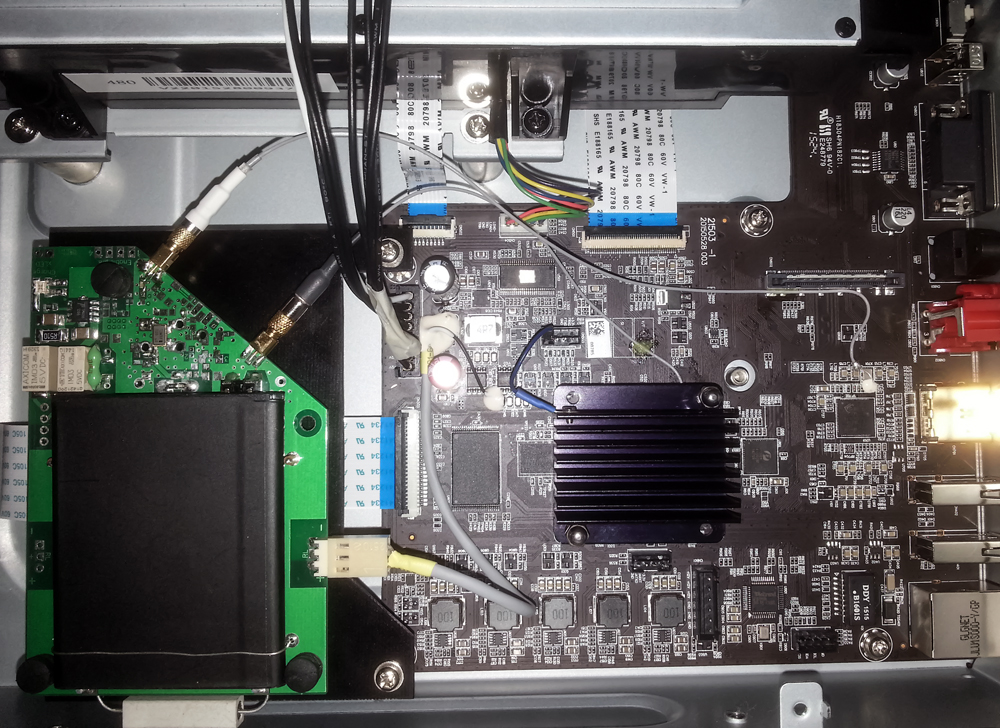

Here is my new LPM - 101 version, with added power module for audio board, and a improved device with installed this LPM installed, as some other mods in place (but not finished yet...)

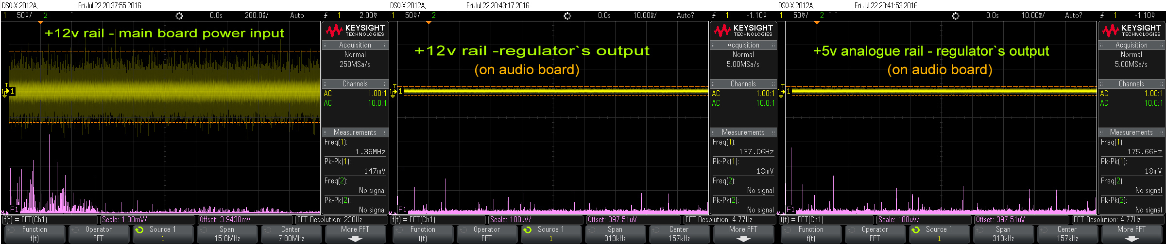

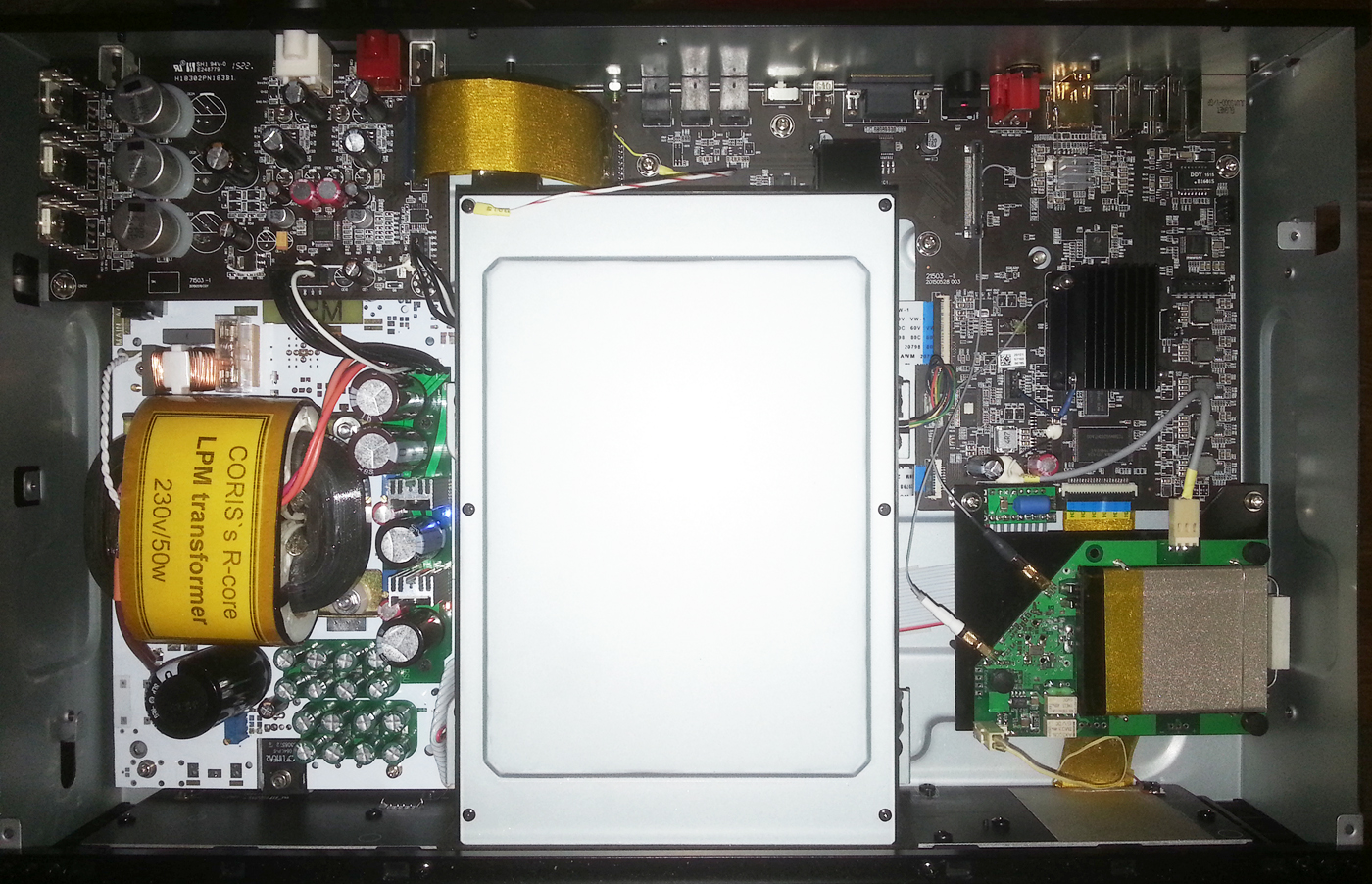

Here is the finalised, fully improved BDT-101...

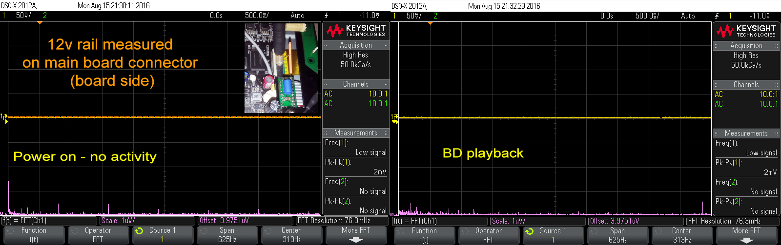

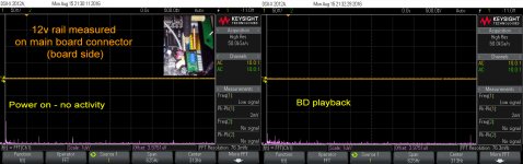

Also are some plots, showing the LPM`s rails, measured while device is functioning. Please compare it with the previous published here measurements on original device, powered by its SMPS.
Hi Coris
Somebody just sent me a BDT-101 to take a look and I am just right now looking at the mainboard and can see the xtal under/near the MT8563 main-chip. It is marked 0153T and E5614. But is clearly 27MHz since the Sil 9612 definitely uses 27MHz as per PDF datasheet and has the same numbers on it - strange there would be no "27" there. But the 9612 chips IS 27MHz. So that clears that up.
Hi Coris
Maybe you can save me a little time, if you have injected 27MHz clock signal into the MT chip, did you inject on pin 3 of the pad where the Xtal was, or pin 1 or 3? Would think pin 3?
Pins 2 & 4 are grounds, as per usual.
Also, did you remove any small SMD ceramic pF caps - like there is usually two, like on the Oppo 105 etc. I can see the usual two caps in close proximity to the Xtal. Hope you have a quick answer.
