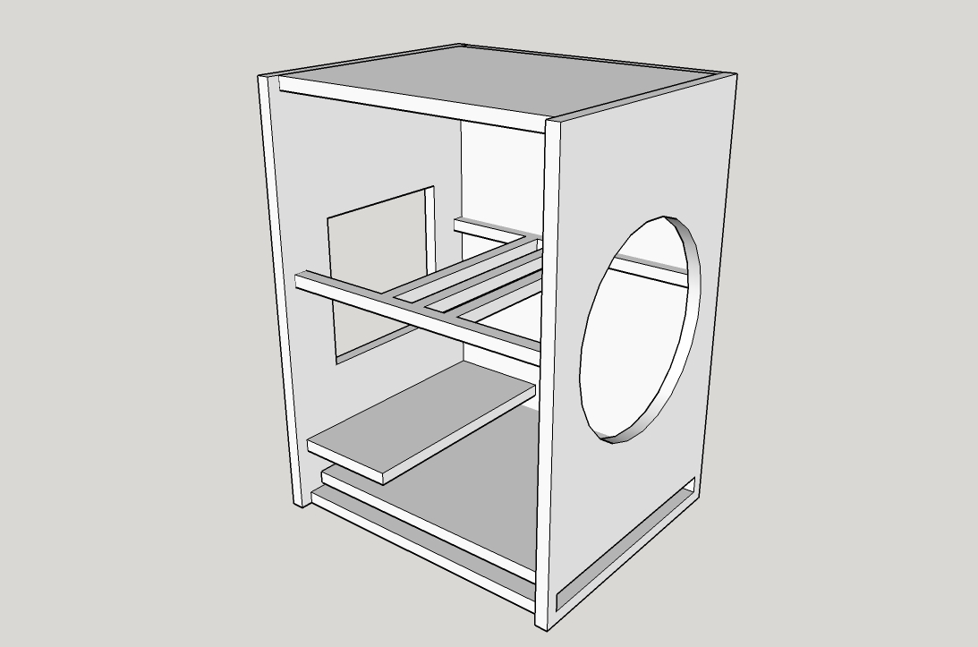

A very nice and helpful member of another audio forum has designed this for me:
It's a sub for home theater use that uses a 70-odd liter ported box (after displacement of driver and brace).
It uses a Infinity 1260W driver (which I haven't bought yet) and I have a BASH 300s amp on the way.
https://s31.postimg.org/bpe769oyz/1260w_sub.jpg
I'd appreciate your opinions on the design (performance wise, nevermind the colors. 🙂).

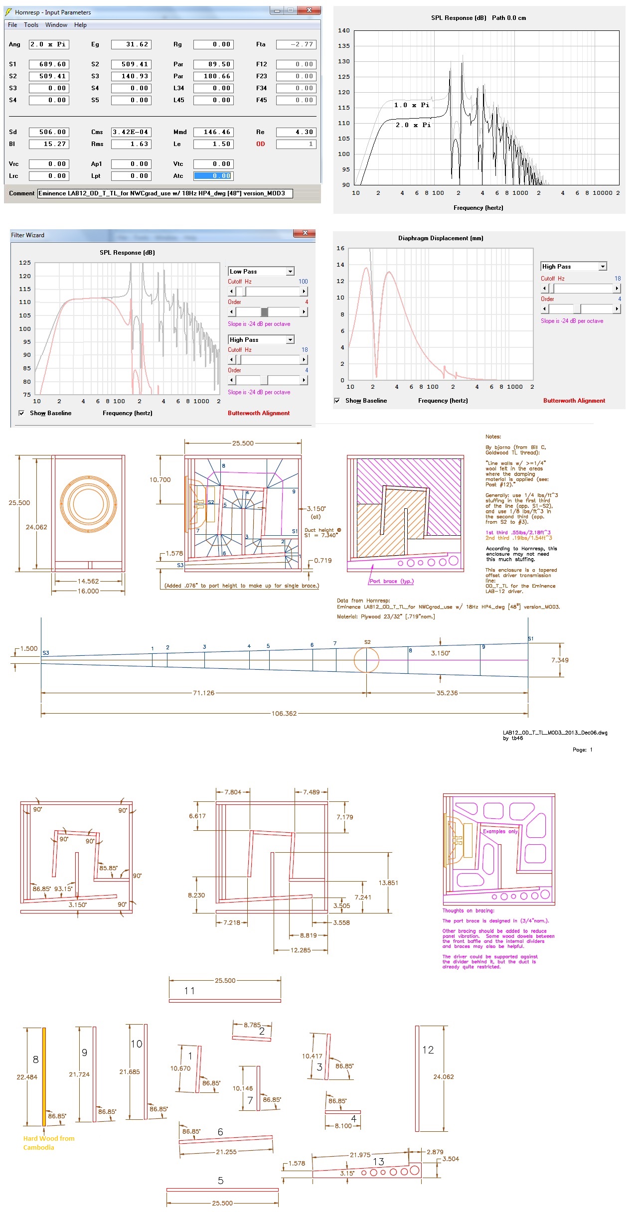

I have one in an offset driver tapped pipe designed by TB46 - have not felt well enough to put it to use much yet it intend to use to augment a couple of little speakers - there is no fill in the pipe - just some carpet felt. I think it might work in some bandpass boxes.
Triticum Audio has a more conventional offset t-line for a similar woofer (JBL gto1214) which may work well with a 1260W - there may be a plan for it within diyaudio (?) AH - check this thread, TheJessMan's comments and post 270 within the thread for the plans - there may be a hornresp model too
here's the plan and hornresp sim with a Lab12 - Jesse used the JBL which I think is similar to a 1260w http://www.diyaudio.com/forums/atta...tl-design-bj-tb46-od-t-tl-design-mod-3-sn.jpg

I'll quote the guy who designed it:
The slot vent is 2.5cm x 34.4cm x 58cm, which should result in a tuning of 23.5Hz if the net volume after displacement of the driver, amp, bracing, and the vent itself is 71L
If the rectangular opening on rear of enclosure is for plate amp, I'd recommend a sealed compartment for it. Even better would be to get the amp out of the sub box altogether, but that's not always convenient.
I want the plate amp on the back of the sub for convenience and practicality.
Did you mean I should make a compartment inside the enclosure for the amp only? An enclosure within an enclosure?
I'd prefer we get back to talk about that tuning frequency, is 23.5 not low enough?

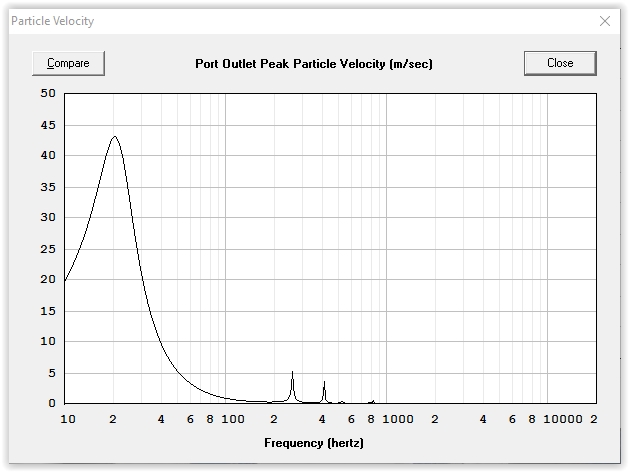

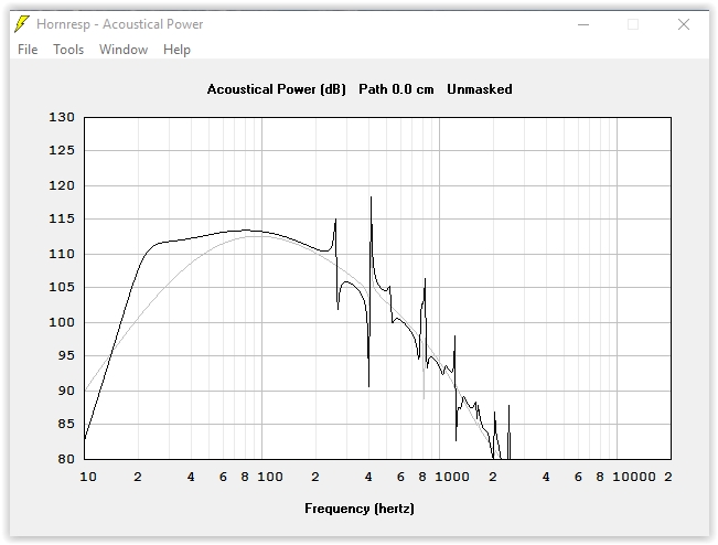

Hi YonathanZ,
I made a quick Hornresp simulation using your data:
Infinity 1260W / Port:W34.4cm x H2.5cm x L58cm (86cm^2) / V_net=71L / BR (bass reflex).
I'm attaching the Hornresp Export file, SPL (both vented and closed [set Ap to .01 for closed]) and port velocity graph.
At Xmax the port velocity looks too high. (Because of the long duct w/ a 90° corner it might just choke itself down to act more like a closed box at high volume levels, which may be a good thing.) A recommended maximum is in the 10 - 15 m/sec range.
AT normal listening level this may just not matter.

Hi YonathanZ,

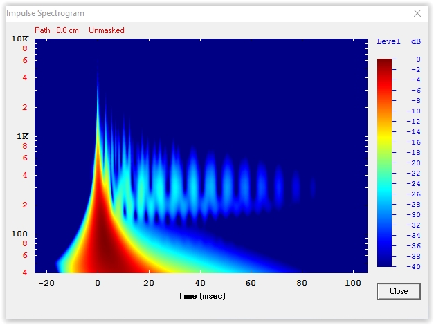

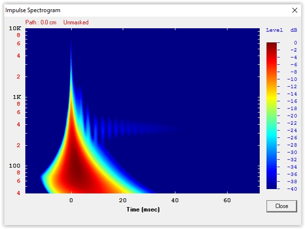

Hi YonathanZ,
Post #12: "What do you mean by "act more like a closed box"? What would the difference be between a "ported box sound" and a closed box one?"
That's what I get for trying to be descriptive: "...choke itself...". 🙂 Just trying to indicate that the port will not behave at high levels as in the simulated low level design simulation.
Google: port noise, bass reflex port velocity, and similar searches.
As to the second question: to my ears the closed box sounds tighter, but a little thinner than a bass-reflex box, and is my preference. But, that's an awfull generalization, isn't it?
There will be a strong port(duct) resonance in your design, usually people disregard it, as it might be out of the passband; but, it might still affect the crossover design. The BR needs a high-pass filter, you might get away without one in the CB (closed box). Look at frequency response (SPL), impulse response, group delay and phase in Hornresp, maybe that explains it. Even the loading to the driving amplifier is different, see: impedance curve.
Just stuff to think about. Your design is fine (could use a little more bracing), you can always fill the port with a foam plug, and see which way you like better.

Attached is the SketchUp file of the design. Again, wasn't made by me.
Thanks.

My rule of thumb for bracing is: no unsupported span of more than 8"-10"[20-25cm]. You can use side to side round or square dowels at random position, or more braces with holes cut into them.
