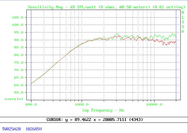

I attach a response file of my own because they dont seem to have any worthy information out yet.
Keep in mind that Morels rise on baffles too as many other tweeters do. The A20 titanium does not sound harsh though. I dont like much HF too. I prefer the A26 cloth in some occasions.

Thanks for posting the freq plot salas, did you measure it yourself, or have you got some inside contacts at Audax 🙂 I looked on their e44 site and as you said no info on the A26 at all. It's response curve looks pretty peaky??

The file A20 response file is my own.
Just measure any loudspeaker with enough sampling res and you will see the truth...Its always full of fine peaks and throughs.
The ones you see on specs are smoothed over.
In the older days they used to run paper slower on the plotter, now they use less sampling resolution.
Those graphs you see show in the end what the ear homogenizes any way. Not a real cheat but pleasing to the eye too!
If you end up in a Morel my suggestion is the 30.
The law of diminishing returns kicks in heavily with the 33.
Its main plus is the sensitivity but you say its worthless in your scheme of things.
As for the new Audaxes vs (very old designed & Dynaudio copied)Morels I am personally convinced that the Audaxes as well as some Focals win hands down because I have done head to head comparisons in my own stuff.

Below is my Morel MDT39 on a tiny 6" x 8" baffle, measured a bit off axis. Below that is how it combines with the midrange I'm using...after optimizing the xover. Ignore anything below 500hz.
Sorry for the huge gif.
