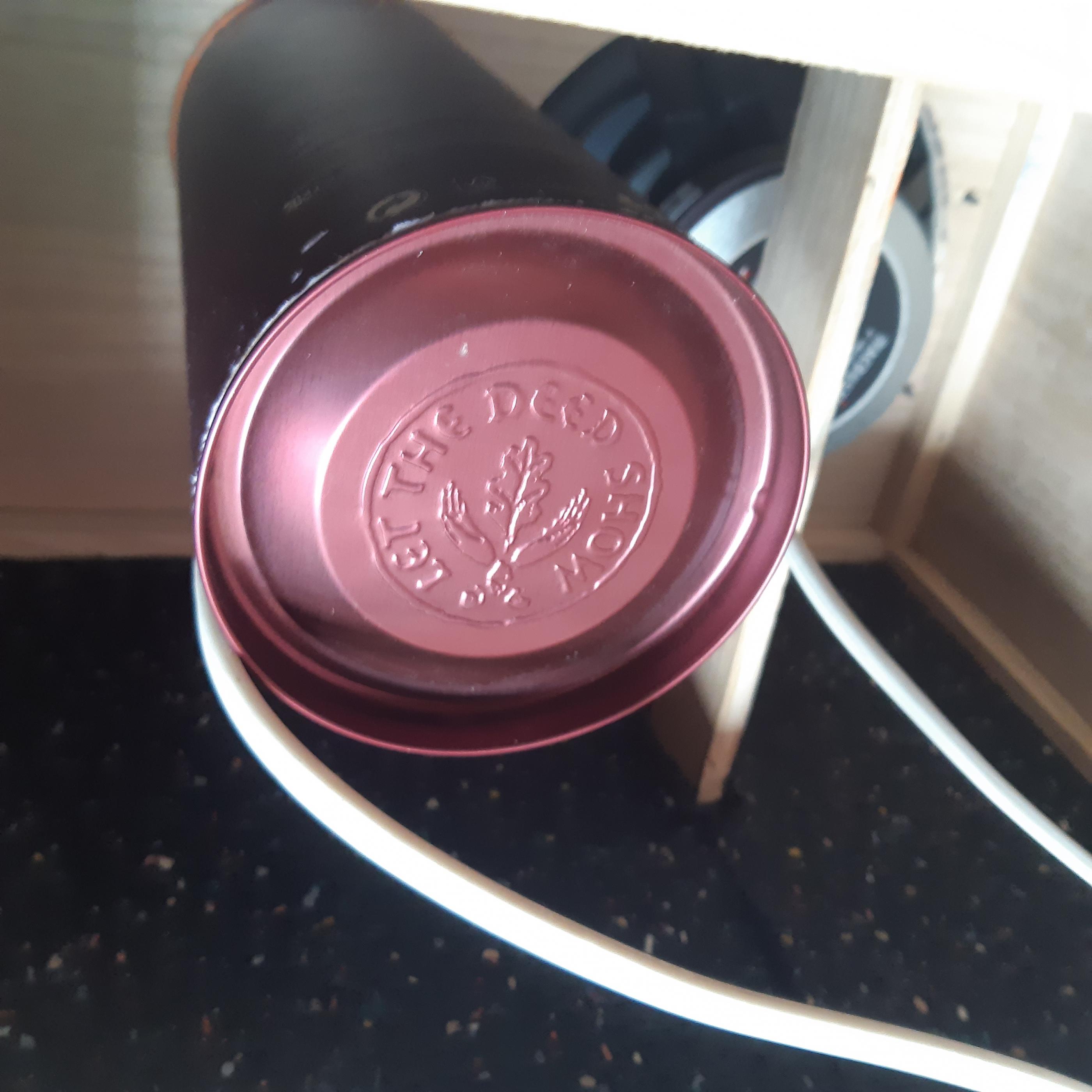

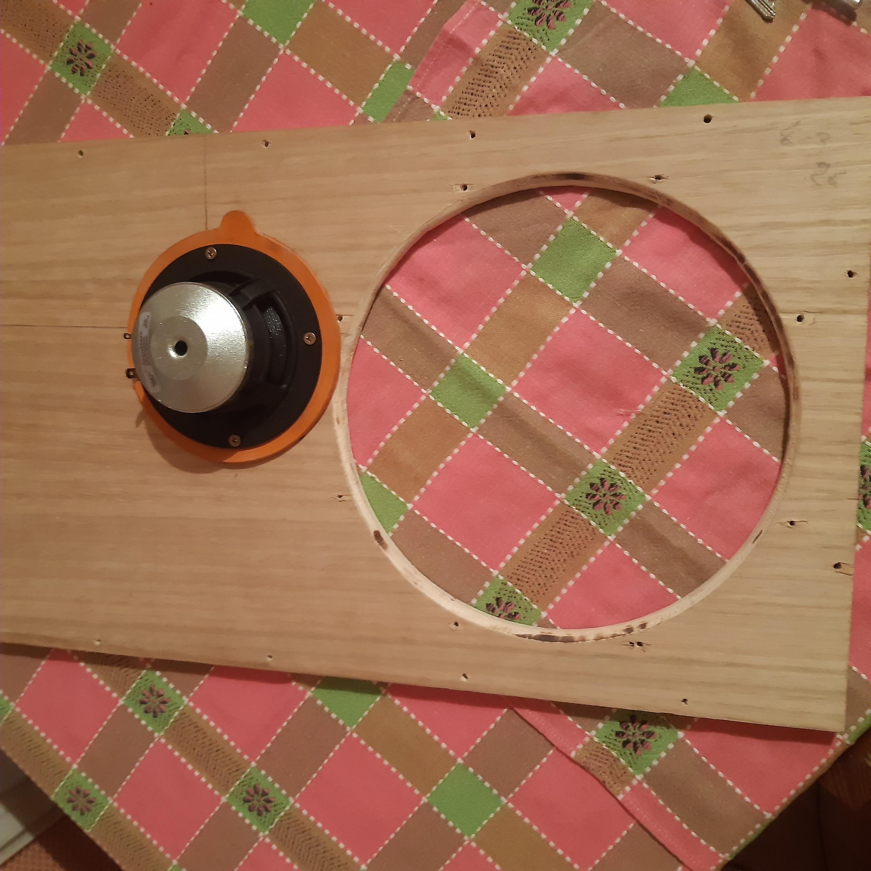

Many thanks guys for all the ref and advices in the low budget allowed. First diy loudspeaker, casual project, little 3 ways classic I hope to share if good enough. But the 10F I hope to stay cheap.
things are going slowly for many reasons, I'm on this for 6 months. Some photographs though, it's made to change easily of front baffle, so make à la Harbeth and as a first diy will be called : the "Hard bet"
