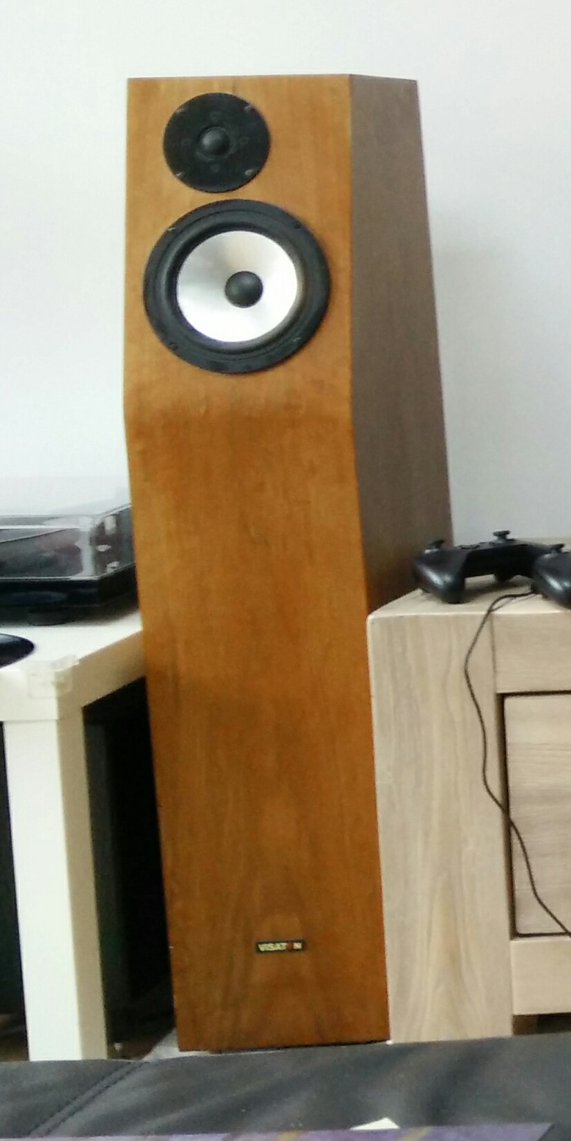

Does anyone have experience with visaton speaker kits?
How good/bad are they?
Maybe I want to build one because I can easily buy them here.
Reason being: I recently bought an unknown set in a second hand store ( pic included) and I kind of like the sound of them. After I do the visaton I would do a zapf zrt... I'm a bit 'scared' of the crossover 'cause I'm a total Electronics noob and with the visaton kits they are pre-build.

I believe you do the cabinet yourself. The aluminium drivers have a particularly high reputation.
I think I have found your one, VIB 170 AL:
http://www.visaton.com/en/bauvorschlaege/2_wege/vib170_al/index.html
Where it gets fun, is you can find the projekte file, download it to the projekte folder of Boxsim and start to model it yourself in 5 minutes flat.

Hey, i can promise you that they don`t need any changes in general. Visaton is a good brand with well engineered speakers and kits.

Do I understand correctly that the scanspeak drivers of the zrt fit my cab and crossover? The current one is a 170al and a g20sc. What amazes me about these speakers ( and everybody else who listens to them) is the bass. I've had friends over looking the sub...
Would the zapf be a major upgrade?

a)Do I understand correctly that the scanspeak
b)Would the zapf be a major upgrade?
a)The drivers may fit but you'd need the ZRT x/o.
b)TBH looking at the current placement I doubt it.
