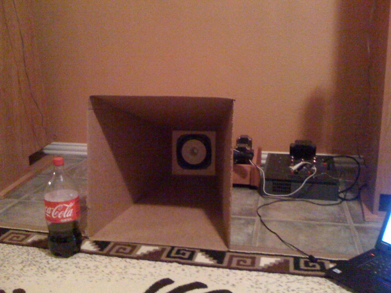

Judging by some crude cardboard experiments I tried (crude is a understatement), it was the most natural of the drivers I tried (PR 17OMO, Tangband W8-1772, Fostex FE-166E), though obviously limited in top end extension.

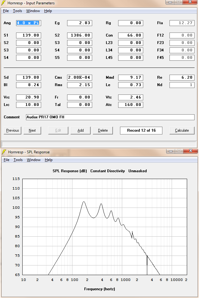

What's wrong with my sim?
From first principles:
Let's assume a Fc = 250 Hz conical
for 4 pi loading, (free space),
speed of sound = 340 m/s
wavelength at cutoff , w = c / Fc = 1.36 m = perimeter of horn mouth
Radius of mouth rm= w / (2 * pi ) = 0.21 m
Therefore, mouth area Am = pi * rm^2 = 0.1386 m2
Assuming Horn length Hl= w/2, Hl = 0.68 m
Substituting these into horn resp, and using a throat aread = Sd, I get awful results, even after tweaking things around. The sim shown has a throat chamber, but there's little difference with / without it.
What gives ?
Driver specs:
Impedance 8 ohm
Resonance 117Hz
Power 100W
Sensitivity 100dB
Re 6.2 ohm
Le 0.73mH
BL 8.24
X-max 0.5mm
Cms 0.2 mm/N
Qms 3.16
Qes 0.61
Qts 0.51
Mms 9.17g
Sd 139 cm2
Vas 5.52 liters
Magnet weight 31 oz
Speaker weight 5.5 lbs

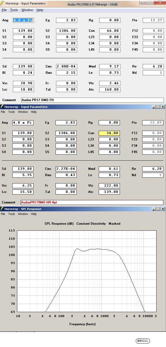

0.5mm xmax isnt much at 200hz, considering its only a 6"
well, maybe ok at normal SPL
might work better with 500hz xo

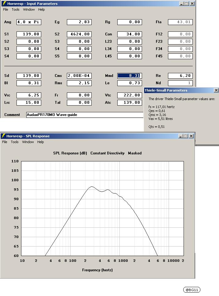

I've read somewhere that this driver is not very suitable for horn loaded. It seems it likes big mouth. About half an hour of fiddling:

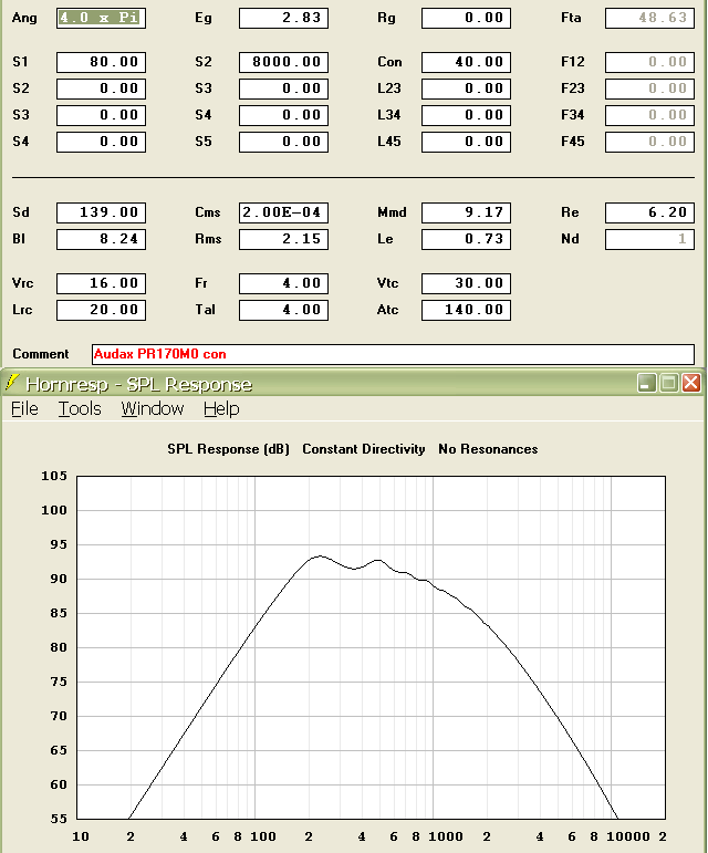

Hi, Took 30 seconds of fiddling by making the (wave-guide) horn length to ~w/4...I suggest to XO at ~400Hz...
b🙂
Yes, .but in reality, .. you achieved that mainly by whittling down the cone mass to nothing. Not practical 🙂Hi, Took 30 seconds of fiddling by making the (wave-guide) horn length to ~w/4...I suggest to XO at ~400Hz...
b🙂
Yes, I arrived at the same results earlier this week using a large mouth. With that aspect ratio, I'd guess the main benefit would be a a little directivity benefit. It's almost like a shallow waveguide / OB hybrid.I've read somewhere that this driver is not very suitable for horn loaded. It seems it likes big mouth. About half an hour of fiddling:
😱 I need to add more clay...😀
b🙂
No free lunch anyway.
In reality, such big throat horn with a cone driver would deliver more higher end of frequency range than the sim we're playing here. Drivers with rising FR help a lot.

... Yes, I arrived at the same results earlier this week using a large mouth. With that aspect ratio, I'd guess the main benefit would be a a little directivity benefit. It's almost like a shallow waveguide / OB hybrid.
picowallspeaker said:... And the sound being very 'midrangy' and warm ....
If a driver sounds 'midrangy' and warm, I guess it will be overly warm by an "ordinary" front horn, because the horn would enhance the lower portion of the working band.
So it seems, this driver inevitably needs a shallow/large mouth WG type of thing, if you insist building a horn around it and/or without severe EQ afterwards.
