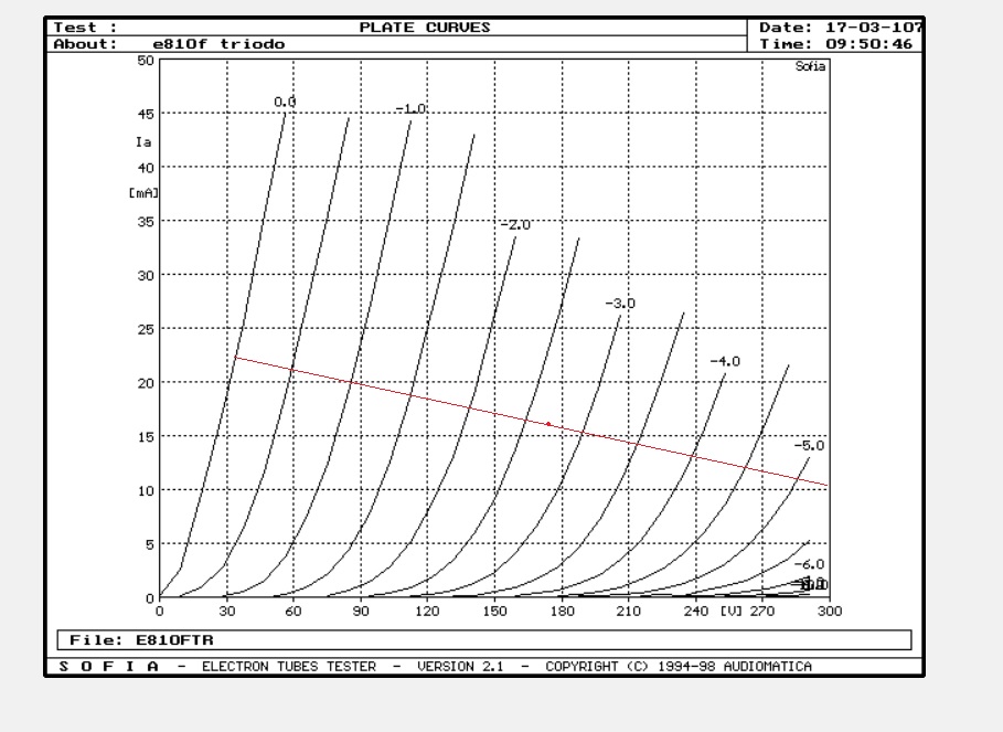

Operation point for E180F tube

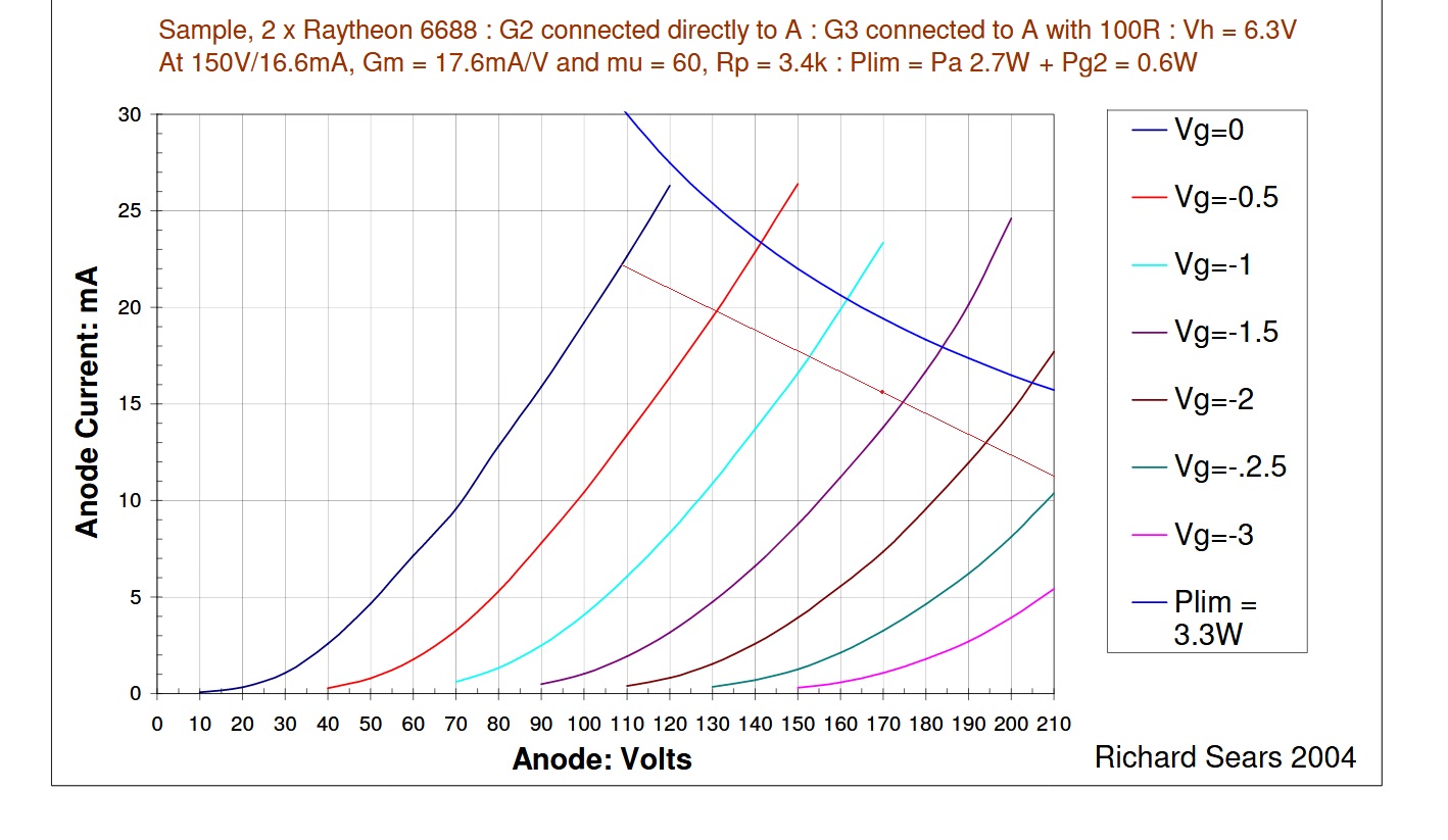

Sure. Here's a 9K load line with the tube triode strapped with G2/G3 tied to plate. The other image is of the same operating point with G3 tied to cathode and G2 tied to plate (more conventional) and a 23K load.
(I'd rather use the more conventional arrangement with the 23K load)
You probably don't quite have the voltage to make all that work properly, but you can always redraw the load line for the voltage you do have available, or consider using a plate choke or CCS to make the available B+ much less important.

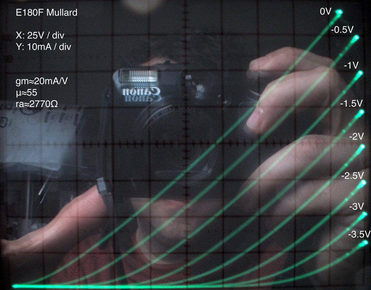

My recommendation based on experience with Mullard and Siemens E180F is: Uak about 170 V and Ik about 11-12 mA, no more.
CCS and LED bias are desirable.
