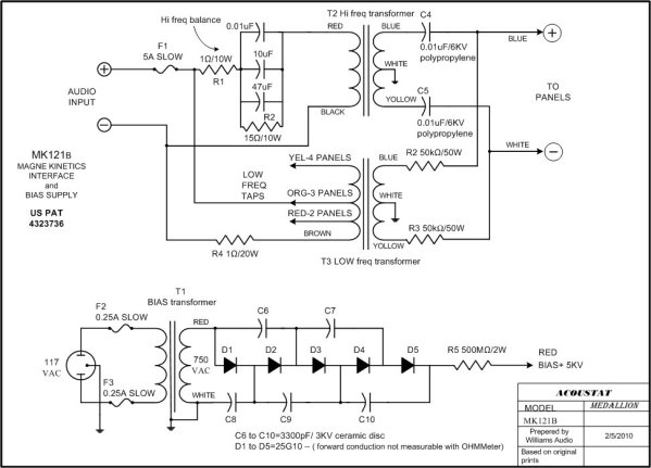

john the 2 panels setup on the 121 has the most bass........i see the setup like a 4ohm tap on a tube amp output tranx secdariy....3 panels= 8ohm....4panels =16ohms....
So if you just move the tap... see pic.... on the 121 bass....to 3 or 4.... is like moving a crossover point.....like 3 would be 40=60hz....4 would be like 100hz.....

Yes, I see that on the schematic - 2 panels should give more bass than other two settings. I forgot the schematic. I will have to try tonight.

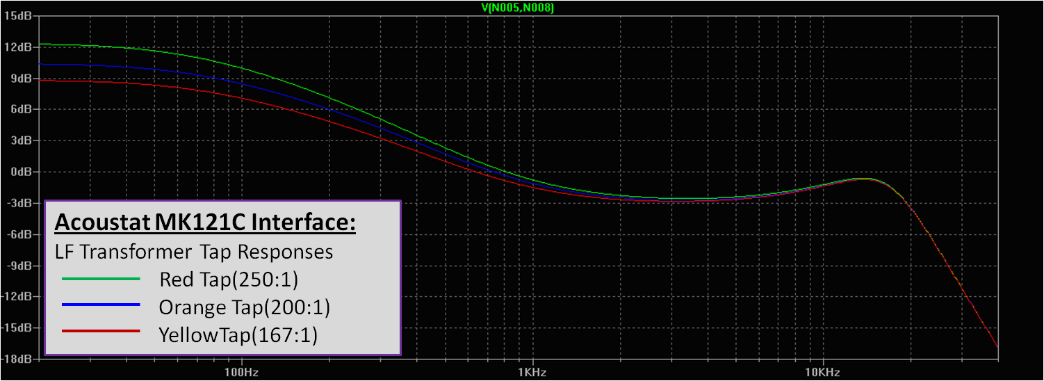

Anytime you chose a tap on the primary that lowers the amount of its turns, It does several things.
The First effect of course is that raises the transformation ratio so you will get more sensitivity depending on the increased ratio.
Second, This also raises the frequency for the point of core saturation for a given input voltage.
Third and foremost effect is that it also lowers the primary winding's inductance value and this respectively lowers the impedance to the amplifier for the lowest frequency's due to the lower inductance value.
This can (for some amplifiers) cause the amplifier to not be able to swing as high as of a voltage that it normally would at say 4 or 8 or even especially at 16 ohms of operation and can/will cause it to distort due to the lowered impedance if it can't supply enough current to maintain the voltage swing that it is being demanded for it to produce.
This can, in some cases, actually drop the sensitivity that you thought you were gaining by using the higher transformation ratio tap on the step-up transformer.
Now, I don't know exactly what the characteristics, specs and values of the Acoustat transformers windings are, But these actions are true for any particular transformer.
I have also found that for the High frequency side of Crossovers for ESL's, It is the transformers primary (Hence inductance) impedance at the crossover frequency in conjunction with the capacitor that creates the action of the high pass filter and its crossover frequency point.
This dawned on me one day while I was trying to simulate some ESL crossover designs in Spice.

OK, I tried the 4 panel and sounds even better - cleaner. Bass is a bit more subdued but still much better than the stock ML interface.

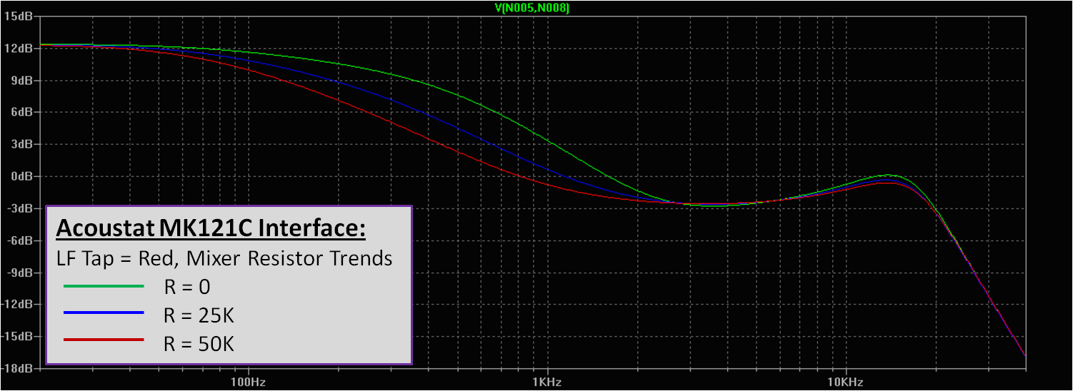

So the NeXt step is to get the 50k Res. OUT of the Bass tranx on the board...
That may work great with the CLS panels.....just move the blu an yelo from the bass tranx wires to the front of the .1 caps on the board....that way the 50k are there if you dont like you can go right back to the stock setup.....just move the wires back
I have done this for a long time....The 50Ks are EQing an Delaying the Sound....
I like this mods sound....an so do The SoundLab owners i have over time to time...as you may know SL dose NOT use Any Res. on the bass tranx secdary side at all ....

As geraldfryjr mentioned, selecting different primary turns changes the step-up ratio.
In the case of the MK121C LF transformer:
Red tap = 250:1
Orange tap = 200:1
Yellow tap = 167:1
This changes the level of the bass relative to the mids and highs. The step-up ratio of the mids and highs remains fixed at the 60:1 of the HF transformer. The mixer resistors(50K) and capacitors(0.01uF) define the frequency at which the transition is made between the HF transformer and the LF transformer.
Attachment #1: Here is a trend plot showing the electrical response of the MK121C interface for the 3 different primary taps. As you can see, the interface provides a nice smooth boost below 1kHz which is exactly what is needed to equalize out the acoustic roll off from dipole cancellation.
Attachment #2: Here is a trend plot showing the electrical response of the MK121C interface for 3 different mixer resistor values(50K = standard). Notice the bass boost level remains the same, just the frequency at which the transition occurs moves. If you reduce or remove the mixer resistors the boost starts at a higher frequency and you will probably wind up with a mild rise in the midrange...which may or may not be to your liking.
Concerning the Sound Lab Interface:
It may appear that the Sound Lab interface does not have any mixer resistors. However, this isn't exactly the case. If you measure the resistance of the primary winding, you will find it a surprisingly high 3 to 8 ohm depending on the primary tap chosen. If you reflect the 3 ohm resistance thru the 1:200 step-up ratio of this tap on the transformer you will find it is electrically equivalent to using 60K mixer resistors with a low resistance primary(ie almost exactly like the Acoustat). The only difference is that they didn't have to use big power resistors on the secondary side.
The take away point is that running a Sound Lab interface without mixer resistors is electrically more similar to running and Acoustat MK121 interface WITH the 50K mixer resistors than without.
Red tap = 250:1
Orange tap = 200:1
Yellow tap = 167:1

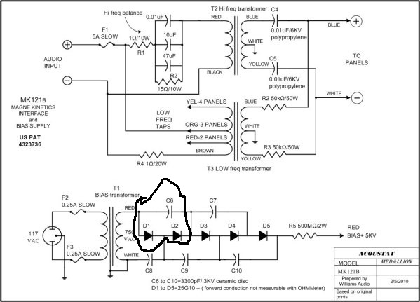

Question....I needed to drop the bias voltage a bit on my new CLS panels. I pulled the two diodes and single cap as shown in pic. I chose pulling the front cap/diodes instead of the back by the bias resistor.
The bias appears more like 3,1kv now instead of 5kv. But for some reason interface (bias tranny) is noisier than before pulling the diodes/cap (hum / buzz). I left that first lower cap in, so effectively that first cap value is half the value with a series cap in front. I didn't think it would be a problem...Should I correct it and pull that first cap and tie back into the secondary/ground connection? Any other reason it would buzz with bias reduction?
It would have been easier to just move the Feedpoint of R5 down to the junction of D3 & D4.
Else you also have to short and/or remove C8 as well in order to create a ground connection.
With C8 in there you are essentially modulating the the supply with 60 cycles through C8.
If you want to use a tap that as only one diode down for approx. 4Kv then you have to move the connected ground to the other side of the stack of the multiplier capacitors or else you will get hum as well.
The ground must be taken from the bottom of the same stack of capacitors that the Bias HV is connected to or else you will get hum.

Question....I needed to drop the bias voltage a bit on my new CLS panels. I pulled the two diodes and single cap as shown in pic. I chose pulling the front cap/diodes instead of the back by the bias resistor....I left that first lower cap in, so effectively that first cap value is half the value with a series cap in front. I didn't think it would be a problem...
You didn't mention it, but did you replace C6 with a jumper? (ie so the junction of C7 & D3 are connected to the HV transformer)
I agree, I would not think effectively reducing the first cap value by half should be a problem. Unless of course there is considerable leakage current. Do you have your neon bulb charge indicators hooked up? If so, what is their flash rate.
Also, is the hum/buzz there even when no amplifier is hooked up?
BTW, the schematic you posted has an error, R2(15ohm) should be across the transformer primary rather than across the capacitors.
More details on this starting in post#14 thru #19 here:

"I left that first lower cap in, so effectively that first cap value is half the value with a series cap in front."
Oops , Some how I missed this part sorry for the confusion!!! 😉
I don't think that this would be a problem either unless there is excessive leakage as mentioned.
Some how I had it pictured in my mind that both ends of the multiplier was fed through capacitors.
