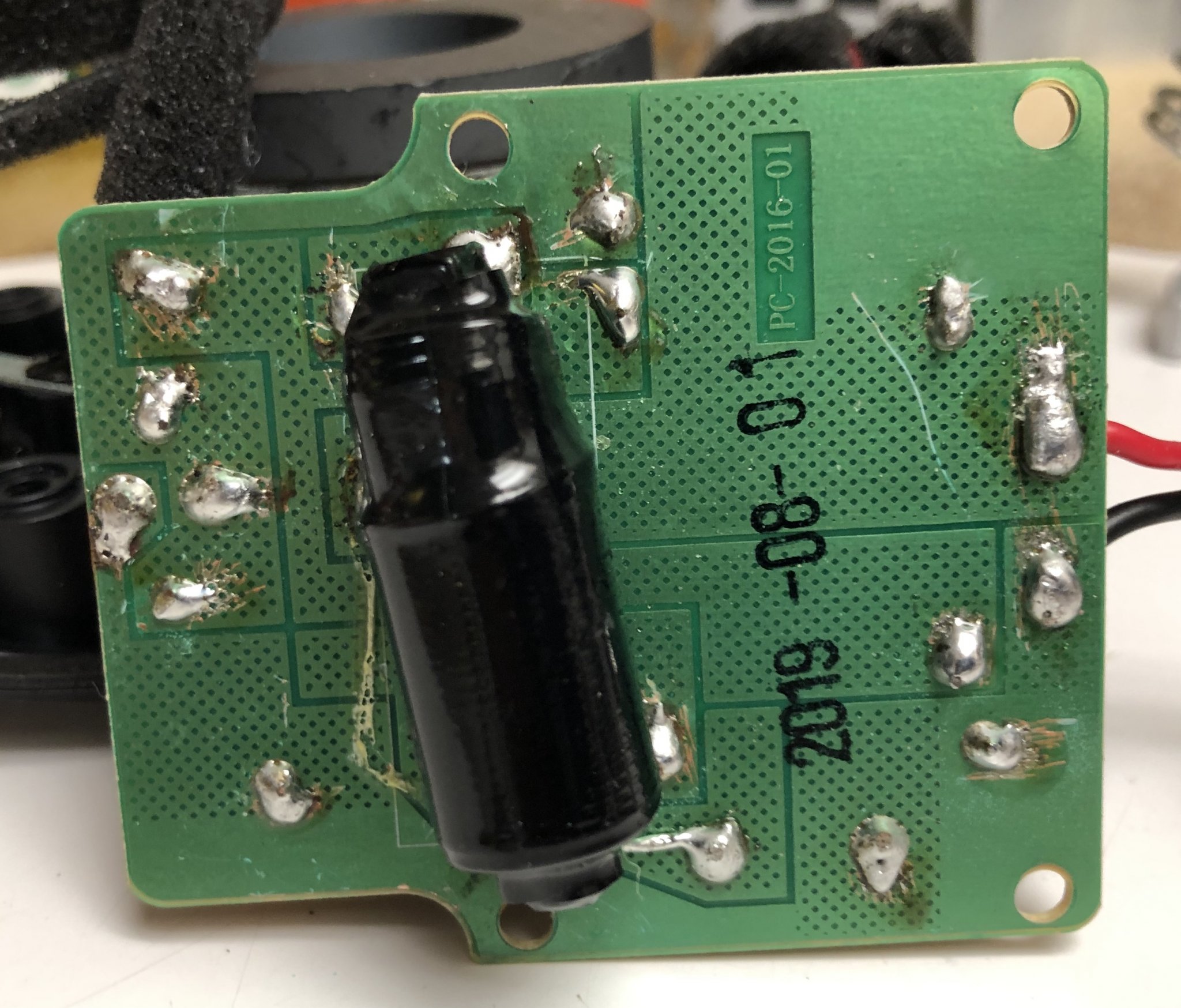

I have the tiny polk blackstone satellite speaker. It measures open at the speaker terminals instead of 4-5ohms.
I scraped the pcb and resoldered each joint. If I do continuity from point to point, it makes connection except at the speaker terminals.
Both the tweeter and the woofer are good.
There are 3 caps, 3.3uf, 18uf, 300uf. If faulty, would it show open at the speaker terminals(amp side)?

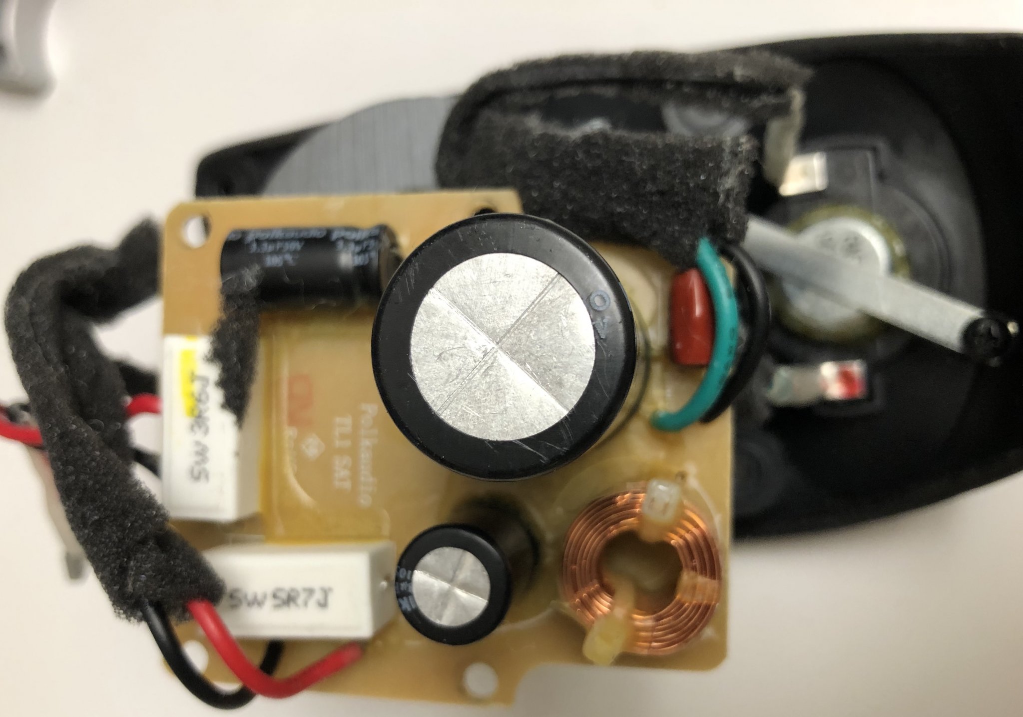

Maybe that large cap is open circuit. Measure the input resistance of the crossover, while shorting that cap's terminals.
While ohm meter is on crossover input, I shorted the 300uf cap, it measured 4 ohm. Heard a popping noise out of the speaker.
I unsoldered the 300uf cap, it seems to measure resistance building up, like the cap is charging, not sure if these means the cap is still good.
I have only a 1000uF polarized cap here. I touched it on the 300uF non polar pcb pads, it made popping noise out of the speaker but still
no 4ohm at the cross over input.

The 300µF capacitor in series with the woofer is a high pass filter to prevent over-excursion of the cone from too much deep bass, which would otherwise destroy the tiny woofer. For a nominal 4Ω driver the crossover frequency will be ~130 Hz. This capacitor blocks DC so a multimeter measuring ohms will read open circuit, and that is normal and what you expect to read.
L1 is the low pass crossover element forming a nominal 1st order slope of -6dB per octave above the crossover. The 18µF in series with 5.7Ω resistor shunts the rising impedance of the bass driver voice coil self inductance to correct the bass driver's rise in impedance as frequency rises which would otherwise prevent L1 from achieving the desired low frequency rolloff to the bass driver.
The 3.3µF capacitor is the first section high pass element for the tweeter, and L2 is the second section high pass element, making it a nominal second order (12dB per octave) slope, and the 3.6Ω resistor attenuates the tweeter level to match the bass driver.

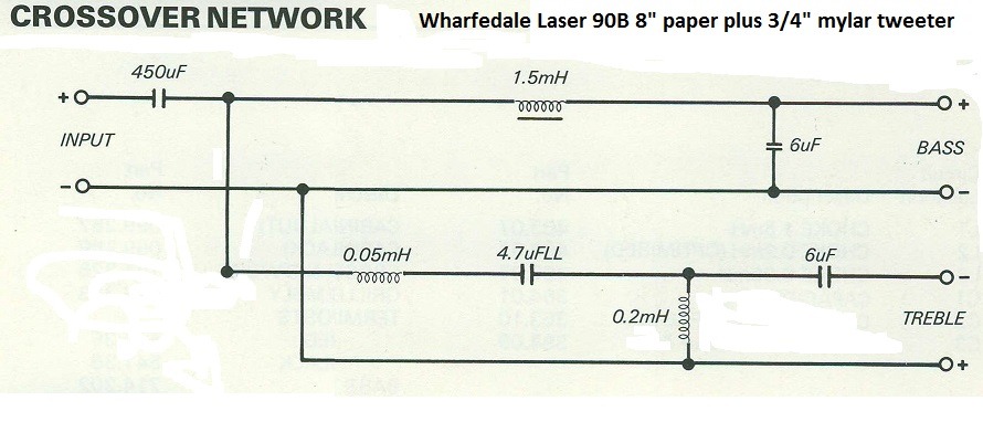

Bear in mind that this crossover uses a series capacitor on both the woofer and tweeter,
so there will be no continuity across the speaker system input terminals.
Are you getting sound out of the drivers? If so, probably the crossover is ok.
A few special speaker designs (KEF, etc.) do have a series capacitor on the woofer.
In this case the driver is really a midrange unit anyway, and does need one for that reason.
