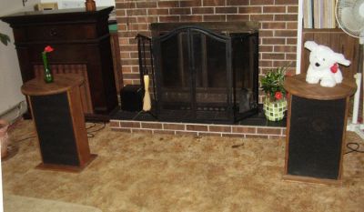

Actually I think it might work for you. My room is about 12' square which I guess works out to around 4m or so. I am sort of kludge bi-amping a 5.25" full range driver and a 10" high Q...
http://www.parts-express.com/pe/showdetl.cfm?Partnumber=290-325
in a smallish baffle. The side panels are 1x6s which are about 5.75" in actual depth but they are biased forward to be even with the grill cloth so the sides are only about 4". The baffle width is about 13" if I remember correctly.
I use a homemade subwoofer to supplement the low end below about 60Hz but I had it disconnected the other day and they did pretty well on most music as is. Using a sub really makes it shine though. What I wanted to do bass wise was to be sure that the mains would cover the tympani which they do just fine and really cover most of the string bass quite well also.
I made the mains in the form of knick knack tables so they can be a couple of feet into the room without being intrusive. The wall behind the speakers is rather "busy" so the rear wave is nicely dispersed. The imaging and sense of presence of these things is incredible given that they are the cheapest speakers I have owned but the best sounding at the same time.
