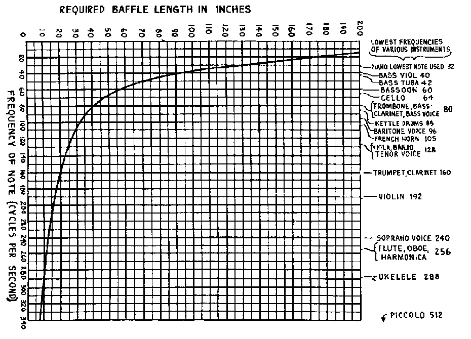

open baffle plan for FE206E
Well, now, a bit more detail might be nice:
- for a 250 hz cut-off, make it 12" square (see attached graph).
- cut the appropriately sized hole in it and mount the 206.
Kofi Annan said:
How low can an OB design go for the 206E and how big would the OB B?
I B C N U L8R, G!
Kofi
I really don't know, but you raise a good point. Due to it's quite low Q, the 206E may not go all that low in an OB. I would think that 250 Hz would be possible, but I'm really guessing.
Given this, my earlier statement of 12 inches is probably way too small. But then, I wasn't being all that serious anyway...
I wonder if the crossover shown in the Basszilla link raises the Q.
