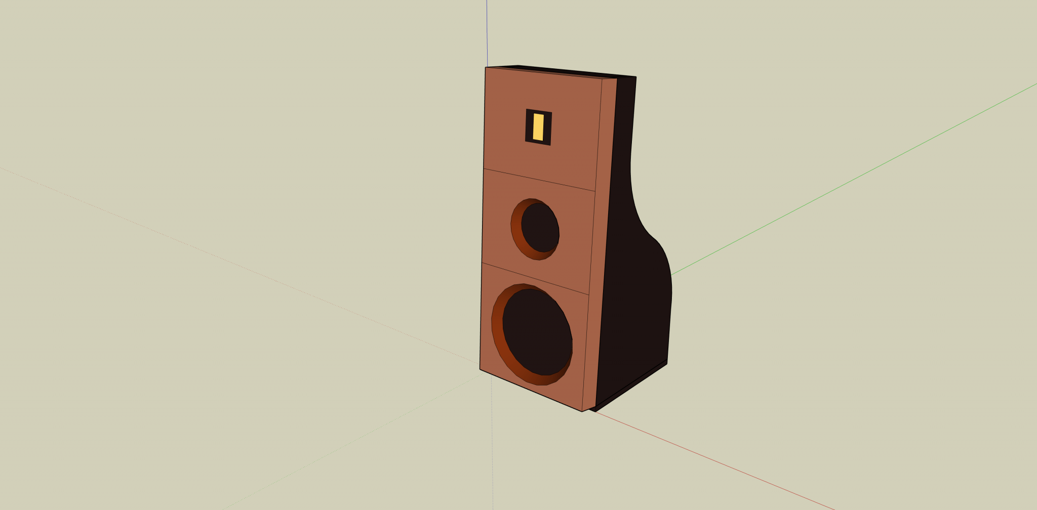

as a followup to my othe thread (New diy open baffle project: 3-way with AMT) starting my open baffle project I am a bit further now in decision making:
Tweeter: AMT23D6.1-R (88dB, 8Omhs) is already ordered
Mid woofer: Audiotechnology C-Quenze 18 H 52 06 13 SDKA – last perhaps in a version with the J-magnet instead 90dB
I am now looking for a matching subwoofer, xo is planned around 200 Hz. I am thinking of one of the following:
I would prefer the 12" drivers as I awant to build a rather slim baffle but with side wings (U-frame). I tried to chosse drivers with higher sensitivity to compensate for the baffle loss for low frequencies. Are there reasosn one of them would not match well with the above mid/high drivers?
Another question:
Is there a way to simulate U-frame baffles? I wand to make them triangular shaped, is there a way to simulate this as well? Can I use Basta! for this?
Is the response the same when I "flip" the wings to the front as Basta! can only simulate flat baffles as far as I know....

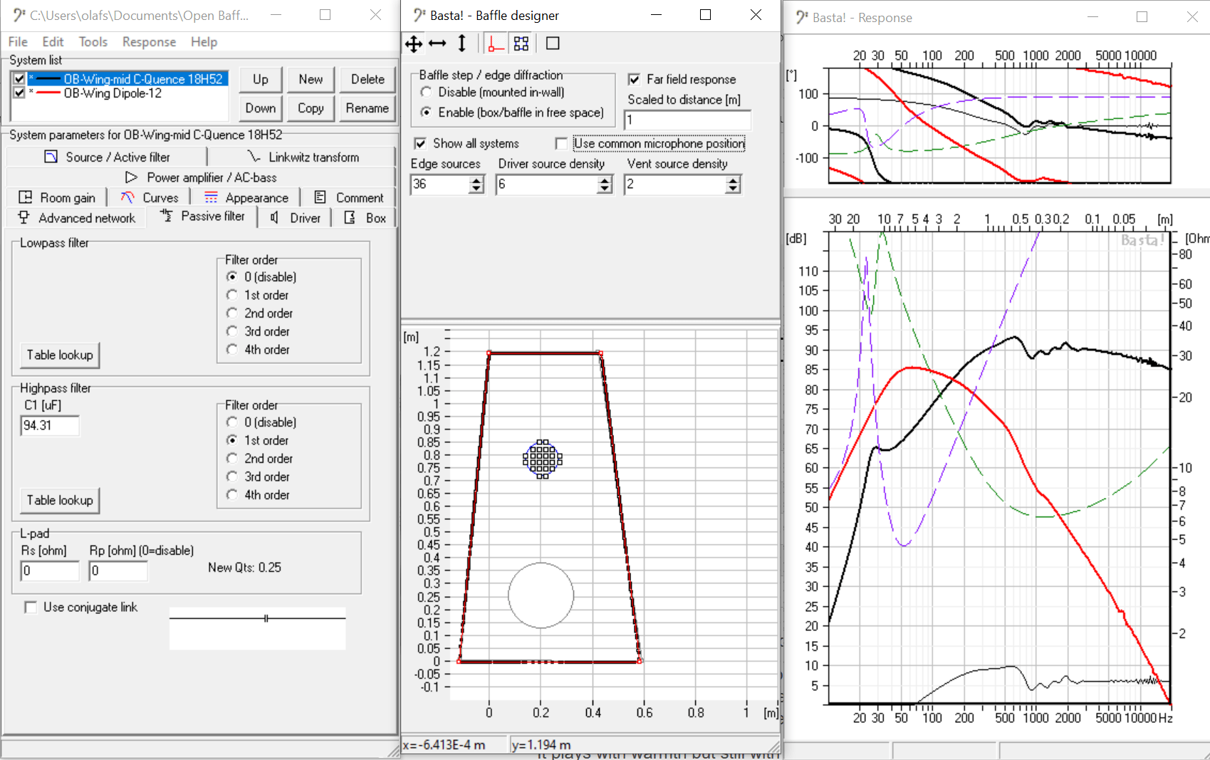

so I have tried to model now the "lower" part of the system with basta!. For the AMT I did not find any S/T parameters.
I guess due to the AMT principle these might not apply anyhow. Any ideas how to model the AMT?
So here is my model: Trapezoid shape is supposed to simulate a U-frame with triangular sides, I hope one can do it this way.
Mid-woofer is the AT C-Quenze 18H52 driver, subwoofer: AE Dipole12. Any commenst or suggesntions?

So I learnt a bit more on how to do the modeling with basta. Here ist now my last design that makes me confident to go for the AE Dipole12. Crossovers are now all 1st order as I read somewhere that these are the "purest" in terms of phase delays.
My question: Is it "valid" to crossover between subwoofer and midwoofer at different frequencies? Or does this cause problems?
Here I use a xo frequency of 250 Hz for the subwoofer, but 900 Hz for the midwoofer to "cover up" the baffle resonance between 200 and 800. I tried to maintain a sensitivity of about 88dB as this would match with the AMT above 2400 Hz which is not included in this graph.

One question regarding U-frame: I am wondering if I need to simulate that differently. When I "flip" the sings over, do I deen to make them twise as wide because the travel distance is not d*2 (d being the wing depth but only d (assuming the listener position is far enough away?

2 dimensional simulation like Edge or Basta had very low precision in OB simulation. OB by sound radiation meaning is 3D structure and you need some other type of simulation, somthing like AKABAK what use BEM (Boundary Element Method) and is able to simulate full OB 3D srturcture and it radiation.One question regarding U-frame: I am wondering if I need to simulate that differently.

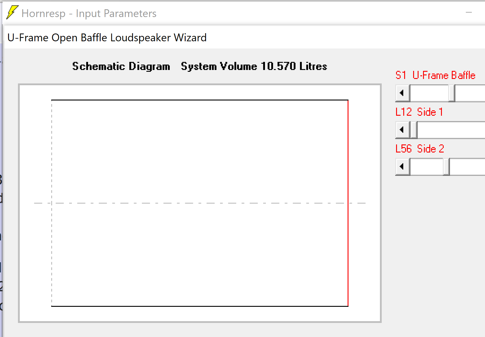

Your mixed use of terms might cause confusion. Are you making a frame or a folded baffle? A frame has four sides, so a U-frame has two side walls plus a top and a bottom. Looks like you are doing a folded baffle?
Hornresp allows sim's for unfloded baffles and U-frame designs with the driver of your choice. It only seems to allow a floor plan sim, as if looking down and changing x and y but not z aspects. Thats understandable when you consider a U-frame needs a lid.
A U-frame is enclosed like a tunnel. It has roof. The roof is needed to stop dipole cancellation. If you are not using a roof you are not making a U-frame. You are making a folded baffle only. The baffle will have less resonance but much more dipole cancellation with the waves taking the path of least resistance and cancelling over the top.
If you want to see how a U-frame extends the low frequency wuth resonance costs vs a baffle, you can do that with hornresp and your selected driver.
Hornresp also allows modelling of a driver in a plain baffle with SPL and Xmax. It will allow you to sim at what power and frequency you exceed Xmax or run risk of damage. Woofers in OB can easily bottom out at low freq and higher power.
The AE dipole series is hard to beat for performance in OB being designed specifically for OB with quality and performance prioritised over cost.
Hornresp comes with a Help file for instructions but I just play around with options with the mouse e.g.

Thanks, I will have a look at hornresp. I actually planned a "roof" for the U-frame but I am not sure hom much that will make a difference. As far as I know, the dipole effect is most pronounced for low frequencies. For that reason I plan to have wider "side-wings" on the bottom where the subwoofer is placed.

You can model the influence that a wider baffle side wing deign will have on low frequency extension using Basta. That might help you with your prototypes. It may be if you are using sloping side baffles that increases depth doesn't make too much change. The cancellation may be dominated by the path of least resistance eg over the top of the front baffle?????
