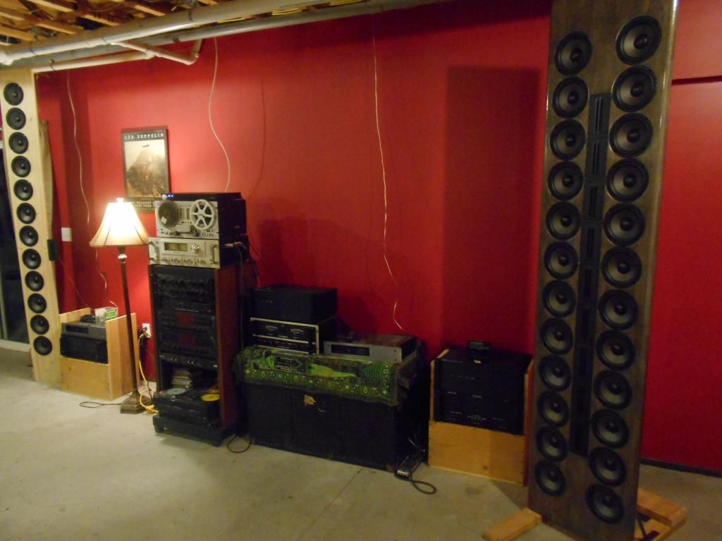

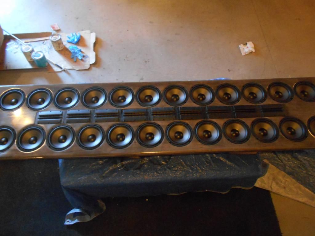

Here's a couple pics of where I'm at with the build so far with basically only the bases remaining.

The Vertical center to center spacing of the 6.5" drivers should be no more than 1 wavelength at the X-over freq, and or, no more than a diameter of the driver. Speed of sound/6.5" = 2084Hz. It will be also mentioned that if those mids are side by side ctc more than a 1/2 wavelength they will be excessively lobing. Some will say 1/4 wavelength 😀
Yeah, with the 6 1/2" drivers I've introduced combing and lobing at the frequencies I'm crossing them at. Should sound bad but in the real world it doesn't I don't hear any of it on the prototypes. And with adding a second row for MTM the lobing will at least be symmetrical.

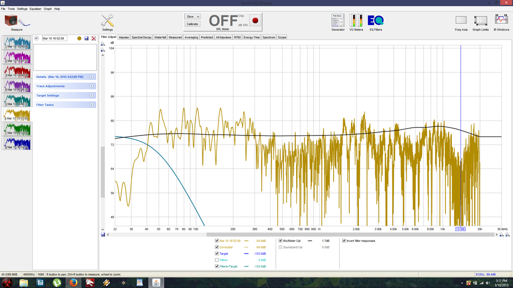

I'll attach a sweep I did earlier today. You're right, I should measure from my listening position but this was measured in front of one speaker since the other isn't finished yet. It is crossed at 2200 but with 24db slope . It was suggested to me that the bottom roll off of the tweeters with a 2nd order slope would effectively function like a 4th order slope. I'll have to try different slopes to see where it goes.

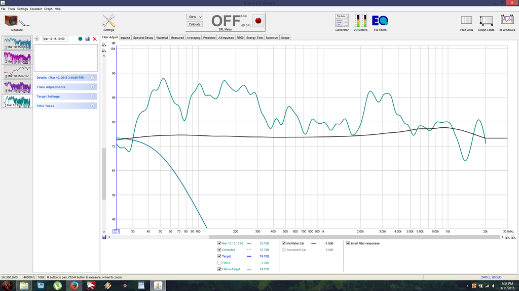

Anyway, here is a screenshot of the sweep after a little bit of smoothing. The 20-70Hz provided by my 15" woofers located elsewhere in the room suffered a bit since the mic was pointed in the opposite direction at the array. Plus, I now realize I need to start from scratch for the augmented, distributed bass. The 15" drivers I have now aren't going to reach as low as I'd like.
What I meant is that you can measure one array on-axis but be sure to do it at a distance similar to your listening distance. If you measure too close it will skew the results due to proximity effect. Once you get it dialed in then you can fine tune at the listening position.
I would avoid a simple 12db slope on the planars because it will limit your headroom. A simple 2nd/3rd harmonic distortion test will help if you can do that. I would also do driver correction with EQ applied while measuring the separate lines before you do any auto EQ with REW.
