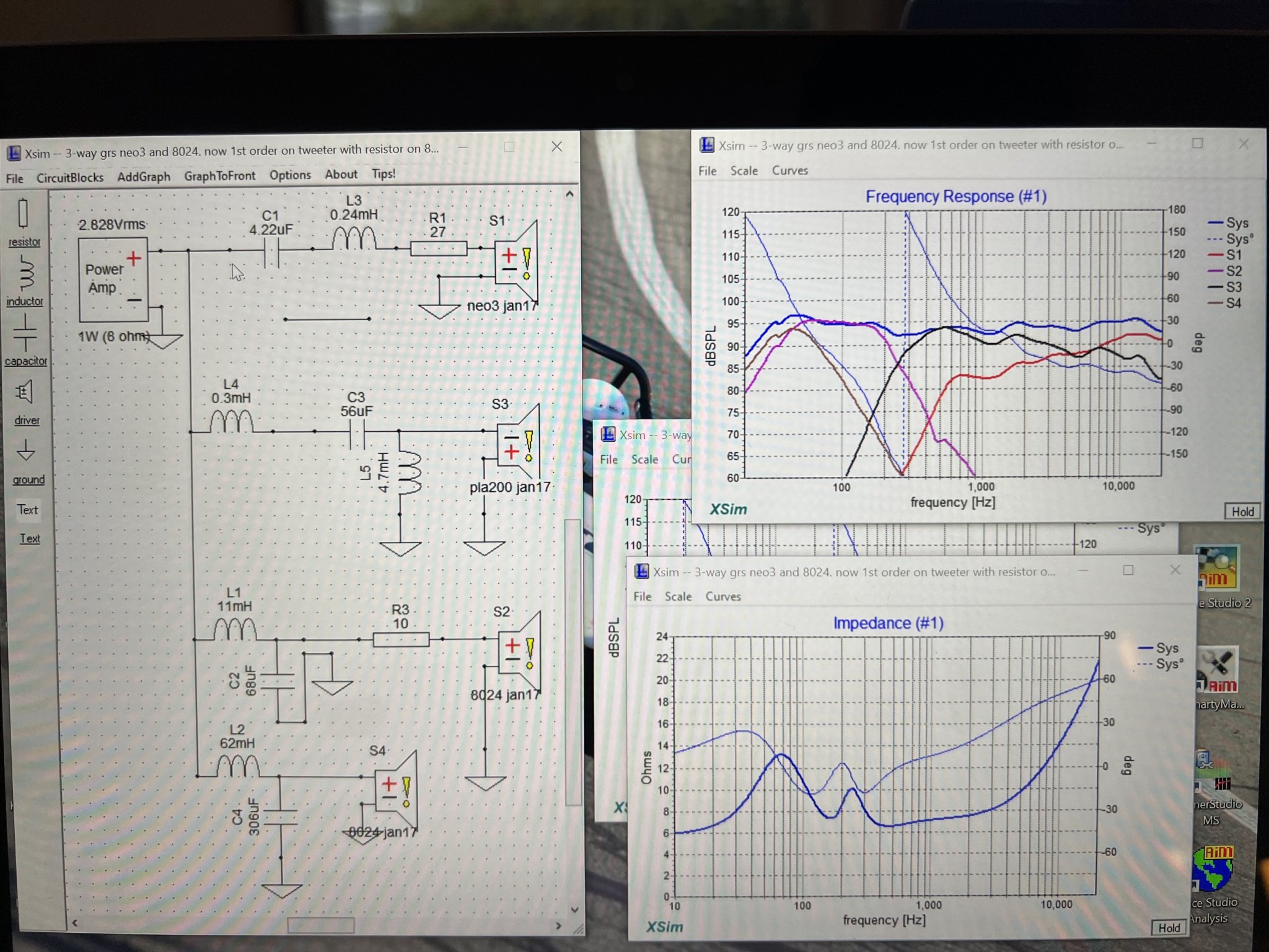

I'm a little bit concerned with running a first-order cross-over between the Neo3 and Neo8, and would appreciate yalls thoughts.

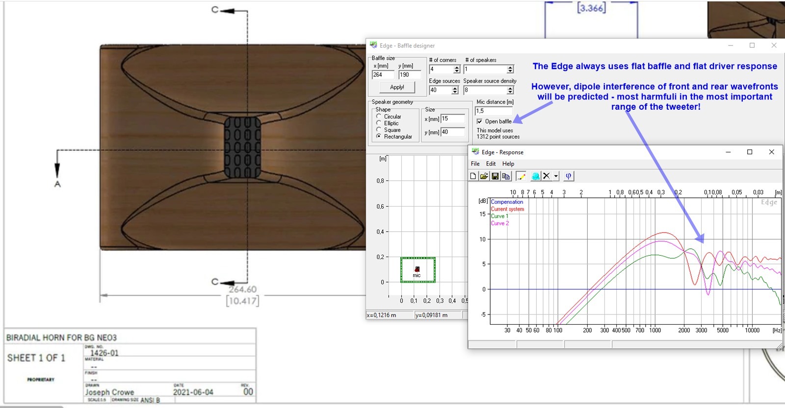

With dipoles, you must forget those Xsim sims.
Take measurements at roughly 1m (3'), also off-axis at 10deg intervals up to 90 deg (or more likely up to 180) Use ARTA or REW (RoomEqWizard)
Study real acoustic response and distortion (spl 90dB at 1m)
Based on measured data, start to figure out crossover points and slopes, and timing etc. You will soon notice some serious challenges...

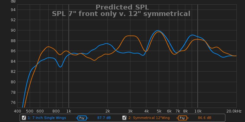

Hello guys! That Klipsh forum link is comparing 7" vs 12" wide wings, and only looking at frontal response.
That is totally irrelevant considering a dipole multiway project!

Try dong actual measurements instead of making statements unsupported by fact...and you will find that the directivity gain is consistent over 90 degrees horizontally (the vertical is controlled by the dipole height), both in the fore and aft directions below 2 kHz down to 600 Hz,. Harmonic distortion (indicative of modulation distortion levels), and phase/group delay also show significant improvement in these lower octaves. That's almost 5 octaves with the horn extension.When we want to achieve wide range of dipole radiation pattern, a single driver works only for max 3 octaves before distortion in low end and problematic interferences in upper band became limiting factors.
Here is an example of a 7-octave horn-loading of a titanium diaphragm compression driver: https://community.klipsch.com/index...on-driver-on-k-402-horn-and-jubilee-bass-bin/ They sound really good.
If this were not true, then the Klipschorn Jubilee would not exist...
Not really......and only looking at frontal response...
See those polar lobes below 2 kHz? That is what the horn extension (wings) controls--and it works extremely well out to 90 degrees included angle of the original driver design coverage, and down to 550-600 Hz.
As noted above, the addition of a rear horn/wing brings an additional 2-3 dB of controlled directivity below 1 kHz. More importantly, it extends the operating band by an additional 2 octaves, downward (2.4 kHz-->600 Hz).

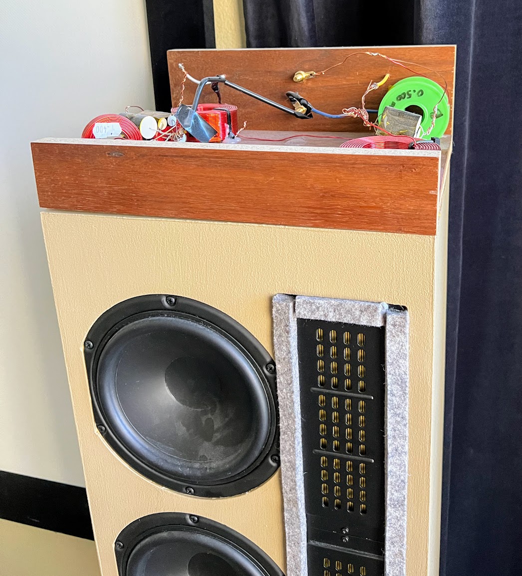

Great Idea. I already have some neo8s mounted with a 2" rear chamber (half full of natural wool felt). I built these to test out some ideas I had for something similar to a GR Research LS6/9 for my home theatre. I'll try and remember to post up a distortion comparison of these rear chambers vs. a rear horn load. I'll start a new thread on the home theater speakers when I get closer to CNC the baffles, but this project I want to keep open baffle.Very cool design. You should compare the rear horn against using a sealed rear chamber. Both serve to lower distortion.
