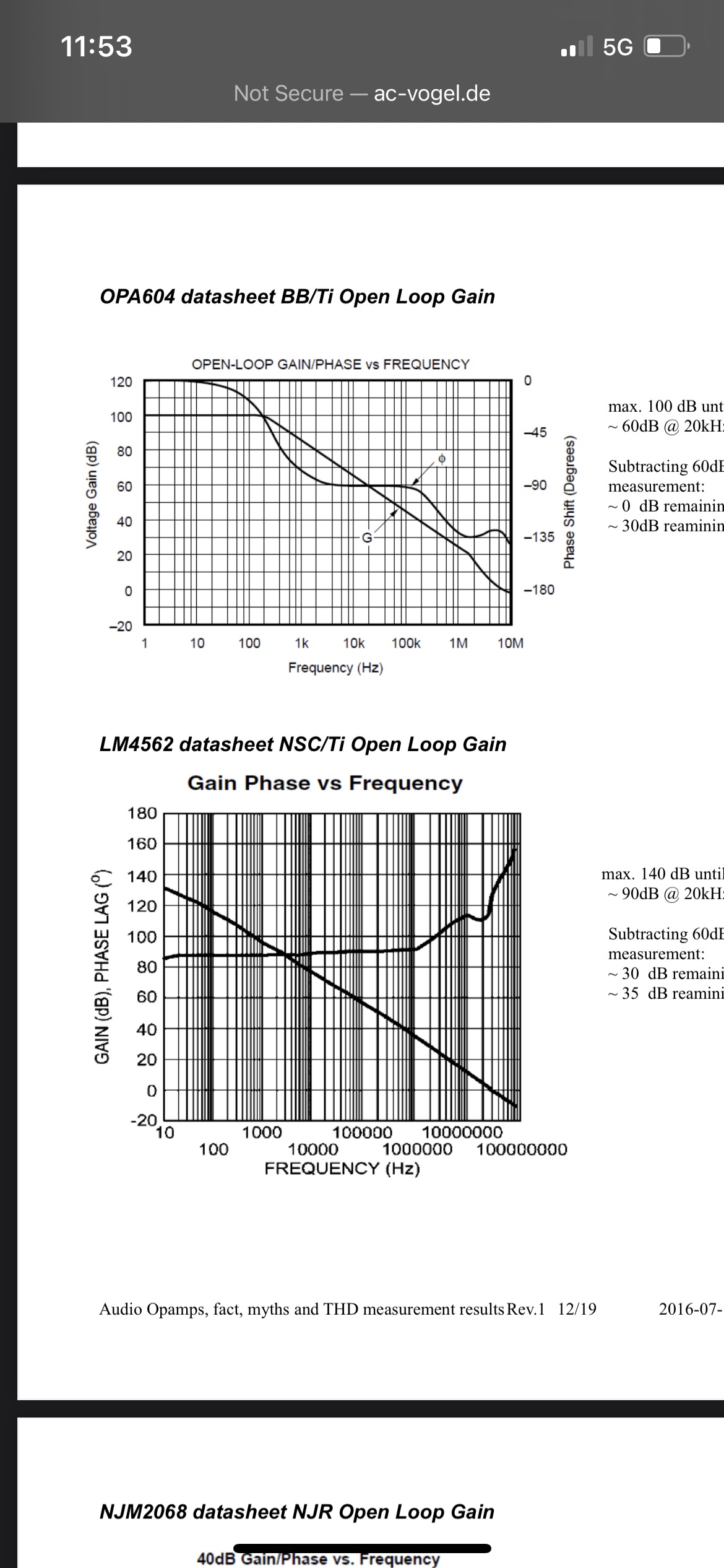

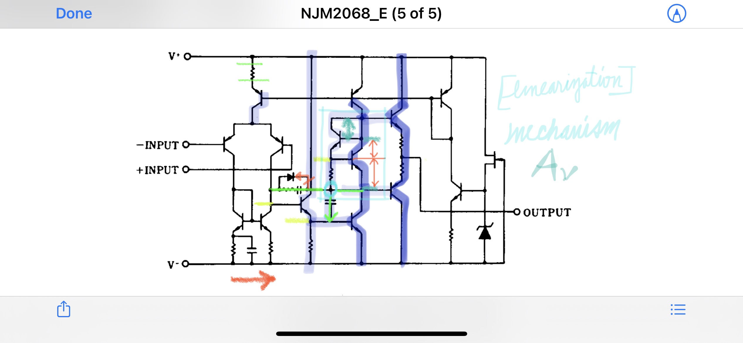

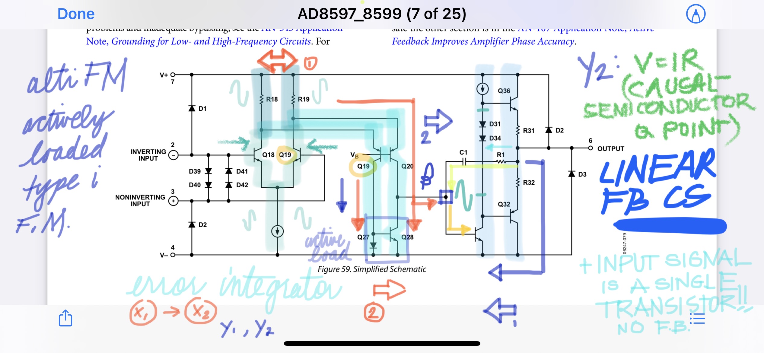

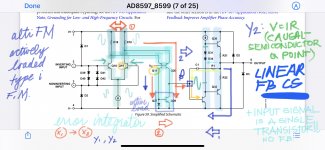

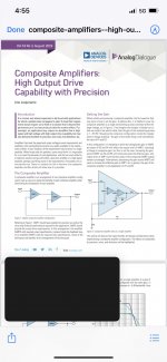

Still waiting for some useful explanation other than misery loves company
