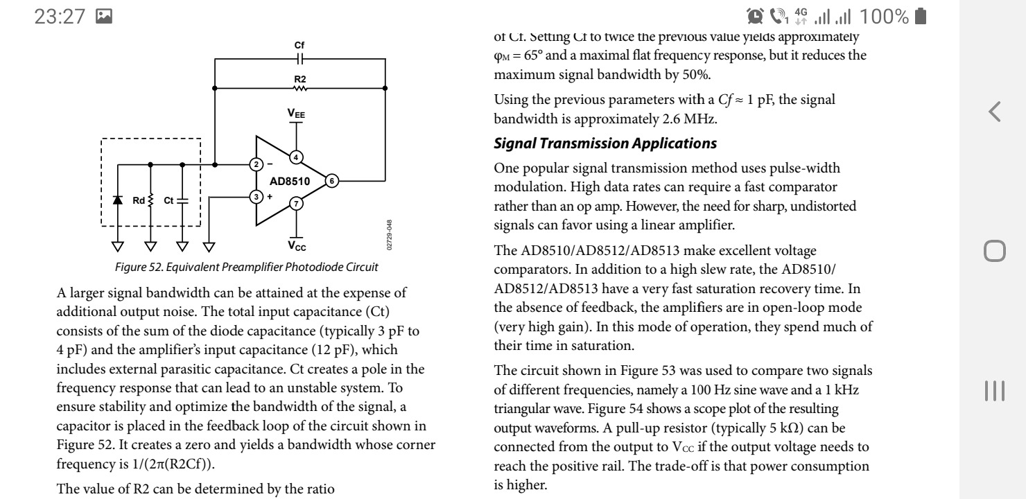

I've been watching this video/training series on "Op Amp Stability" from TI...... but did not see my "exact problem".... which I originally thought was capacitive loading or stray-capacitance (pcb layout).
It was mentioned somewhere that the small overshoot without "ringing" (bouncing) is not really a problem.
Found it....
Do-it-yourself: Three ways to stabilize op amp capacitive loads

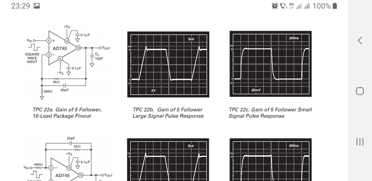

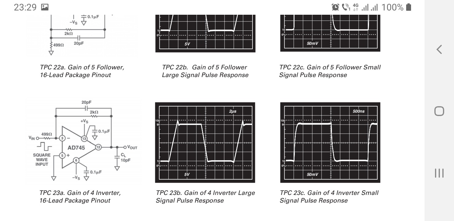

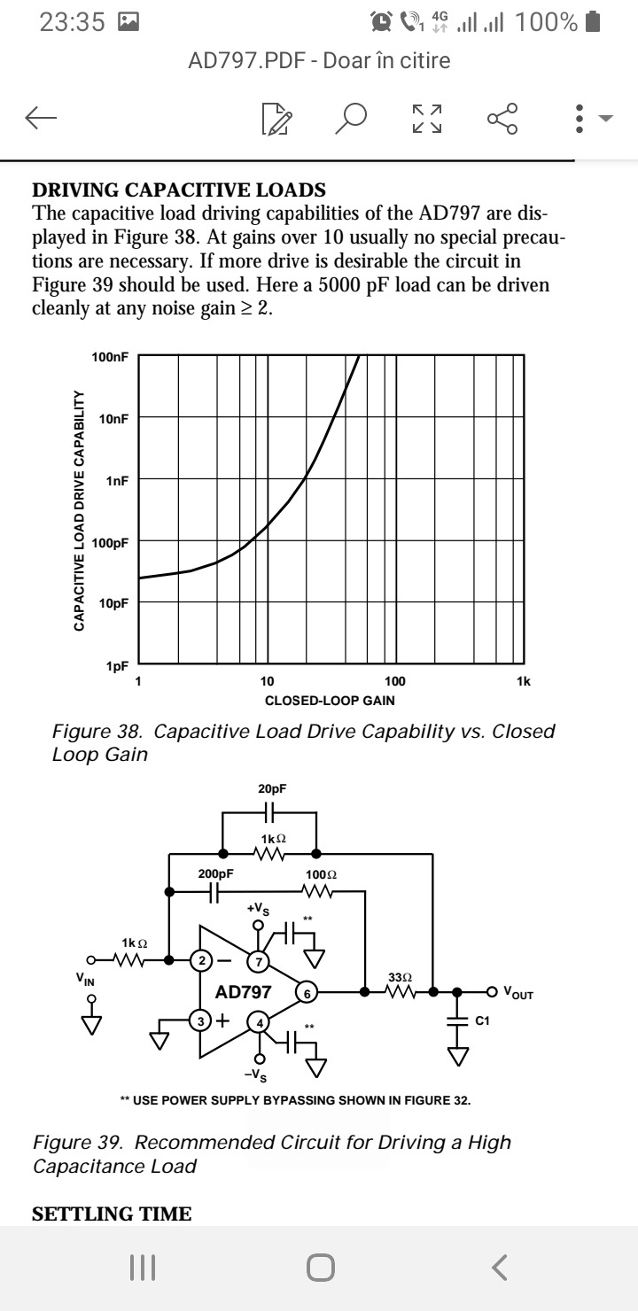

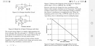

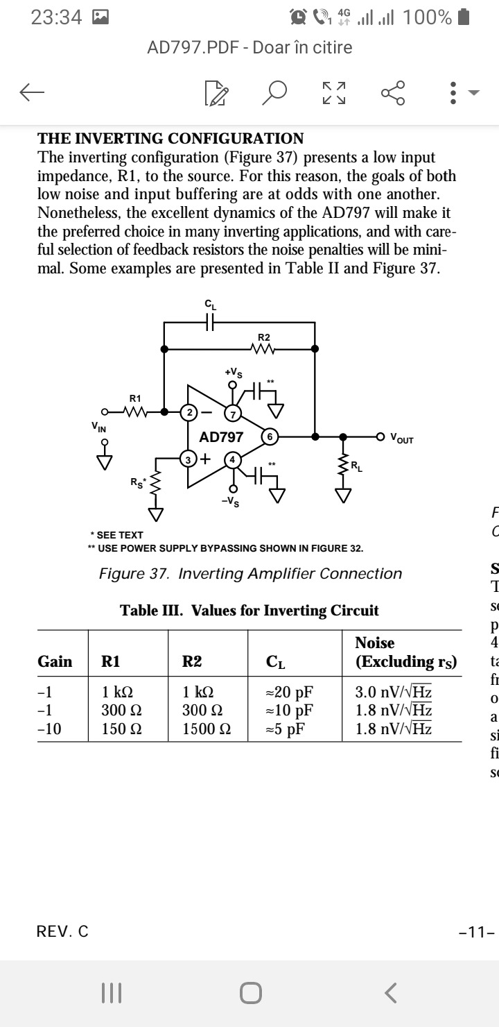

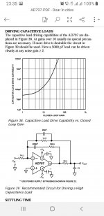

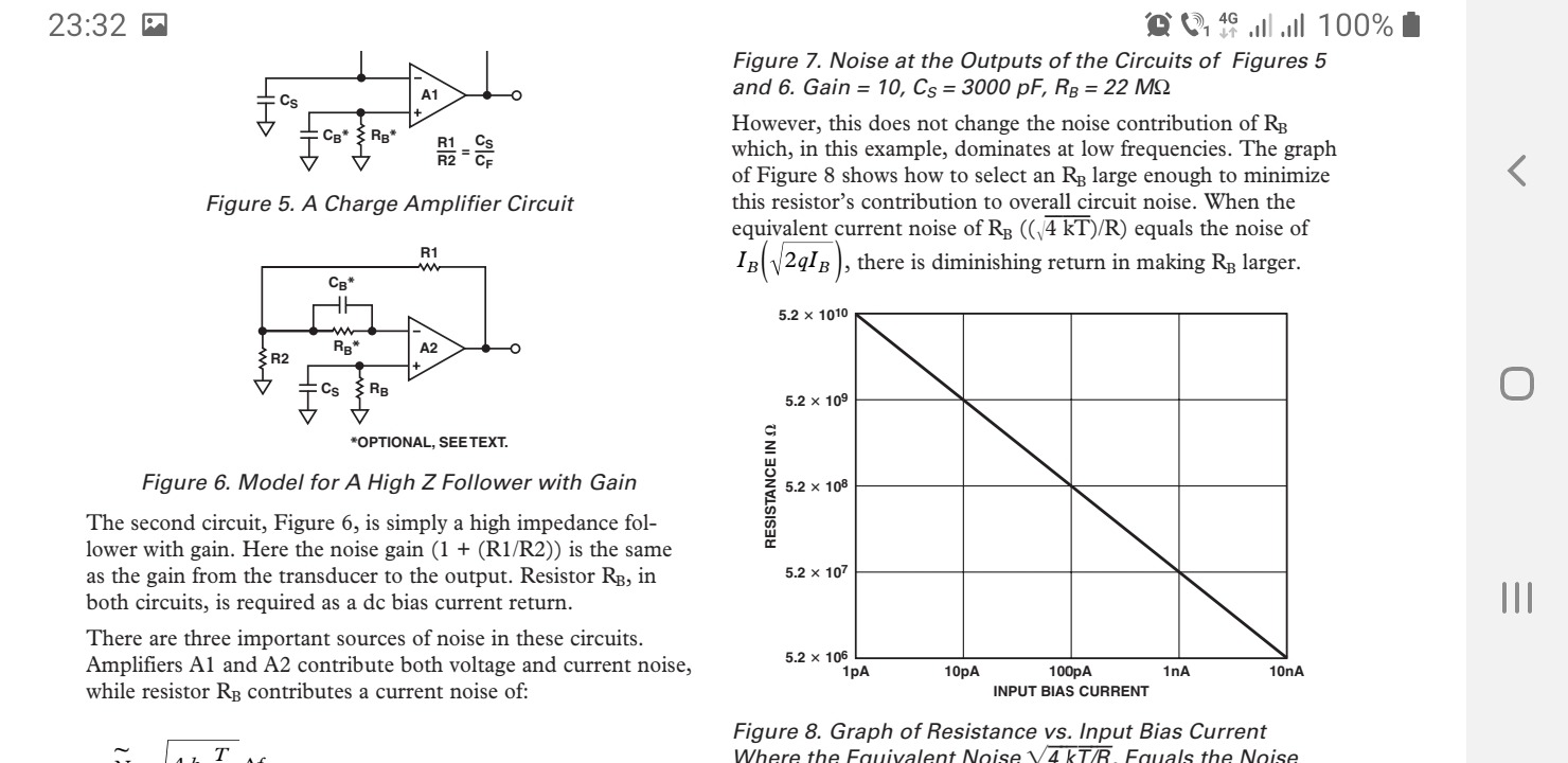

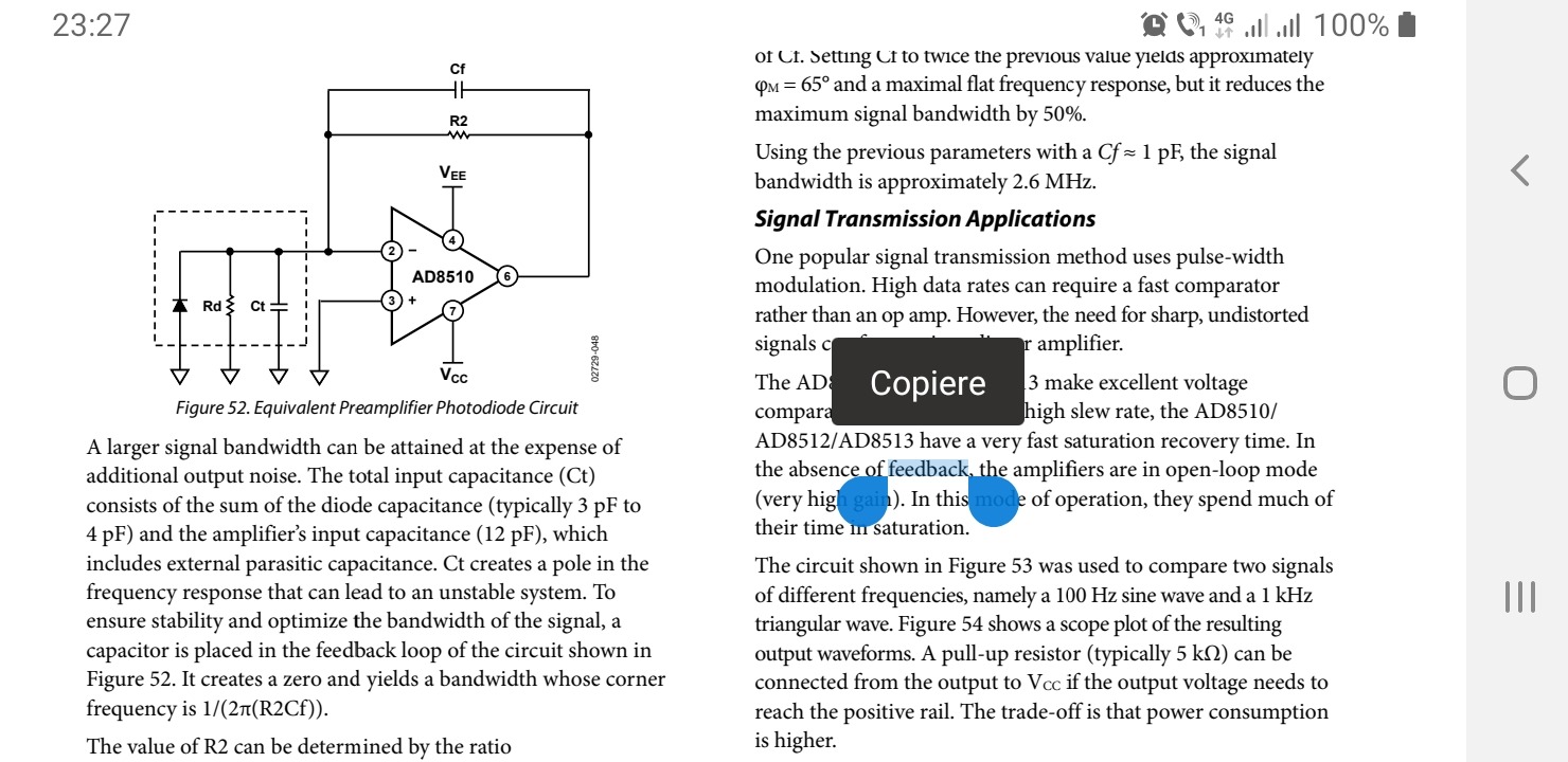

It seems that you ignored some of the ad8135 datasheet.You get better explanations in Barrie Gillbert and Scott Wurcer datasheets for Ad745 and Ad797.
