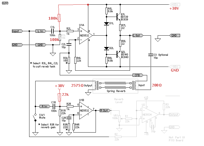

I have a tape-echo / spring reverb unit. It is a Dynacord Echocord Super 76 from 1972. The tape echo sounds great. I replaced the reverb-tank with a 8CB3C1C. The difference was huge: from bathroom to church. Now i thought if I could improve it further and replaced the recovery stage with a +40db preamp i had around ( 40kΩ input ). better, less noisy.
The Echocord uses a ..709 opamp to drive the reverb. I wonder if I can improve the sound either by modding the existing circuit and changing the opamp to something newer or by building a new driver stage?
I found a circuit and some informations here:
Spring Reverb
Spring Reverb Unit For Guitar
reverb2
I tried to change the circuit to power it from a single +30V. (attached image).
Is it this easy? just add voltage dividers on the Inputs?
Should I use the mentioned NE5532? Or do I need a rail to rail opamp?
Is the BD139/BD140 output-buffer necessary?
Can the recovery stage provide +40db?
And what is the purpose of the 1k resistor in series with the input coil of the original Super 76 circuit?
My experiences with opamps are very limited. I tried some basic things with TL072 some years ago, but was not happy about the results.
So any Suggestions welcome!

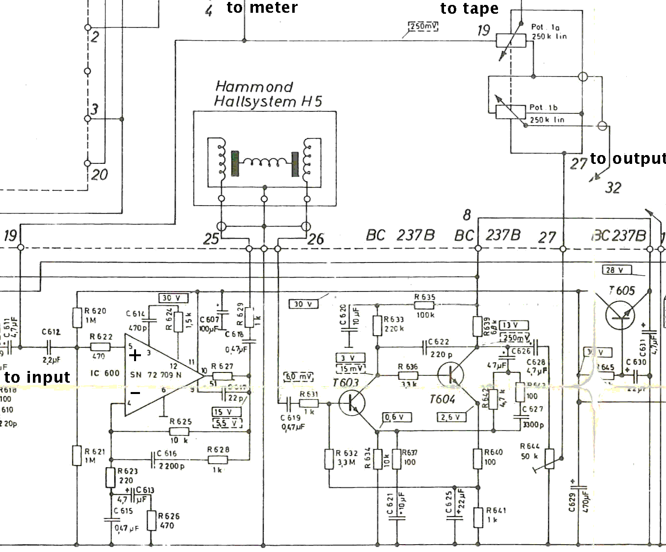

complete Echocord super76 schematic:

The 5532 is fine but does need the buffer to drive loads below 600 ohms. The buffer output will be sat at +15 volts DC and so the cap C3 is needed. The lower opamp also has its output sat at +15 volts and so needs to be AC coupled to the next stage.
The 1k (R629) will be for both level matching and impedance matching because the 709 like any opamp has very limited drive ability.

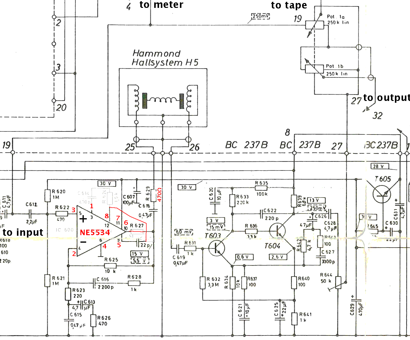

Thank you!
The 5534 seems to be pin-compatible when i stuff it at the good point in the DIP16 socket. So this could also work, perhaps with R629 lowered to 470Ω, compensation removed and the 22p cap connected from pin 5 to 8 ?
Is the 22p (and R622/ R627) necessary or useful in this case?
Then I could play with the caps and resistors in the feedback to the negative input to shape frequency response.

I wouldn't have thought R622 was needed (with the proviso that these have all been fitted originally, probably to ensure stability... so always check its OK with a scope). R627, a series output resistor and the hf comp cap again are for stability. A low value (say 47 to 100 ohm) series resistor is common practice with many opamps. Stability issues show when driving low value capacitive loads, a few 10's to hundreds of pf.

All in all the dynacord circuitry looks pretty good to me, the were clever in driving the coil with an ac-current source.
Coupling caps in both send and return paths should be reduced for a low cut of several 100Hz - to much low frequencies only mess up the reverb effect.

I replaced the driver circuit with minor changes, i used a NE5534 and decreased R4L a bit. It worked great from the first test and removed the noise-problems i mentioned earlier.
I could not get any non-inverting recovery stage to work good. (Just got astonishingly clear radio receiving at one point when i was swapping components on the breadboard...) It must relate to the following circuitry of the unit.
So I tried the inverting configuration with 22k / 2M (~90x). This works great now!
I powered the opamps from different points of the RC-line to prevent motorboating.
It seems I don't understand something obvious about the difference between the output of the inverting / non-inverting opamp. I also tried to split the recovering amplification between 2 inverting opamp-stages to see if this makes a difference somehow. But the result was much more quiet than what i expected. wrong impedance-bridging?
Putting caps (tried 500pF - 100nF) parallel to the recovery coil did not make a really audible improvement to my ears ( accutronics mentions a 22nF cap to "improve high frequency response").
The unit has a switchable tonestack behind the recovery circuit anyway. It is useful to increase highs or decrease lows if necessary. When it is switched off, the wet reverb signal is routed through a 4.6nF cap now. This way it is possible to cut lows of the reverb, leave the tape-delay unchanged and combine full volume delay with reverb. (not possible in the original circuit). I use the footswitch as the input so the unit does not output any dry signal.
It is also possible to swap the two output wires of the preamp to get full reverb and adjustable dry level.
I can strongly recommend this changes (take care of mains voltage very close to the reverb tank!). If someone is interested I can also draw a schematic or take photos of the mods.
Thanks again for all the help! Great forum!
jens

I used these driver and recovery circuits:
Spring Reverb
Here are some fotos showing the new TAD-spring and circuitry:
https://i.imgur.com/IzdE070.jpg
https://i.imgur.com/6B5AGna.jpg
https://i.imgur.com/kE7CErv.jpg
https://i.imgur.com/eddOEOp.jpg
Opamps are NE5534, ICs BC639/BC640
