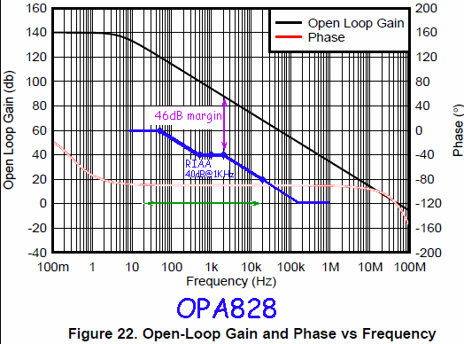

80 db open loop gain is a little low. Bass may suffer, highs should be excellent.
Subsonic is 140dB (claimed). 130dB at 20Hz. GBW curve is smooth. Plotting a 40dB@1KHz RIAA on the OPA828 GBW graph, we see the 'critical' point is 2KHz-20KHz, where we have 46dB gain margin. (58+dB in bass.)
That should be really ample for any need.

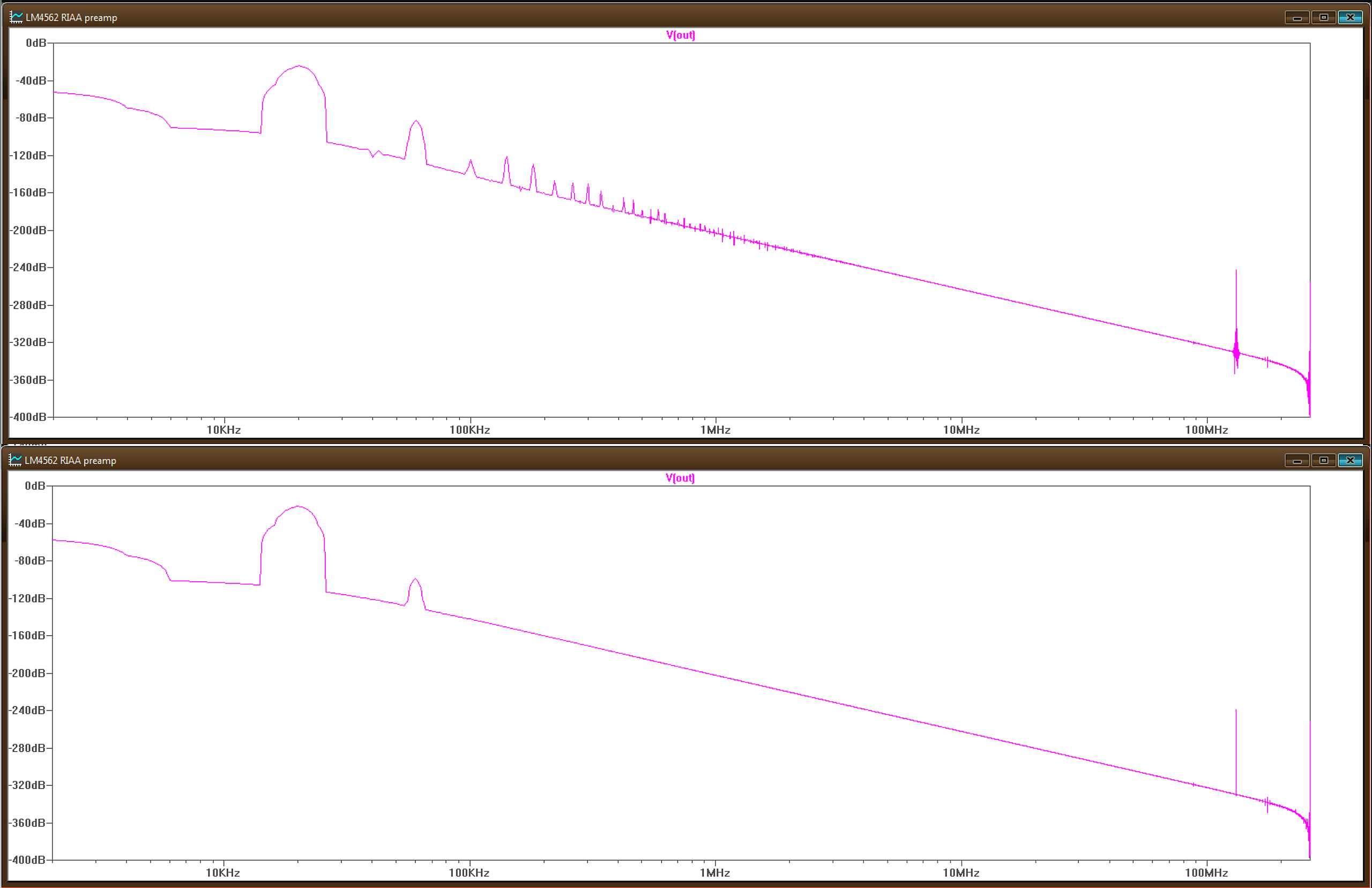

How can I make RIAA simulations more effective and realistic?
Do THD simulations really mean what they show, for instance? What about noise?
Just to play with, I took the LM4562 simulation I had from the datasheet, which didn't provide interesting THD results, and replaced it on the sim with a FET low noise chip listed on LTSpice, reasonably priced.
Has anyone anything to say about this sim, for or against?
