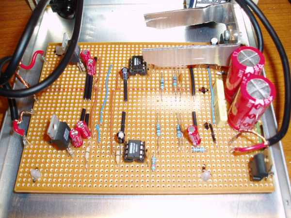

Strip Board
Hi William,
It's a wee prob trying to use strip board for this circuit, but you can obtain a reasonbly good looking design.
If you use the 100 by 150 board as iv'e done, and use the first four central strips for ground. Then i placed the regs on the outer edges for the power , well that's just one method i used , may not be the best. Then used zero link's and some cat 5 aswell.
Hope the attatched image say's more..
The large heatsink on the pos reg is due to a small prob that not even a electronic buff could work out ! Well not visually anyway.

Hi there,
I built a opa627 buffer on strip board (the copperless type). I got it about half the size of pete.a 's. No problems with grounding. Two star grounds, one for each channel and then linked at a master star ground. I used basic Zener-transistor regulation, with both channels sharing the rails. I had 47uf of electro caps at the chip pins, bypassed with 1nf film caps, and with the two rails tied with a 0.47uf cap (this made a big difference). Very simple.
Worked perfectly first time and sounds lovely and detailed and smooth.

Working with stripboard is a lot easier if you start by "converting" the schematic into a building sketch with the IC's and power rails drawn in first. Then add components to the sketch one by one, use red ink to note where you have to cut the traces (a simple cross will do as well) and where to add jumpers. This will give you an idea of which tracks should be used for power and also how much spacing is necessary to fit everything in. When you've completed the sketch and double-checked to ensure that everything is correct it is quite easy to place components (start with the IC's and the jumpers to your designated power traces) and mostly you'll be able to assemble even complex circuits without mistakes. The "design-phase" of the sketch is of course quite tedious, but if you ask me it's not nearly as tedious as trouble-shooting circuits built on stripboard 🙂hihopes said:3) Out here in the sticks, I can only get stripboard to build on. I have been through so much of the stuff it is sickening. (bits of circuit lying all over the place!) Before I waste any more board (and components), does anyone have any useful hints on working with stripboard for this kind of project?

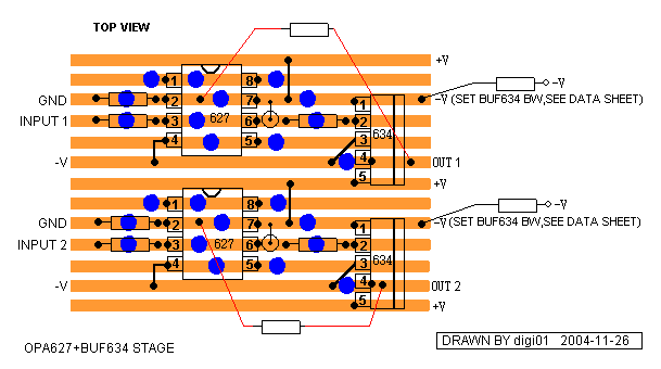

a ground plate shoule be fine.this is my design,the board is carved by a knife
http://www.diyaudio.com/forums/showthread.php?s=&threadid=15403&highlight=digi01
digi

Digi01, thanks for all the tips and info and especially for the stripboard layout. I had a totally different idea (To place the buffer "above" the opamp in each channel. I never considered placing tham next to each other. Will have a good look at your design. Perhaps after building in stripboard, I will try one like you did by carving. Looks cool!
