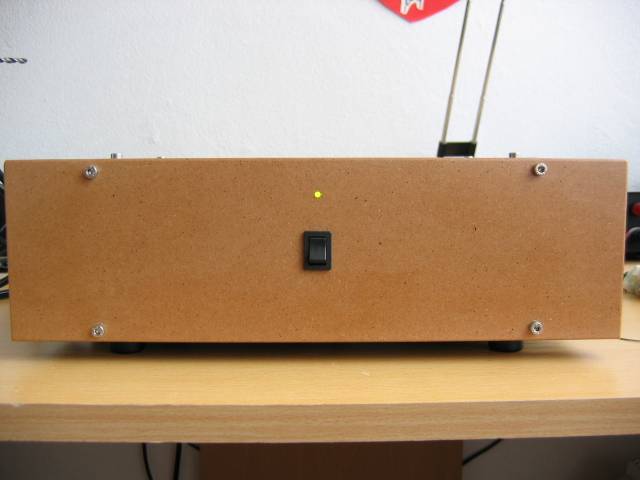

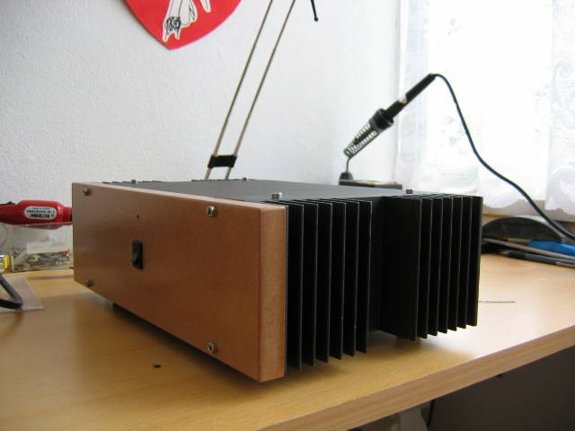

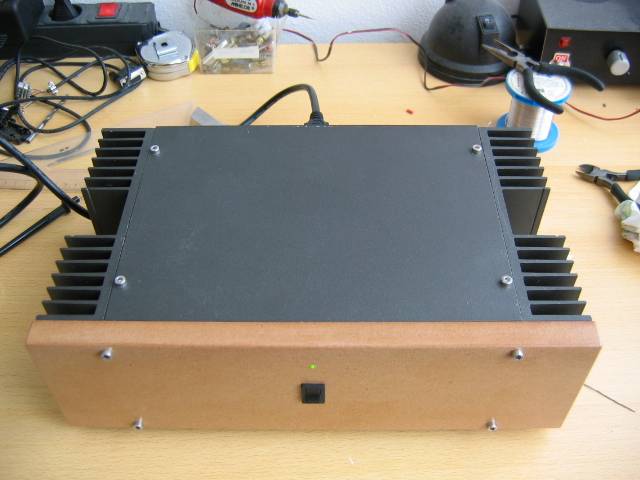

Nice work, the case!
Is the front real wood or MDF?
If MDF: dont hesitate to apply shellack! Gives real great results, but must be learned (can be removed with alcohol...).

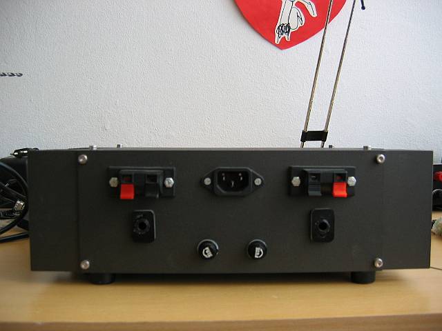

the case is very neat,front board looks simplicity and nature😉
do you piece together the parts for the case?

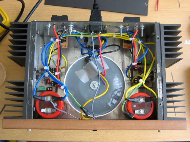

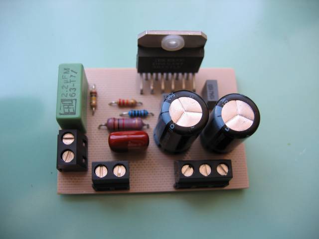

you have more components there than those in the application notes. whats the extra components for?
Sorry for the delay ifor my answer :
FranzG : The front is from MDF and the capacitance is 2 x 15.000 uF but they are not connected (sound is much better without them)
Demogorgon : the trafo is a 2 x 19V 220 VA and is isolated to prevent hum and vibrations
Digi01 : I run it on +/- 26V per rail, I made the case - it took me some time
Getafix : more components ? There are 2 cond. 1000uF each for filtering the power suply, 2 cond. 100nF for blocking the power suply, 2 resistors for defining the amplificacion, 1 resistor for input, 1 input cond. and the extra thing is the zobel network directly on the PCB.

I have just received my opa549.
I am planning to do an amplifier like yours shortly.
would it be possible for you to send me the copper layer of your pcbs?
Else, as the "dissipation" part of the opa549 isconnected internally to the V- ; I think you have isolated it from the dissipator; did you used isolation pads?
thanks
thanks
Just wanted to ask a couple of questions- I would assume the circuit is non-inverting? How much hum do you hear through your speakers, and what kind of speakers are they? Some advice- I would guess from the picture of the pcb that the red coloured capacitors are for the zobel. These will affect the sound a lot more than you might think- use good quality ones (like the ERO you have on the input).
