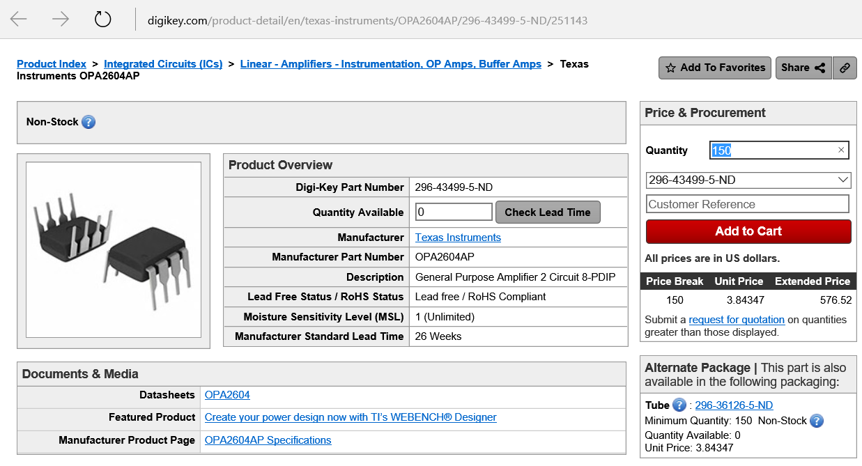

digikey has them...
OPA2604AP Texas Instruments | Integrated Circuits (ICs) | DigiKey
Are you sure? I clicked on your link and got the attached. Do you see it different from your side of the pond?
That's right, 44 volts (as a total) in whatever arrangement you want, single rail or symmetric/asymmetric dual.
My bad, you are right...
