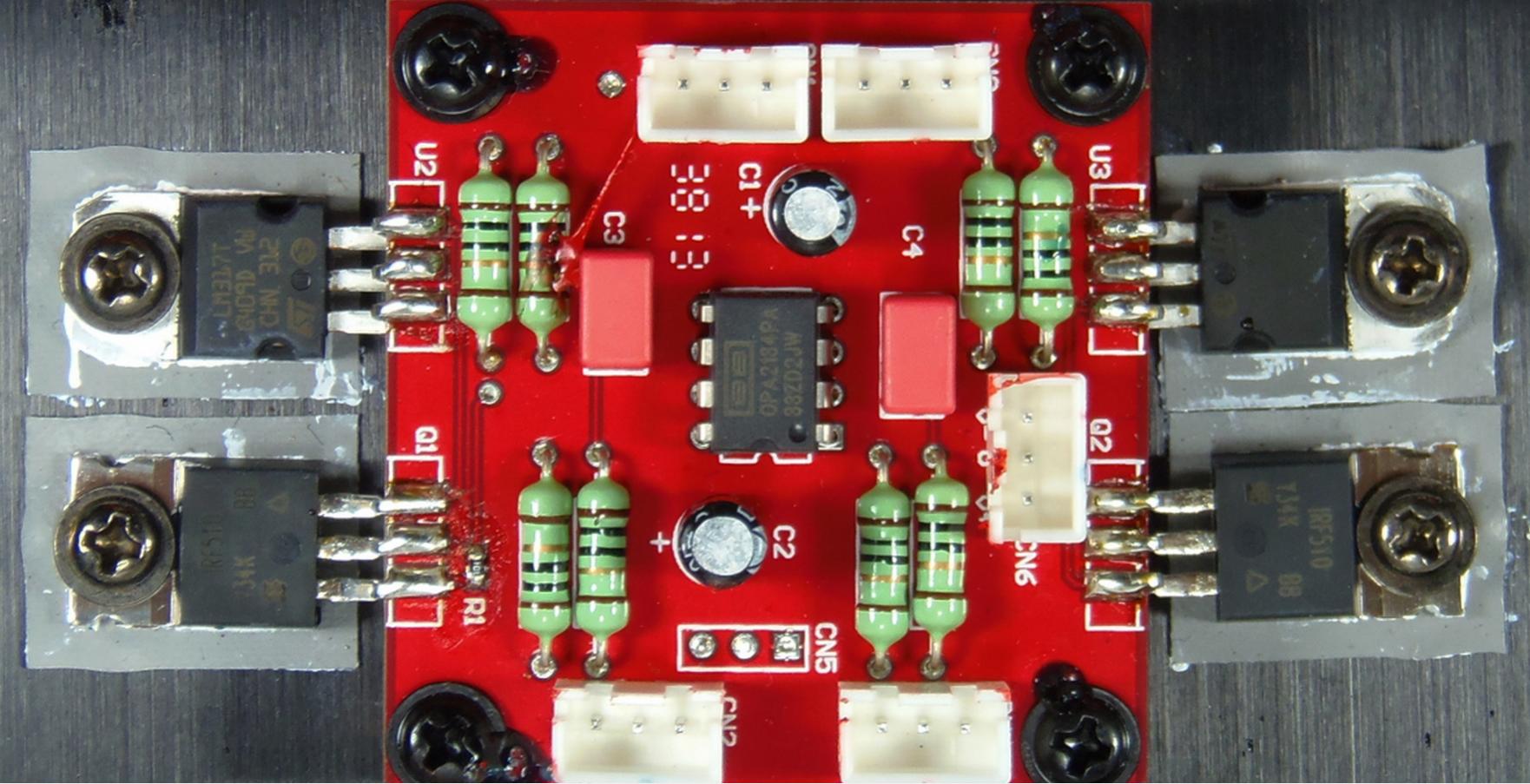

I found a photo of a commercial design, that uses a OPA2134 along with a pair of IRF510's for the output, that I would like to build and try.
As seen in the photo, there's also a pair of LM317T regulators which I assume are used as some type of CCS for the 510's.
All the through-hole resistors appear to be the same value.
C3 & C4 appear to be Wima caps. perhaps used as coupling caps. on the inputs?
Can someone, who understands this circuit, please draw up and post a schematic of it?

I don't know anything about this circuit, but I don't see how it could be an effective headphone amp. I'd guess it's part of a larger system, maybe it's some sort of voltage or current regulator (can be accomplished with an op amp & 317s)? Just shooting in the dark here. Do you have any other pics?
the 1st question for headphone amp projects should always be "for which headphone?"
they vary by orders of magnitude in Z, sensitivity, required I,V
MOSFET buffers can waste a lot of Vsupply - whether that matters depends on what the particular model of headphones you want to drive need

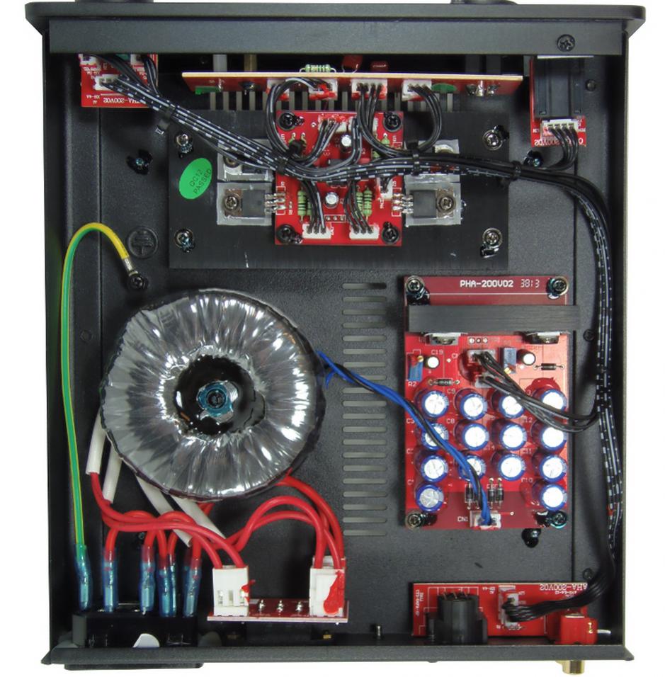

Here's a photo of the interior:
Should be similar to what's been discussed in this thread, opamp + Class A MOSFET follower w/ LM317 CCS, either inside or outside the feedback loop. Pretty standard stuff in DIY about a decade ago. Not especially efficient, obviously (a push-pull output could deliver twice the current, not to mention the possibility of transitioning into AB), but simple, easy to bias and doing well in terms of distortion.
Here's how a basic Szekeres (just the buffer) will fare with and without a CCS.
Instead of the MOSFET, it basically is also possible to use a BJT, a Darlington - or even another LM317 (there's a thread on that somewhere in this forum).

Don't think that it's as simple as what you see on the top of the board. I see one surface mount resistor on the top, which means there could be a plethora of other surface mount components on the bottom.

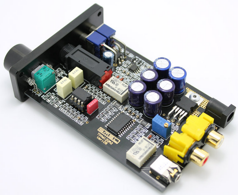

Would one of these units off Ebay, pictured below, be a good choice to begin with? Looks as though I can install whichever op-amp I want.

could be a platform to hack - likely not optimum feedback/gnd layout by CFA standards but if its not oscillating...

at ~$50-60 that amp looks like its offering great value - even if I would like to see some differences in layout, would need schematic and parts list, PCB to guess more

I think I'll get one just so I can get some idea of how the 6120 sounds.

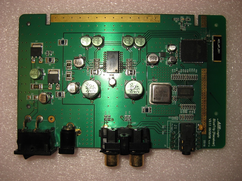

I have an old bluetooth audio receiver meant for Apple products that uses a 6120 for the outputs and runs off a single supply.
I bought it to try and use with non-apple devices but it had a weird "blip" in the sound every few seconds so I never really used it. I've thought about converting it to a headphone amp.
