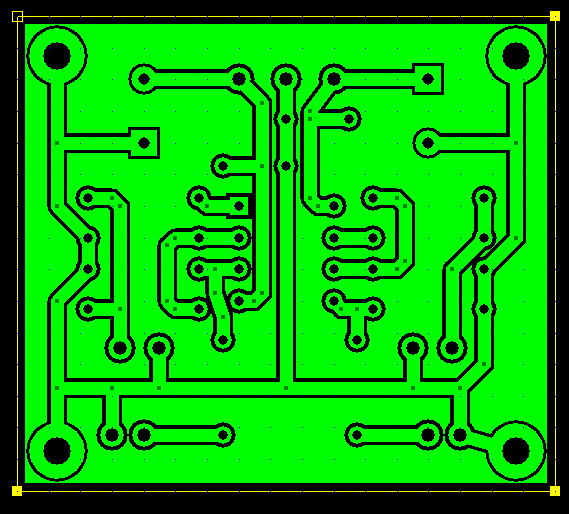

Okay so I want to build a simple opamp based headphone amplifier.
I came across a simple circuit (please see attachment) that utilizes an OPA2134PA. I checked my local electronics supplier and they have it in stock.
My first thought was to build it on breadboard, but then my friend said that he's going to make some PCBs for chipamps that he is building, and he said he could make me some PCBs while he is at it.

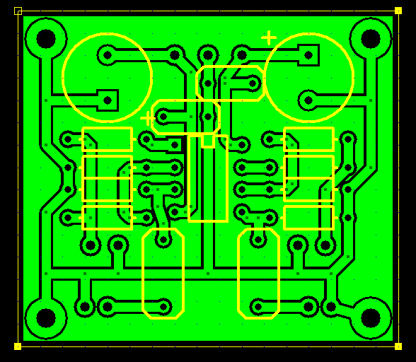

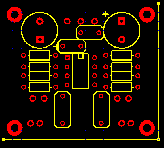

I made a design with ExpressPCB and was wondering if somebody here could check them out and say if these PCBs are good enough to use.
Also, can I opamp roll with this? I have a few different chips I'd like to try 🙂
If this circuit is garbage, then please recommend me some better ones. Not anything too complicated or expensive, but something that has good sound and allows chip swapping.
Thanks!
Looks OK, worth a try. 2134 is exciting, until you get tired of the zing. Then try LM833.
Put storage caps on each rail, since Zo of batteries ain't too great.
How much gain do you have with your feedback resistors?
Edit1: you might need a current buffer stage depending on your listening level and the impedance of your cans. Most high performance amp designs do have an output buffer stage. But the opamp can source a reasonable amount of current, so try it first. It will distort if overdriven.
Edit2: 2134 has small DC offset so no problem, but some opamps have larger offset and will thump when you turn it on/off unless you use an output cap to stop the DC. Since the load is low impedance, you will need a large value cap to preserve low frequency response, which means dreaded electrolytic. :O Nichicon low leakeage is good for this.

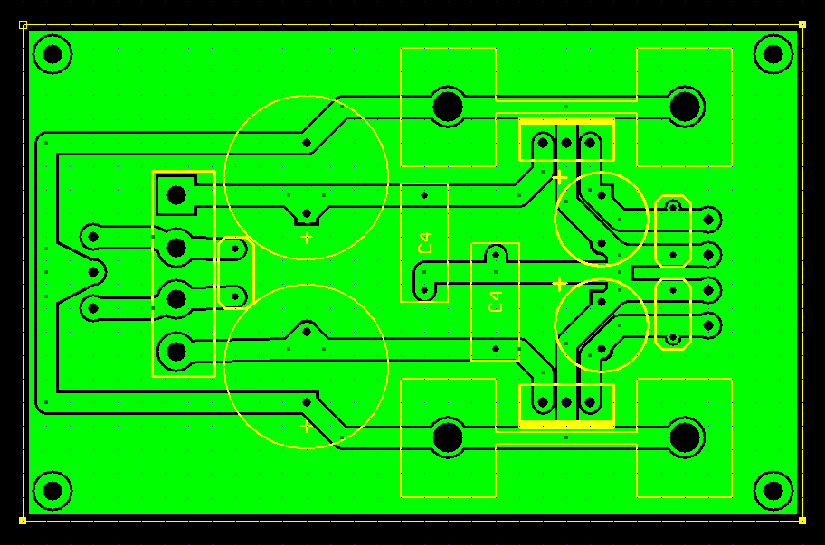

As for the power supply, I did put filter and decoupling caps on the board. Power supply will be a transformer and a regulator board. I will make the regulator board, and post it here 🙂
EDIT: Made this regulator board. Can be used with any 78xx and 79xx series regulators.
You must like colored sound. Using 55 Ohm impedance give high THD if you use that schematic.
Colored sound with what, the first schematic? Well then recommend something better, I really don't know what to use.
How about a simple Cmoy with a socket to roll op-amps?
