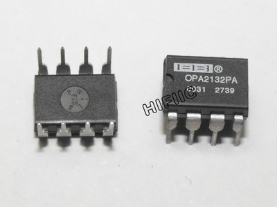

Thank you theAnonymous1 for the super fast response to my query. In the spec sheet on TI site, they have given for just OPA2132! I bought a few on the e-Bay from a HK seller. Now I'm not sure if these are genuine or generic/fake.Here's a picture of the device.

They look very different from the genuine OPA2132PA that I have, but that doesn't necessarily mean they are fake (but very well could be).
The stamping on the bottom of mine say they were made in Malaysia, not the Philippines. Perhaps the ones from the Philippines do look different even though genuine, I don't know.

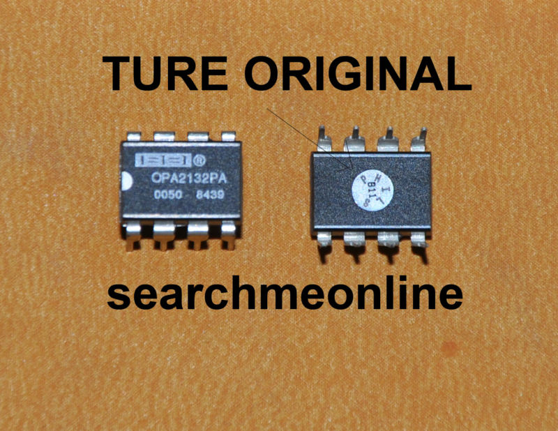

I did compare this to a few other packages such as BB, Fairchild,ON but mine doesn't corrospond to any of the packaging description of the others. However, it does sound "good" to my ears,yet I have no way of comparing it with a BB ATM. Good to know that the PA version is good as it gets & is good enough for audio,besides it's only about half the price of the original BB! This is what tempted me to buy these in the 1st place!

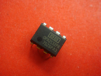

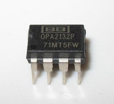

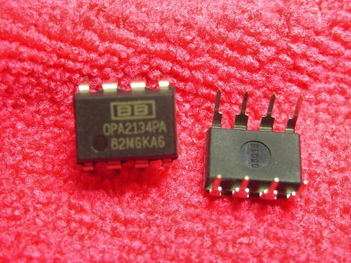

Yes,yes... I do see now a few different parameters between these two, sorry! I did observe one thing though...the markings on the devices. I noticed that the BB logo is printed smack in the middle on top section of the device on some as is in the original BB, but more to the left or right on others! I'm not sure how significant or helpful this is in identifying the various manufacturers? There are also other give away tell tale signs like production date/batch no/origin etc. Perhaps someone would care to give us a photo of the original?

So, is this the original BB chip then? Looks exactly the same as my 1st picture. I think it would be safer to buy. The TI 2132 will be the closest one would ever come to the the original, since BB is still manufacuring these under TI logo at present.
It would be the other way around. TI owns BB since 2000 but many products designed by BB are still manufactured under the BB logo.
The problem with relying on the position of printing is that even on genuine products it can be all over the place. For a few pics of several different OPA627s (because of the high price very counterfeit-prone) through the years, please take a look at this thread: http://www.diyaudio.com/forums/parts/198171-genuine-opa627-info.html. Some might look very similar to some of the OPA2132s in this thread.

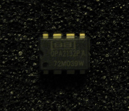

Faked opa2132pa?
I bought these op amps and I suspect they are fake / remarked. The seller is trying to convince me that these are NOS part made by BB before acquired by TI that why they look different.
What do you guys think?

those look fake to me ...
