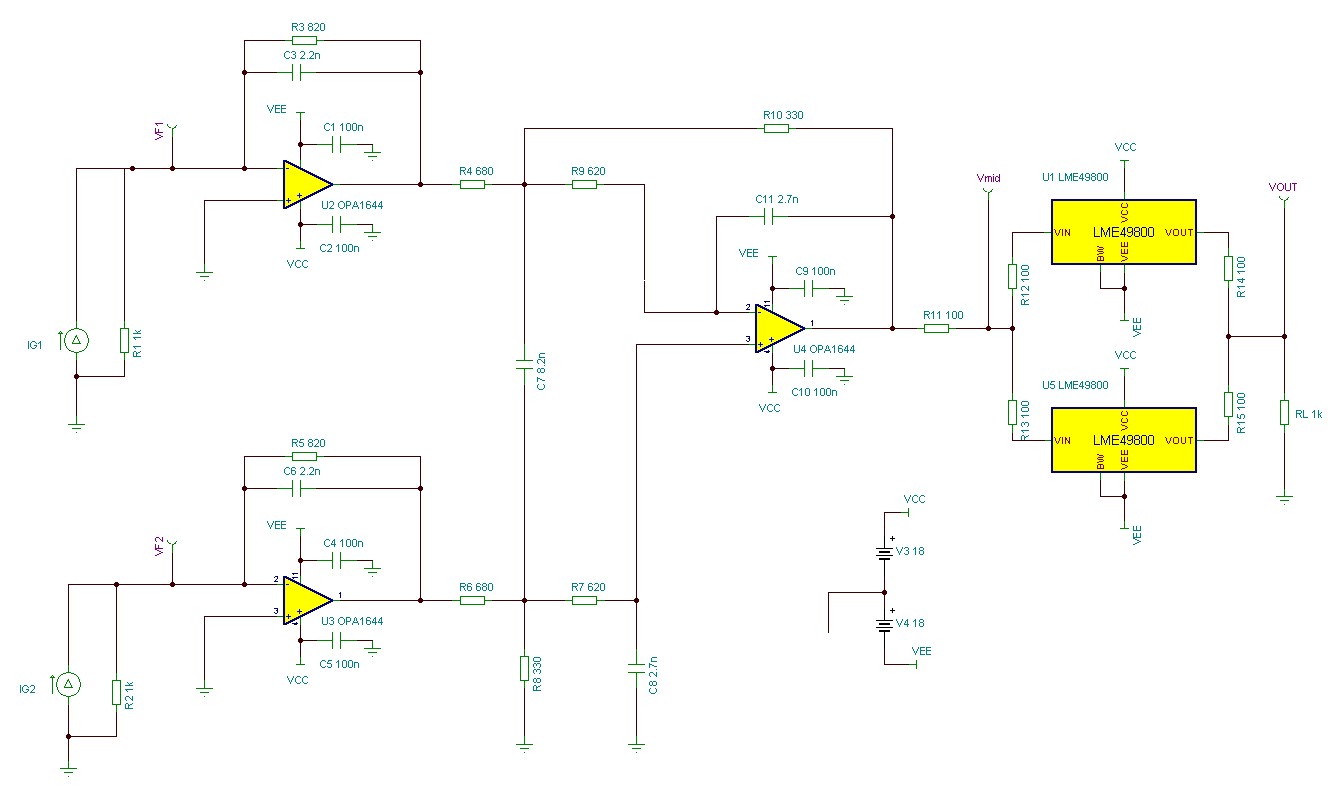

What do you think of this?
I'm planning to connect it right after my buffalo III. The output will have more LME49600s, in parallel. Probably 6.

what are you driving? - not enough V or V gain for pro audio line out, low sensitivity headphones
for consumer line levels, cable lengths the buffers are unnecessary - and open loop likely add more distortion than the op amps - not that we can tell from the LME49600 datasheet since the device THD # are shown inside a high loop gain op amp feedback loop

I'm driving nothing, this will drive my speakers (91db) directly but with 6-10 LMEs at the output!
Unfortunately, I cannot make any sims with TINA-TI, and I don't have the models of those opamps to do sims with LTSpice....
Any advice that you might have for my attempt are most welcome!

no the LME buffer isn't that good near the rail the datasheet shows it needing 3.5 V to drive -150 mA - and the table has typical and worst case # reversed - this is about the worst datasheet I've seen in a while from such a big player
you can also use the datasheet table gain/load numbers to get ~ 5 Ohms output R – so the emitter R must 10 – giving 2.5 V drop with 250 mA, then add output Q Vbe...
for a speaker driving "flea power" amp I would try a (or two paralleld) LT1210 1 A output CFA that comes in the easy to heatsink TO-220 in a multiloop - I have used the faster but lower current LT1206 TO-220 in a multiloop prototype
the LT1210 would be a savings on $/A too

the LME buffer is fast enough to put inside the opa164x op amp feedback loop with only a little concern, attention to a few details
using a lot of the LME in parallel you need to look at the load all of the LME input's input C adds up to
and the load sharing R should be much lower value both to keep load C from adding excess phase shift and to not lose any more than the minimum possible of your V supply headroom at max output current
you could even in principle put the buffers inside your 1st schematic's differential to single ended converter/filter feedback loop

Hi Jan,

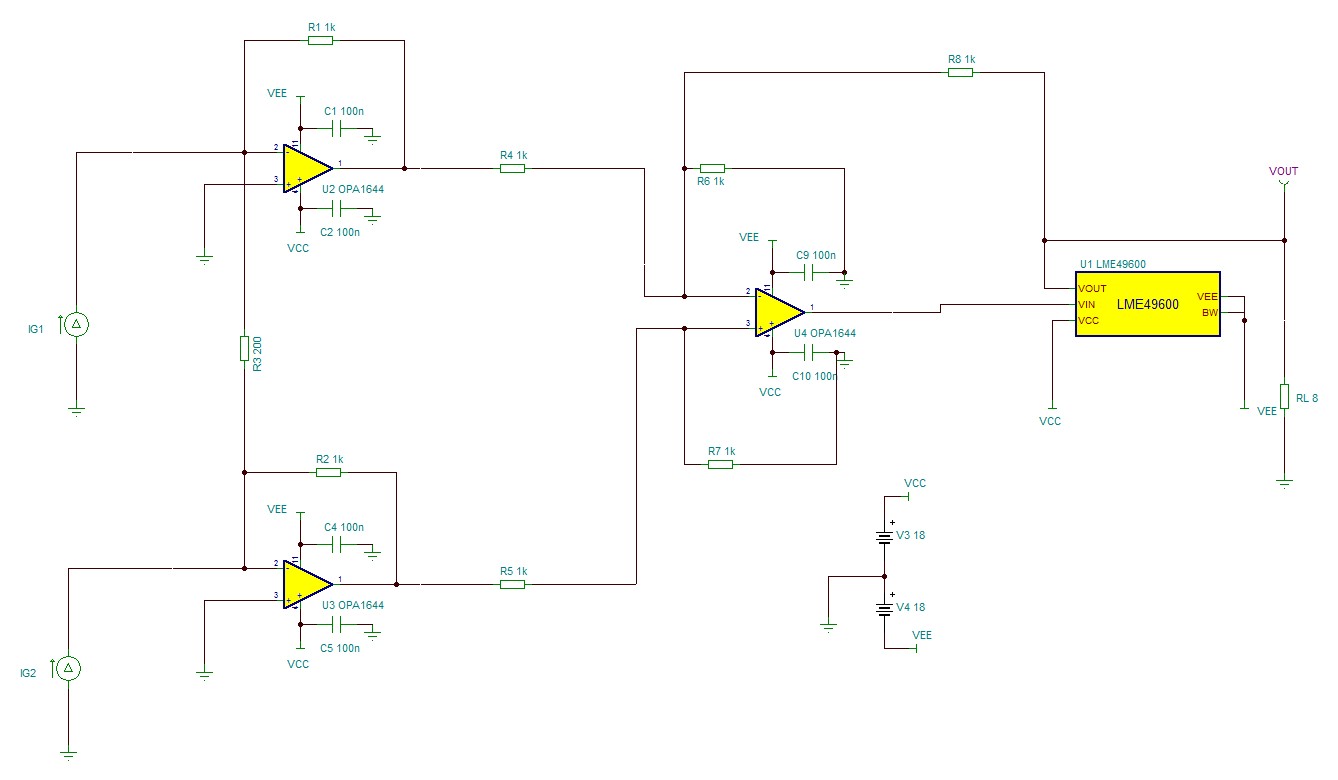

sch2 is a mess, I uploaded an "auto-save" TINA-TI made instead of the schematic I'm actually building.
As for R1&R2, I was trying to do some sims with tina-ti and it was giving me errors. It became quiet when I added those two resistors. Still, I couldn't run the sims. I was never good with sims. I manage basic stuff only with multisim. It seems to be the only app that understands me 🙂

PS: R3 is still there, hooked on the non-inverting inputs, for gain setting.

I wouldn't think you want that. It does cause xtalk and also decreases what is called noise gain, meaning the I>V doesn't work as accurate anymore. More like as if the opamp has much lower gain.

Hmm. Yes, indeed I wouldn't want that. I'm still on the build process, haven't tested anything so far.
How would you propose to do it to avoid such issues?

I decided to make them modular. One board with buffers, one I/V.
The buffer layout is already send to fabrication, I'm working on the I/V stage now. I will actually make both circuits that I posted and see in action what's what.
There is another modularity, I'm making adapters for the I/V board so I can change on the fly opamps.
