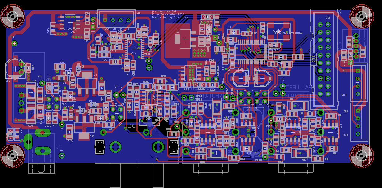

I'm trying to build a DAC using the PCM1792A chip. I have the first revision working, and I'm using OPA1632 for the I/V stage. I basically copied Twisted Pear's IVY design but with SMT components (this project is for personal usage only and will be released as open-source for anyone interested in this work).
Everything works and sounds good as far as I can tell (haven't had a chance to measure it - couldn't get RMAA to work on my Vmware since I'm using a Mac). I tried looking for oscillations using a 100MHz Rigol scope but couldn't see anything obvious. All opamps get hot enough that touching them for more than a few seconds is not possible. I tried adding cheap 1nF ceramic capacitors in parallel with the feedback resistors R1/R2/R17/R18 but there was no noticeable difference in temperature. They also get hot even without anything coming out of the DAC.
Any idea where to go from here? Is it possible that an SO-08 package was just a poor choice?
These are 180MHz parts, so oscillation is a real possibility.
Did you follow the power supply/layout guidelines, and also use 10nF bypasses?
I would build a pcb with only the voltage supplies and one op amp, and troubleshoot from there.
The OPA1632 does run hot. You can calculate its idle power dissipation P = I * V, where I is the quiescent current and V is the rail-rail supply voltage.
If you're running +-15V rails, consider reducing it to +-12V or even +-10V, and it will still have enough output voltage swing for line out purposes, and it will run much cooler.
I do use 10nF bypass capacitors, but my layout is not a 1:1 match to their recommended layout.

I just realised that your OP is not soldered to the PCB ground, which could explain the high running temp... so you may not have the oscillation problems after all. As I mentioned already, to be sure, insert a resistor in each supply line and then measure the voltage drops.

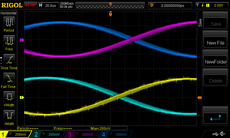

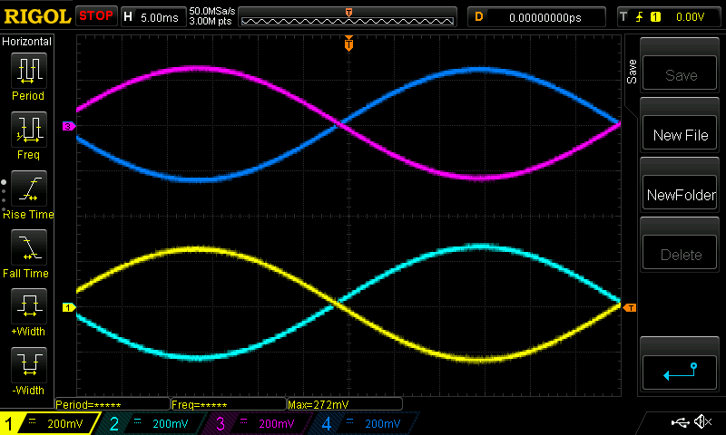

I got the Bink test CD and made some measurements. It looks mostly clean, but I did manage to catch something weird on one of the channels. The blue/purple are +/- of one channel, and the cyan/yellow are the +/- of the other channel.
Are these tiny spikes on the yellow channel the mess I am looking for?

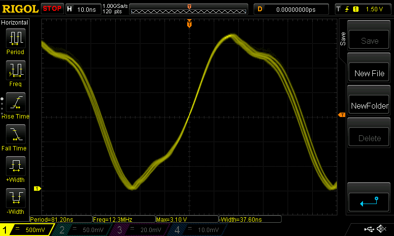

Unrelated, but my MCK signal looks terrible 🙁 anything I can/should do about that?

In the I/V stages, OPA1632's Vocm pins looks problematic.The Vocm pin set *output* common voltage.+- input pins are virtual-shorted each other, but not to Vocm.PCM1792A output "sources" (↔sink) 6.2mA at digital silence.So OPA1632's +- input pins potential will be 0V+750Ω*6.2mA=4.65V which exceeds PCM1792A's limitation, or even its supply voltage, it must be clamp protected somehow.
I don't know where your waveform probed, but I can't see why, how your DAC runs in such a condition.The solution is to set Vocm pin -4.65V or sink common 6.2mA with CCS.
Why do you think it exceeds it's limitation? It's analog supply voltage is +5V. Waveforms were probed on the PL connectors - so at the end of the signal chain.
Oh, I remembered the supply is 3.3V.Then it is inside of rail voltage.Although that, I recommend the node voltage to be 0V or so as nominal condition in the datasheet. When the node voltage is 4.65V , internal "current segments" (CCSs and switches) comprised of Pch MOSFETs are running low Vds and may affect switching characteristics - it may be the cause of the glitches in your waveforms.
