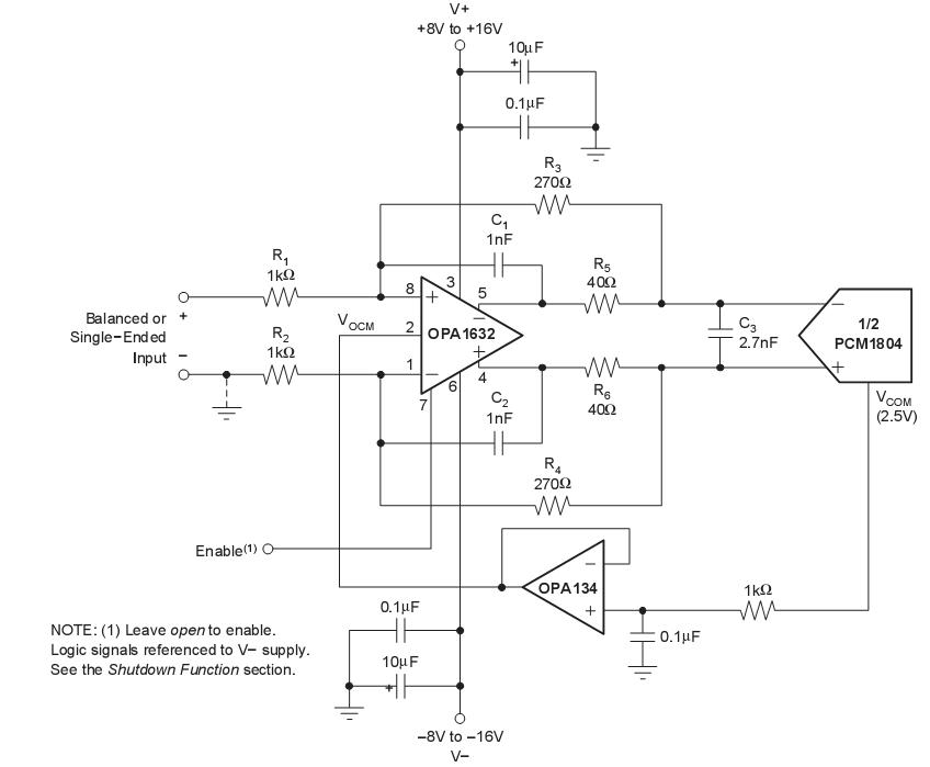

Hello, I am designing an ADC input stage for the PCM1804, usign the OPA1632 differential opamp. Reading the opamp's datahseet, I found a recommended circuit for this implementation (see attachment). The question is: is it necessary to buffer the VCOM pin of the A/D, or can I connect it directly to the Vocm pin of the opamp (perhaps through an RC filter)? Thanks a lot.
Diego.
Thanks for your answer. I noticed the lack of information regarding the output impedance of the Vocm pin, but the input impedance of the VCOM pin of the opamp is 34Meg, according to the datasheet.
I'll follow your suggestion and try both circuits.
