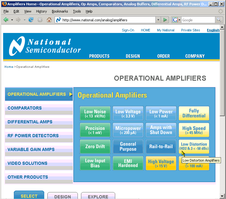

Because there are great opamps for anything!
Made to be Specialized.
All Opamps manufacturers has got some Design Selection guides.
Here is the Operational Amplifiers Selector Wizard at www.national.com
http://www.national.com/analog/amplifiers
See my Attachment Screenshot!
Lineup Opamps Advice for Free

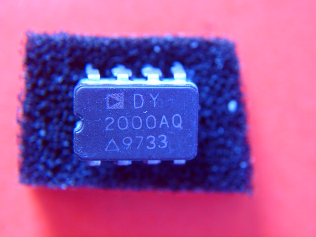

Dy2000

Hi, I think that DY2000 is a rebadged part.
The AD logo is reproduced poorly and an other part# is still vaguely visible.
The date code suggests week 33 of the year 1997, pretty old.
Absolutely nothing to find on the AD site
www.analog.com
I am not surprised as the Zhaolu with this chip comes from.........China.
