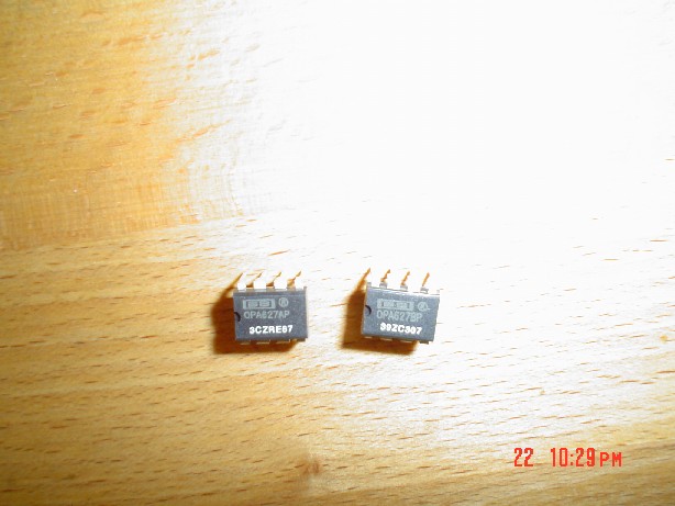

hI,
I am just looking for thoughts on my upgrade of my system going from ad712 opamps to either opa2134 or 2 opa627. Is there a big difference in sound quality through these two?
(I already have 4 of each so cost is not a big deal, although finding the right adapter might be.

Assuming that the AD712 and OPA2134 are both DIP
packages, the OPA2134 should drop in without an adaptor.
That makes it quick.

The GBW and Slew Rate of the 627 is higher than that of the 2134 (GBW of 16mhz versus 8, and a Slew Rate of 55 V/us versus 10). Furthermore, the noise performance of the 627 is about 50% better than the 2134.
I would say that if you want a quick drop in replacement to try out the Burr Brown/TI sound, pop in the 2134. If you would like to see what BB's best chips have to offer, get a browndog single-to-dual opamp adapter.
In my personal opinion, the 2134 is pretty mediocre, while the 627 sounds really nice. I can't spew audiophile words over it, just that the 627 sounds a lot better to my ears and there's really no comparison. This seems to be inline with most folks opinions on those two opamps. (And even against the "better" version fo the 134/2134, the 132/2132)
The brown dog adapters can be purchased here:

I have just had a good look through the 627 datasheet. I was reffering to the OP 27 when I said the 2134 is better. The 2134 is not as bad as someone said here, it just likes good bypassing, etc, to work well.
The 627 could well be a better sounding device. But you will need an adapter if you replace a 5532 or any dual opamp. I am interested how your experiment works out, I may get some of these 627's myself..

Thanks for all the great advice and opinions. Today I installed an 8pin dip adapter into my Parasound preamp so I can swap opamps out easily and quickly. I tested the opa2134 vs the ad712 that were stock. (Opa2134 is not broken in at all, so it will most likely get better w/time) The base is much better from the 2134, but it does not seem to be as powerful on the output side, but could just be the break-in needed.
I plan to get the brown dog adapters and try the opa 627's soon. I will update this page in a week or two when they're in.
