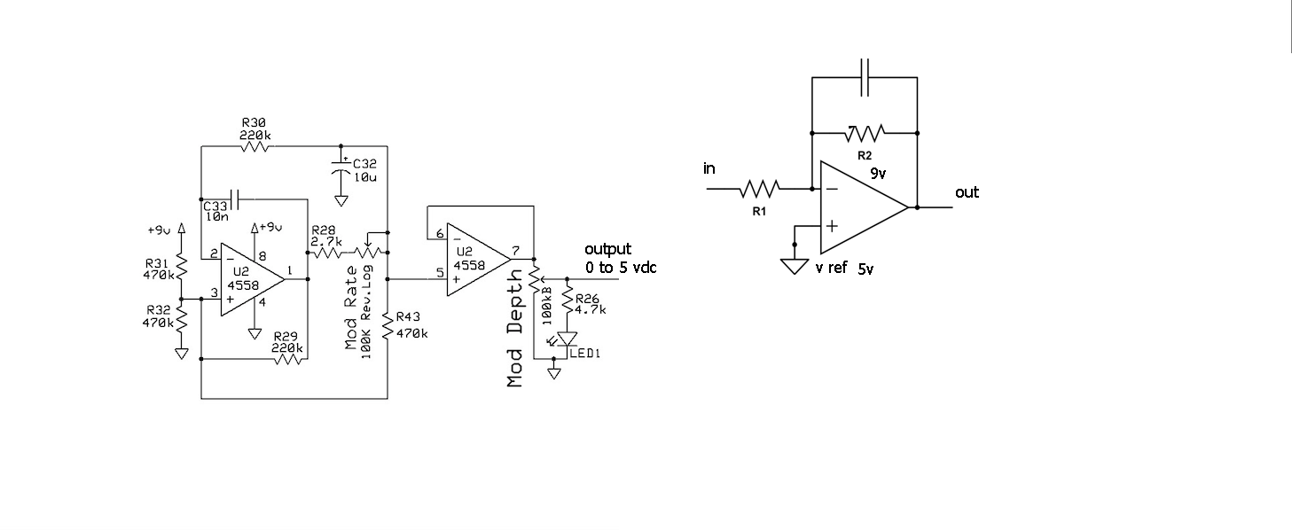

looking for a way to use this lfo as trem on this op set up.

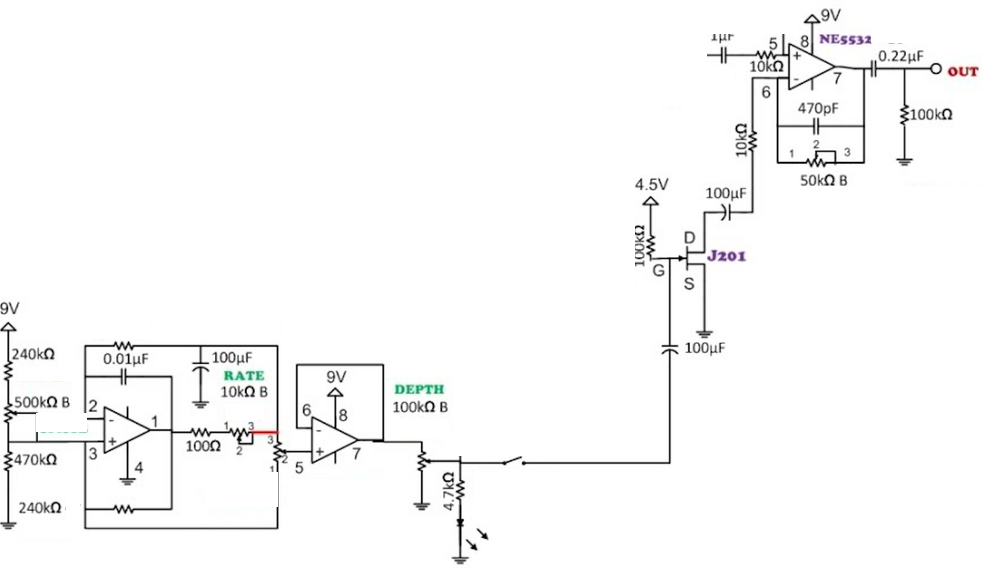

lfo puts out 0 to 5vdc. am wanting to use maybe a fet or transistor in between some how just not sure how to do it. i have found similar circuits (see 2nd pic) but they are for non inverting. Not sure how to adapt to inverting op
any advice or drawings, links would be great thanks
