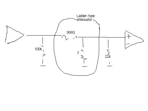

Let's say:
Op amp output=>100k ohm parallel/grounding resistor => 9993 ohm series resistor Rx => 7 ohm parallel/grounding resistor Ry => 22K ohm input parallel/grounding resistor for LM1875 => the + input of LM1875
The 9993 ohm series resistor Rx and the 7 ohm grounding resistor Ry are taken from Step No. 4 (Attenuation = 63 dB, a random choice) of a 24-step 10k ladder type attenuator, calculated from here:
http://homepages.tcp.co.uk/~nroberts/atten.html
If the calculator for the ladder-type attenuator is correct, isn't it true that the 7ohm Ry would make the load resistance for the op amp around 6.99ohm (100k, 7, and 22k parallel), which is very low? The values of Ry also varies greatly throughout the 24 steps. Why do people say that a ladder-type attenuator gives a constant load to the source? And what is the input resistance LM1875 sees in this set up, 22k ohm or 6.99 ohm? Thanks!
I told you to draw yourself a diagram.
The 10k stepped attenuator has two legs the high resistance leg is in series with the signal line the low resistance leg goes to ground.
LOOK at it.
LOOK at it.

Yes, the low resistance one is the 7 ohm grounding resistor Ry I am talking about (each step in a ladder-type attenuator is constructed with one series resistor and one parallel resistor, am I right?) And this resistor is in parallel with the 100k at the op amp output and the 22k at LM1875's input. Is there something I am missing? I am really confused now.
the 7r0 is parallel to the 22k.
The resistance of this // pair is 6r998
The series resistor adds 9993r to this, giving 9999r998.
The next parallel pair are 100k//9999r998 giving 9090r907
Notice that you have 7r and 22k and 100k and the 10k attenuator and the impedance seen by the source is within 10% of 10k.
You have omitted the series resistor in the source and omitted the series resistor in the power amp (receiver) input.
You have also omitted the input filters. These all have an effect, but again if they are chosen well will alter the 10k only slightly.
Now change that 100k in the source to 2M2 and see what you get with all the filters and resistors in place.
That is the case looking from the source into it's load.
You need to repeat the whole process looking from the receiver input back through the string of components to see the source resistance presented to the input.
You will find it is dominated by the 7r0.
We can talk about the effect that this variable (stepped) resistor has on the receiver once you understand the simple parts.

I got it. And changing the 100k to 2m2 will make the impedance seen by the source much closer to 10k (2m2//9999r998). Thanks.
Yes, I omitted the filter cap and other series resistors for a simpler graph.
From the receiver's point, it would be
(100k+9993)//7//22k, am I right? And it would vary when other steps in the attenuator are chosen.
no.mudihan said:From the receiver's point, it would be
You must put in all the missing components.
Rs of the source is absolutely crucial to this source impedance, particularly at low attenuation settings.
Rs' =[(((Rs//100k) + 9993r)//7r//100k//22k) + Rfilter].
If both 100k become 2M2, you can virtually ignore them in these low impedance interconnections.
And when you look at the attenuator in detail you will find that the designer forgot, or chose to ignore, the effect that Load impedance has on the published settings.
22kZin and a 10kpot are particularly bad. 100kZin and 10kpot are much better. But better still, the designer should specify what load impedance is required to achieve his declared attenuator settings.
