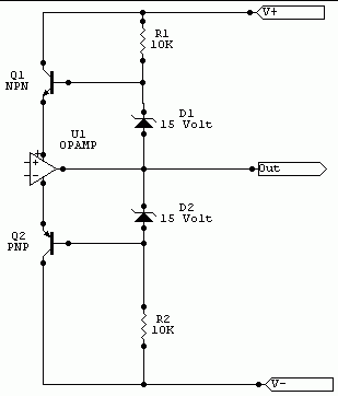

this is a basic bootstraped op amp. you must be sure your chosen device is free from phase reversal if the Input is overdriven as this will cause seriose damage to this circuit is that happens. Most modern op amps meet this requirement however some older FET input Op amps are prone to this. check data sheet.

peranders> Hi glad you droped in. The alxender circuit was intended only as an illistration of the Bootstraped Technique i talked about. I was not intending to indicate it was any Kind of sonic marval.
I have used Just plain BUF-634 Buffers Bootstraped to High Voltage transistors to follow a tube output stage in a topology similar to my posted op amp schematic above with splendid results. sure true Tube-O-Files could detect the solid state eliment in the sound But over all no one complained about the sound and alot of local Tube Equipment owners have since adopted this technique into there equipment in order to gain low impedance drive for stuff like Headphones.
