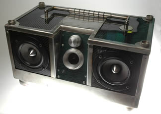

I've been building a boombox around a pair of SI boards (one will power external speakers if needed). Starting to sound pretty good, but I find that when I go through a preamp I get louder sound and perhaps a bit more richness, especially running off a portable CD player.
I can flip a switch and the thing will run on either a 12v SLA or one of those 14v monitor SMPS that have been on eBay.
I'd like to build in a low-gain preamp/buffer using an op-amp such as the OPA 134 or whatever will give me decent sound and a few dB gain. There is a circuit shown on a current Charlize thread (the one used in the Decibel Dungeon Propod) seems to be on the right track, but details about power connection are missing, and the OPA 134 seems to want a dual supply.
Most of what I've read says that op-amps just aren't at their best w/o a dual-rail supply, although I know there are single-supply versions out there. Would it make any kind of sense to use a DC-DC converter (15V+ to 5-12v + and - ?), or would that just add trouble?
I'm a much better metalworker than I am a circuit designer, so I need something with a complete circuit, no loose details to wrap up, although I am not really looking for a kit or even a pre-etched board. I've been searching all over and haven't been able to come up with something that's perfect for my application, although I feel it is probably right under my nose. Anybody solved this problem before?

Can't help much on your problem, other than by mentioning that there are "rail splitter" chips available that create +/- rails w. a middle ground. The TLE2426 is one. They're used quite a bit in headphone amps. Don't know if the virtual ground would create problems though.
Mainly, I wanted to say:
DAMN that is a nice boombox! There's nothing as cool as custom .

You can run most opamps single rail, no big deal. You will need a DC blocking cap on the output. About 2uF, minimum.
Have a look at these headphone amps. Any of the single rail type will work as your preamp. Or you can split the rail if need be.

I've gone through a lot of trouble with solutions that ought to have worked--as I said I'm a better metalsmith than an electronics guy.
I tried Greg Ball's GB-BX bass extender. This was absolutely what I wanted in there, but after a lot of work with him, and a lot of soldering and fiddling, we never could get it running on a 12v single rail, so it went back to Australia.
I also worked with one of the CMOY amp guys on eBay and he customized an amp (2 x 2227P) for my purposes. When I plugged it into the box's power supply, I got a lot of dangerous cone movement along with some coarse hissing/whooshing and a little audio. There were blocking caps between it and the t-amp. He eventually got tired of me asking silly questions and stopped answering my email. Sounds great with headphones, though.
So I'm gun-shy of the whole thing and am looking for a circuit diagram beyond the usual app sheet ones where they assume you know how to finish the loose sketches.
As for the cool-looking box, it's actually made of fiberglas-carbon fiber-nomex honeycomb core aircraft panel. Molto rigid. Welded all the stainless, turned the knobs, feet and flared port, which now has the power LED in the center of it. I've got a hi-tech battery conditioner in there, and a regulated 5v USB port on the back to recharge the iPod, lots of other goodies. One of those projects you just keep piling on, out of control, really.
--Buckapound

My questions would be this:
Why the preamp?
Do you really need the extra gain stage? The SI boards have a higher than unity gain, just right for most low output portable sources.
Your cable run to the amp is short, right? You don't really need a buffer to push the signal down a long cable.
The input stage of the Tripath chip IS an opamp. If your cables are short and gain is enough, why bother with a preamp? You can usually drive the SI into clipping with a portable CD/MP3 player. What more do you need?
Why the preamp?
Oh, I don't know, Panomaniac, I'm just a fool for complicating everything--kind of my approach to art projects like this.
Seriously, the iPod provides a decent poutput line level. However, I do plan to run two SI boards in the box, so I'm splitting the signal in half, and I assume that will cut the input level to each board somewhat. Is that correct, or can I ignore this?
Probably a bigger concern is the CD player. As far as I've been able to find, there is no available decent portable CD player with a line out available these days. To my ears, the Sony I'm using sounds better when its output isn't near full volume, which means the signal level is pretty low. I just picked up a PlayStation 1 to rebox into a real CD player, but it seems a lot of reengineering would be required to make it run on battery power, so that's a long way off for me.
Plus I'd just like to get a better handle on the op-amp thing as a learning experience, and maybe use it as the basis of a little more complex equalizing to get the TB 4" Bamboos sounding their best in this small and crowded box. Like I said the Greg Ball GB-BX what was what got me thinking along these lines in the first place.
