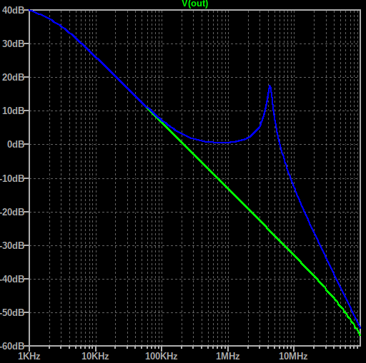

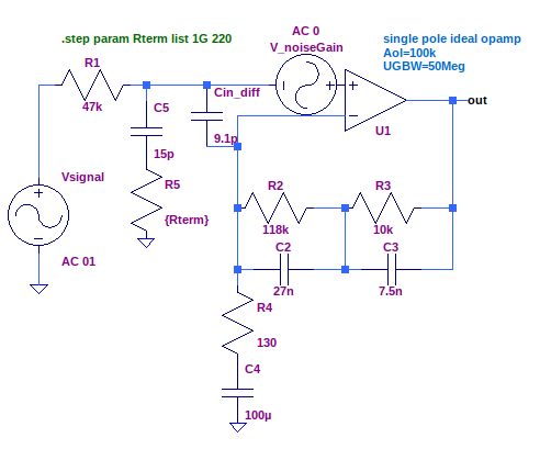

Quick sim to illustrate the above, using datasheet spec of Cin_diff of 9.1pF for OPA1656:
So, when the unterminated cable had an impedance peak in the region around 4Mhz that is near or even above the 47k local resistor the circuit might oscillate.

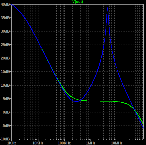

Alternate view from noise gain perspective:
Without the "terminator", the noise gain explodes to 40dB. With the "terminator", it is reduced to the gain coming from the capacitance ratio (15p+9.1p)/15p = ~4dB.
Only at very high frequencies (>100Mhz) the 220R resistor causes a rise of noise gain again as it then starts to dominate the lower leg of the divider.

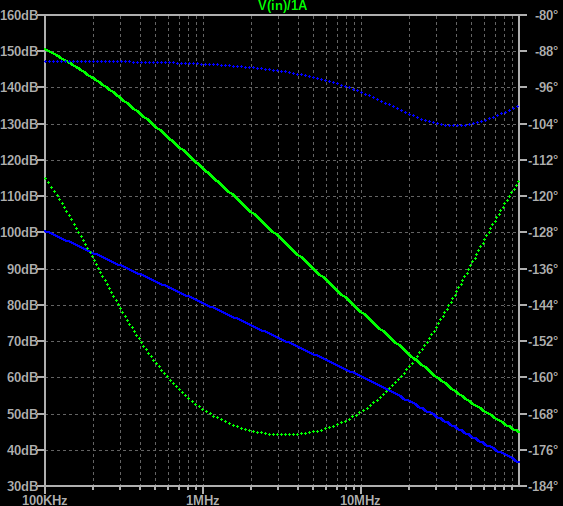

Input impedance, with no shunt capacitance (green) vs 15pF (blue), and no parallel 47k:
Without the shunt the input impedance slope is second order and phase peaks near 180deg around the problem frequency, so effectively negative.

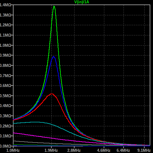

Alternate look at it, with the load resistor in place, and 200k (4x) this time, and stepping the shunt capacitance .01f 33f 100f 330f 1p 3p 10p 33p:
Frequency has halved and we see the negative'ish input impedance is pretty much cancelling the 200k completely.
