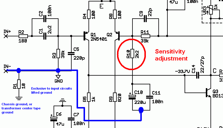

Can you verify your claim here? LM324 works in class B this is a fact but regular high performance opamps work in class AB and class A for normal loads.Nico Ras said:Op-amps are not designed for audio use exclusively and therefor not just a question of inserting some gain block into the system. Most op-amps operate in class B
List all op amps available from all manufacturers that runs in class B, then compare them to a list of all that run AB mode and count them, then you can be the first to verify this.
I see this on your site? "Maybe circuit for class A biasing of the opamp outputs."
