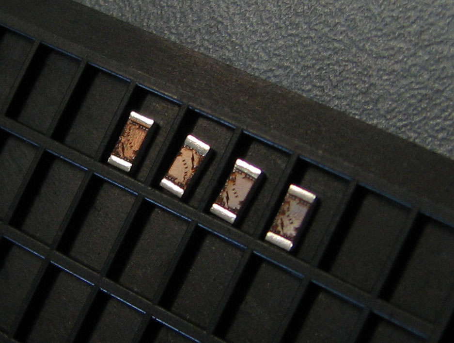

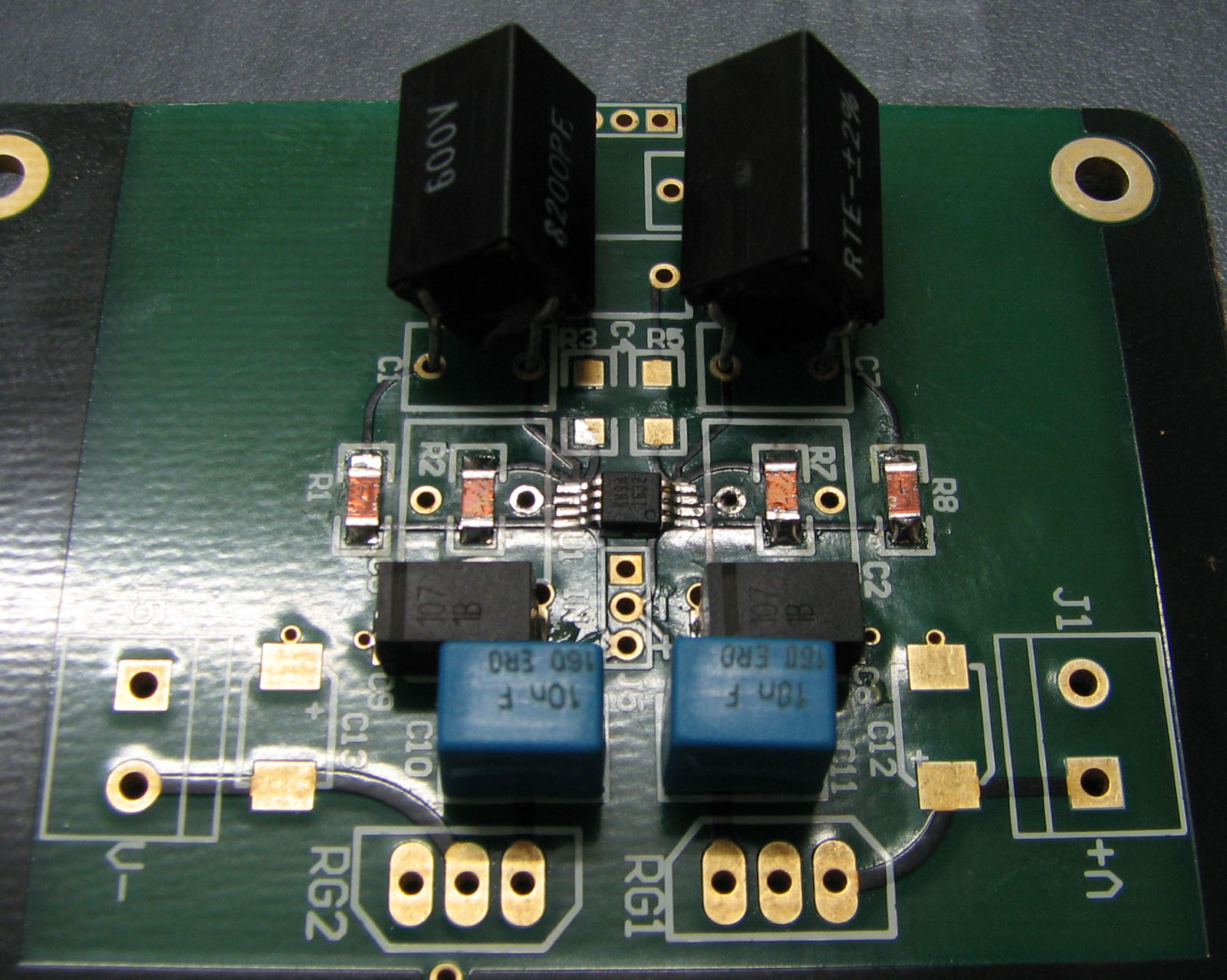

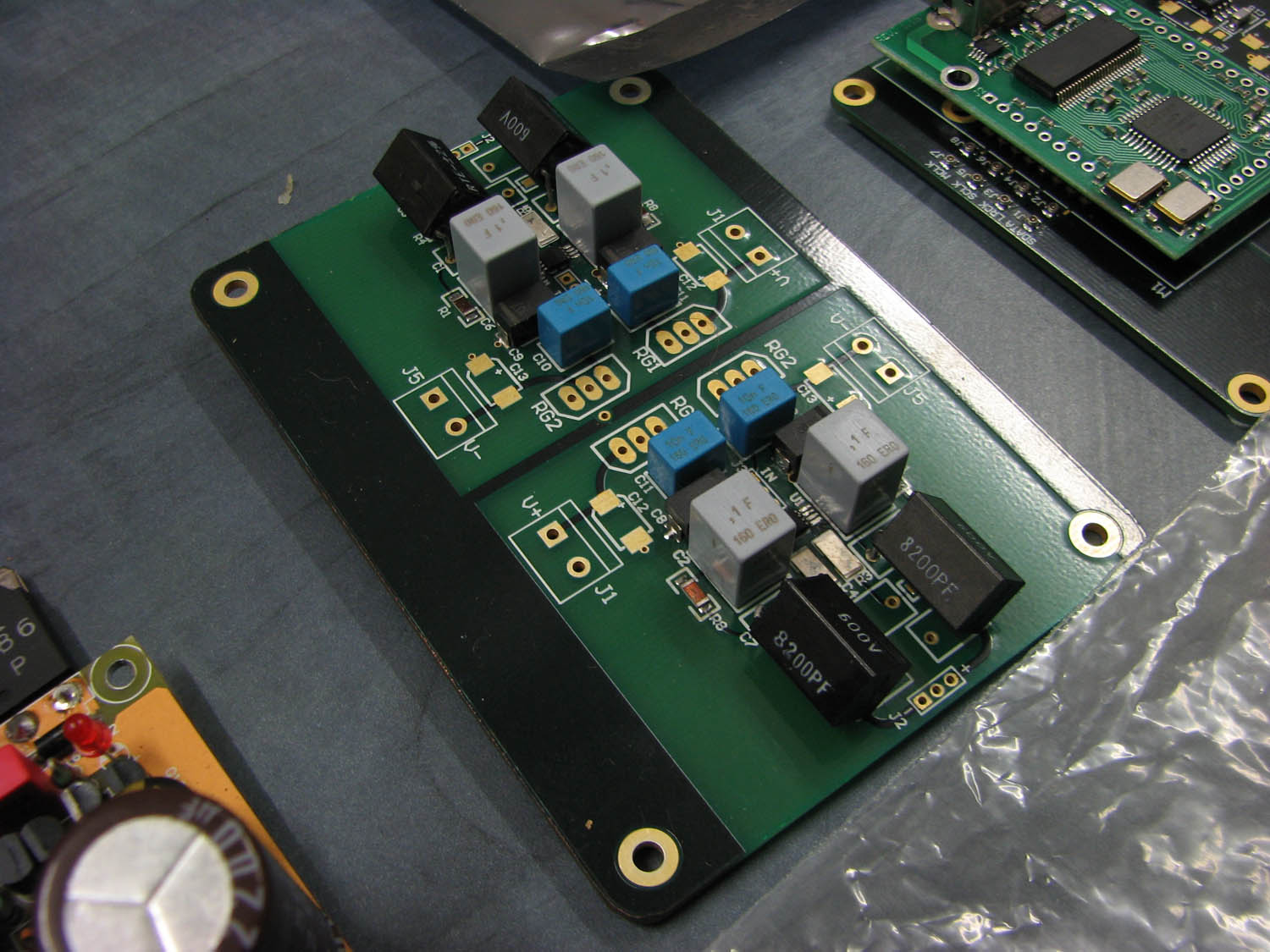

like this iv stage with gain i'm using in my portable dac/headamp, using +/-13vdc from lifepo4 battery pack to power these 2 opa1632dgn, with powerPAD it will output enough current without buffer.
still a very simple circuit, i went a bit crazy with parts selection, but the only cap in the signal path in the whole build is those relcap RTE polystyrenes to filter hf junk; the others are for decoupling the supply. there is another set of resistors underneath the vishay mkp1837 box caps, so there is multiple feedback, one for gain and one for filter. i omitted the output filter to keep damping high as possible
this is not my desig, its an early ackodac iv stage that i have modified to suit my purposes; these SuSy chips sound very well indeed and while the smd zfoils are not as fiddly as i thought, i sure needed a stiff drink before hand
