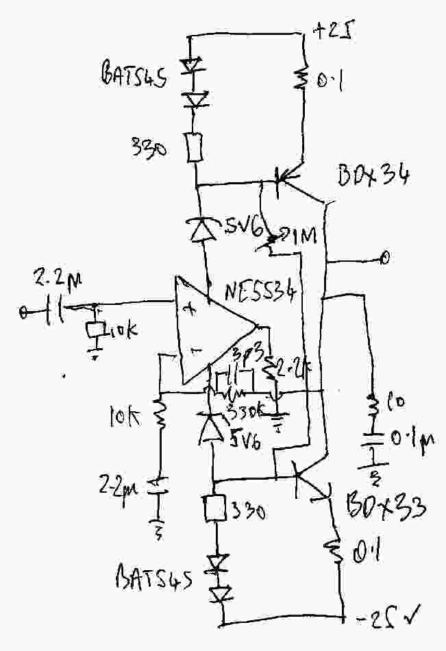

Hi.
I have a few BDW83A/84A power Darlingtons.
Can I use a pair as outputs driven by an op-amp ?
Ultimate hi-fi not required, just a reasonable sound.
Power supply about 35-0-35 (with regulators for the opamp)
What output power can I expect into 4ohm.
Thanks.
Andy

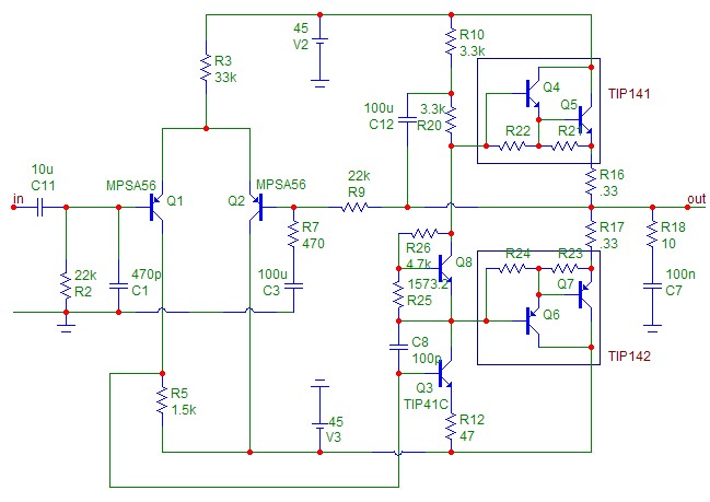

Here is a sketch of a circuit I modelled but did not get around to building. The problem with it is thermal tracking of the quiescent currents. The tracking with dual schottky diodes did not work very well (in spice) so I tried an NTC thermistor which theoretically could do the job. The pot is to set the quiescent current.

The problem with using an opamp frontend is that you are limited by the supply rails of the amp, unless you configure the output stage to have some voltage gain. This has a habit of being unstable.
It's a much better idea to use a discrete front end, in this case.

Hi Sakis,
There it should work ok now. I did not like the diodes setting the quescient current and replaced with VBE multiplier. Also changed the VAS emitter resistor to 47 ohm which seemed to balance the current flowing in each output.

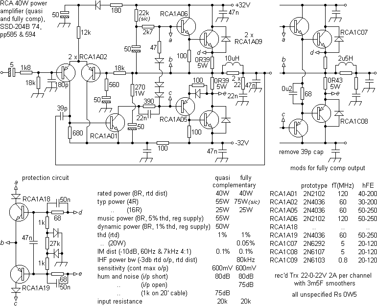

Various topologies can be seen here :
http://www.angelfire.com/sd/paulkemble/sound5.html
The oldest I can see using similiar topology is 40W from 1974 RCA.
It uses resistor for feeding differential pair, PNP differential pair without degeneration, NPN VAS, bootstrapped VAS load. Output stage is can be made of darlington and quasi complementary.
30W Bailey topology also uses this bootstrap for loading VAS, but the input is singleton, not differential.

I think the low risk approach is to use the devices in a K8060 clone as the devices seem a good substitute for the TIP142/147.
The K8060 design has frequency compensation capacitors liberally sprinkled over it which is not a good sign but it obviously works.
You have the suffix A which means low voltage so I would limit the supplies to 25-0-25.
Jaycee The zener diodes in my circuit can be altered to suit any supply,
but since I have not built it, I hesitate to recommend it. The main issue would be thermal runaway.
