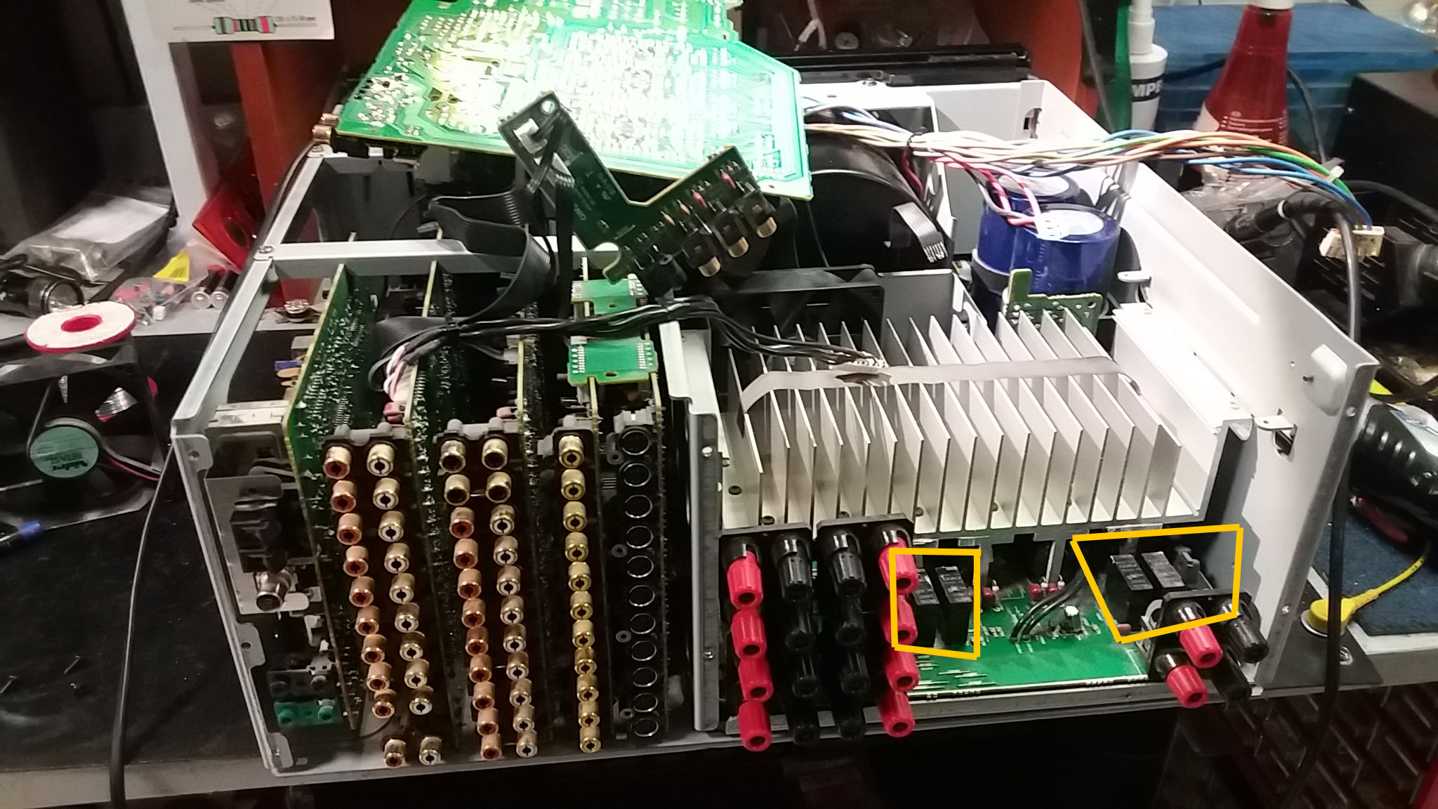

I see 3 relays. First one connects ac line, its smaller. Next to small yellow trafo.
Then close to speaker outputs are two other, one says 12V DC.
Usually they are directly behind the speaker sockets. Agree the service manual is not a lot of use when it comes to the layout except the block diagram does label them.

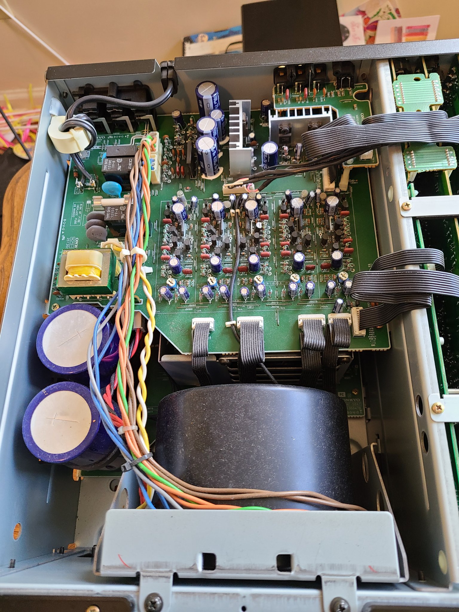

Attached pic shows speaker relays on the ground floor, cant see what boards were on top.
As the manual shows separate relays for the A&B outputs the problem may be with the amp. Check that white connector with the pink and white wires is seated correctly. Also check none of them have become detached. Check the vertical black ribbon cable at the bottom right of the board it does not look to be seated correctly.
That black cable actually seems loose. How do you release the cable so I can reseat it. My eyes aren't great and don't want to force anything. ThxUsually they are directly behind the speaker sockets. Agree the service manual is not a lot of use when it comes to the layout except the block diagram does label them.

If your eyesight is not great don't fiddle with the mains lead plugged in. There is a live cable and exposed fuse holder at the top of that board.
The black cable has a clip that is held at each end, you may need a magnifier and then a small screwdriver. Release the clip at both ends, push the cable back tight and pop the clip back on.

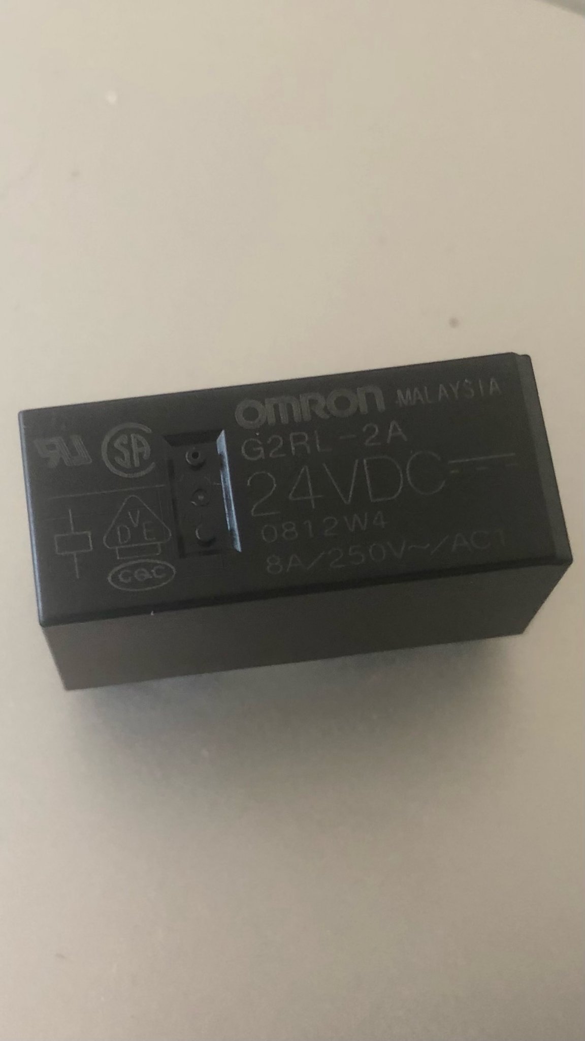

Thank you guys for the help. I successfully replaced it.
For all the others out there that may be looking for a fitting replacement:
Left one is the original and the right one is the one i replaced it with: OMRON G2RL-2A-24VDC.

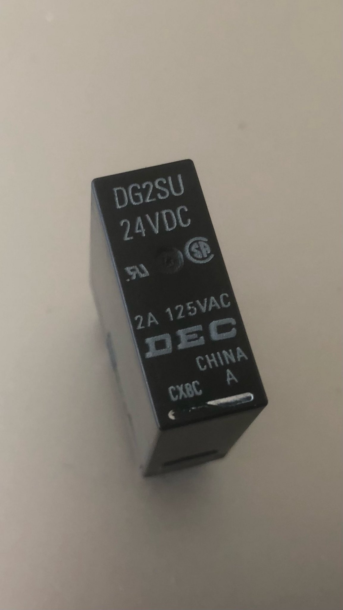

Interestingly the original is an "DEC DG2SU 24VDC". That label differs from the Service Manual and they can still actually be found. I should have looked inside the TX-DS 939 first but the repair went well with the Omron and I am happy.

The original relays are underrated with only 2A contacts (and probably wrong contact material). The Omron G2RL-2A-DC24 is better and has silver alloy contacts. Still a 10 or even 16A version would have been possible too. Sanding/cleaning the old relays contacts is wrong practice and futile just like replacing the old relay for exactly the same "original" 2A type. Apparently the choice was based on cost cutting decisions at Onkyo.
Just make sure to choose the fully sealed version of the relay (the ones with resin at the bottom), that pays off as no dust/dirt/moist can enter the relay. Chances are likely it will practically never need replacement in the future then.
Tip: defective underrated relays can have intermittent issues that are annoying and urge the owner to do something directly but they may also exhibit hardly noticeable too high contact resistance or even diode like properties creating distortion. As they are on their way out anyway always replace them in both (or all) channels.
