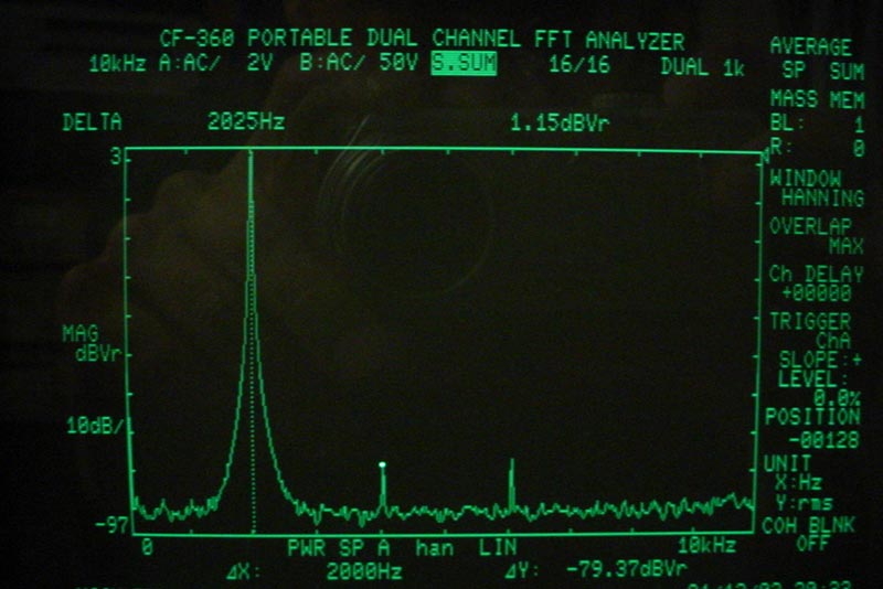

Used a Ono Sokki 350 and a 360 for some time .... liked it. Useable dynamic range is about 80+dB.
Used both for many years. The 350 goes up to 40KHz, the 360 to 100KHz and has a build in Generator.
Replaced it with an R&S UPL. But the 350 is still in use and works flawless.
See attached a measurement with the 360 on a low distortion audiogenerator ... -80dB distortion nice and clear to see ...
