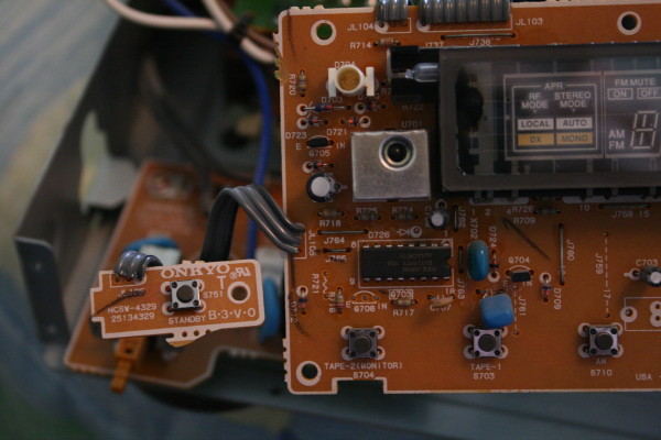

Onkyo TX-930 pics
Sorry I didn't see your post sooner......I'm not reciving the email notifications and I forgot to go look for replies.
Anyway, I've attached ONE picture.....I can't seem to meet the measly 102400 bytes size restriction if I put more than one picture in a zip. So I hope it's the one you need to see. If not, please let me know and I guess I can post each one separately.

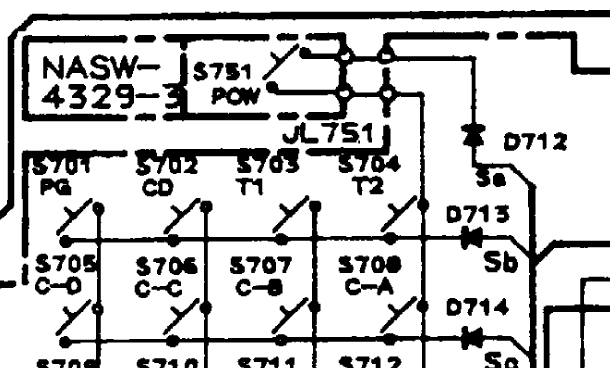

I also found the service manual here:
http://www.eserviceinfo.com/downloadsm/30342/Onkyo_TX-930.html
It says that it's a multi-part manual and there is a TX-930.part1.rar and a part2.rar.....but the part2.rar never opens and the pdf that extracts out of the part1.rar looks pretty complete to me.
The pic I'm guessing you need to see is of the main card with the little stand-by part that hangs off of it. I think I've got decent enough picture of it.
So, whatever guidance you can give me would be great.

I just downloaded the service manual.
Just read a little. . memory is 3 to 4 weeks. . .that is for settings. . .
could work for logic circuit. . .that is a long time to wait. . .
When the main power is on. . .the logic circuit is live. . .
Does the remote turn the unit on?
Might be a bad micro-switch. . .put a ohm meter on the terminals
with the plug unplugged. . . .put the button. . .the ohms should
change. . .

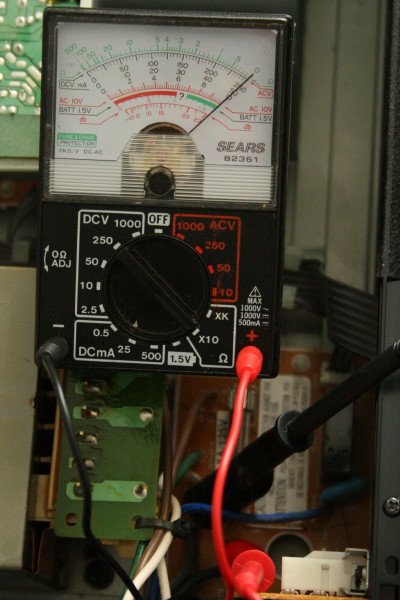

Hi Chris,
Thanks again. I hooked up my meter like you suggested. The Ohms do change when I press the main power switch. You can see in the attached photo.
The remote will NOT turn the unit on.
I assume by "Soft power on switch" you mean the itty-bitty stand-by board that hangs off the left side of the main board in my previous picture. I don't know of a way to test it and it doesn't just unplug, it's soldered on both ends of that ribbon cable. I also haven't found anywhere that I could order a replacement part so if you or someone else out there knows of a place, that'd be really swell to know too.
Was that picture I posted yesterday what you needed to see? Is there something else? I didn't think the board where the power cord comes in and the one fuse is located would help...nothing goes from that to the stand-by switch. Being an extreme novice on this sort of thing I obviously don't know the answer....but it seems to me like the bypassing might could be as simple as attaching a little wire from one side of the stand-by switch's soldered connection to the other side (on the same stand-by board). Only thing is there's three wires/connections in that cable.

Being stuck in standby could be anything. It could mean a fault with the microcontroller. It could be a power supply issue. It could be a protection circuit stopping the amp coming on if something is wrong.
I dont want to sound harsh, but really this is not the sort of problem you can fix without some experience. Sorry.

My original hope was a bad switch. . .but it is looking deeper
like a computer malfunction or the computer is seeing an
error else where and just won't let the unit fire up. . .
The switch is a momentary type switch. . .ohms should be
infinite when not pressed and 0 when pressed. . .make sure
the contacts are not just shorting via the leads. . .

If the unit was mine, I would:
A) attempt to bypass all the ICs and just use it as an amp. . .
or
B) salvage the working power supply parts and make a chip amp
or an Aussie Amp. . .
I'm sorry for my bad news approach. . .but ICs and logic circuits
are generally not repairable and require board swapping. . .
I'll be the amp section is still good. . . .
