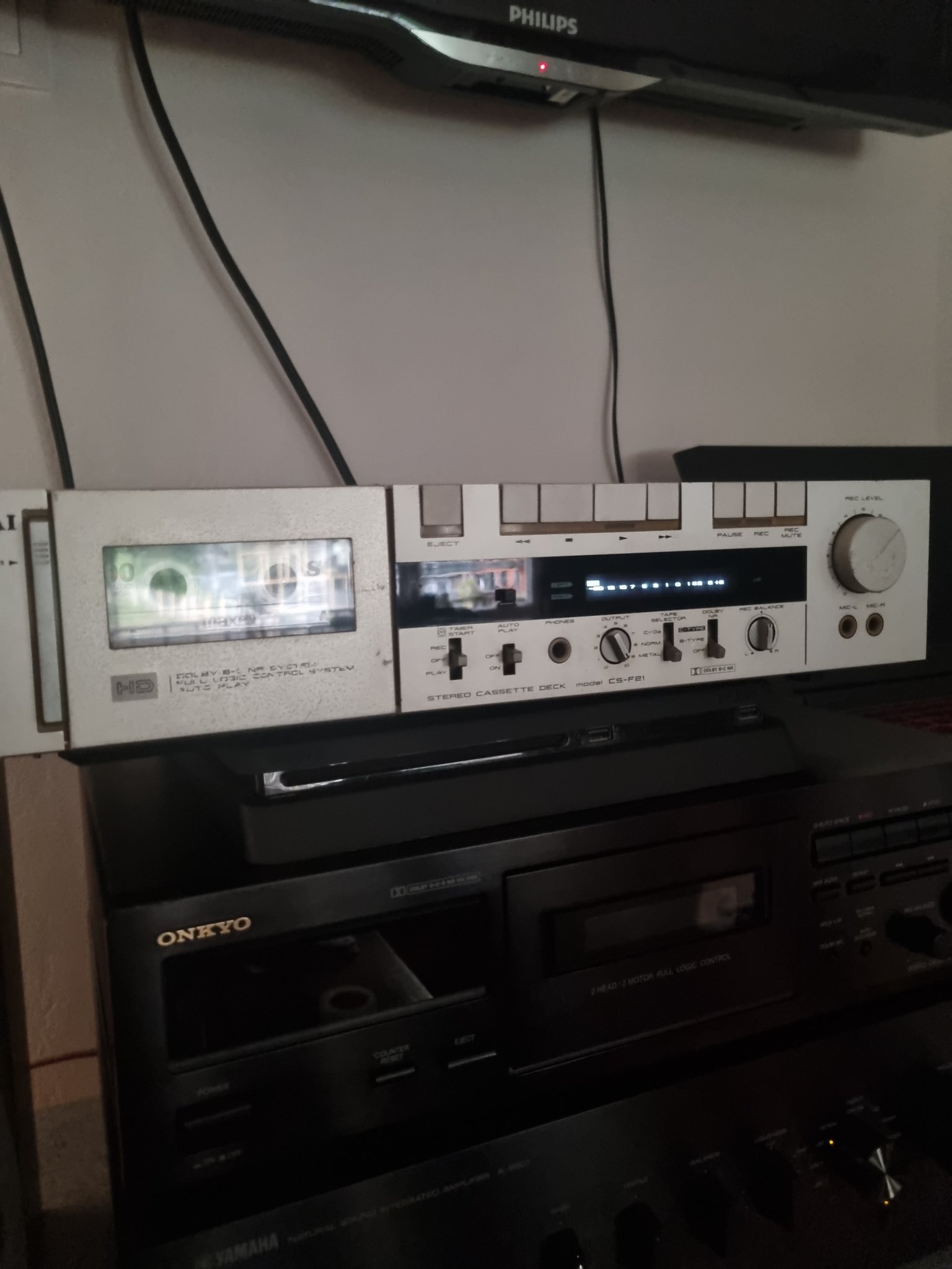

I hacked my old Akai to the state I can rec and play....
Onkyo's capstan is too slow. What I recorded with Onkyo plays way too fast on Akai and vice versa.
This poor thing has outlived my dad, been used by him on gigs back in 80s, been abused alot by me when I was a kid, been trown around, has moisture damage, jumpers instead of play/rec switch, it doesn't rewind or fastforward due to bad electro magnet and still manages to outpreform the Onkyo.

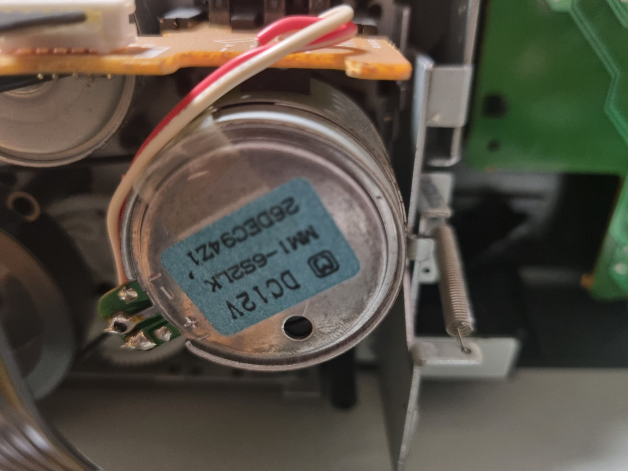

That needs looking into because it could also be part of other issues. You would have to look what type of capstan motor is fitted, all have some kind of electronic speed control but how that is achieved varies. Some use an FG (frequency generator) pickup and set the speed with comparison to a an accurate internally generated reference. More common are motors that use back EMF sensing. All this motors normally have a speed adjustment trimmer accessible via a hole in the back of the motor. Less common are unique motor designs applicable only to that recorder perhaps using brushless Hall Effect type motors.
You need to check things like the supply brakes are coming off correctly and that the back tension is correct (not easy without the correct jigs/cassettes).

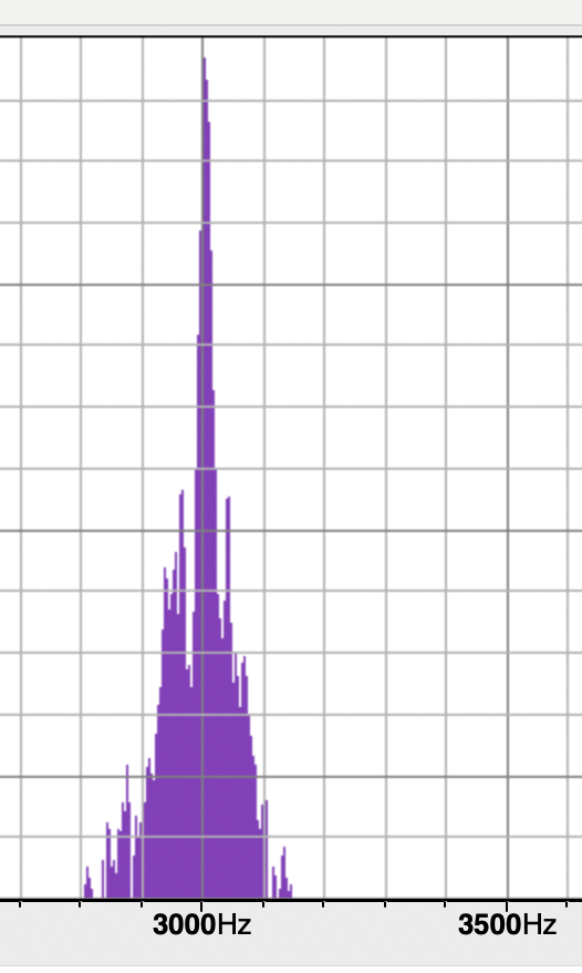

I zoomed in on the 3kHz peak, showing I think quite a lot of wow/flutter (aka phase noise):
Clear side lobes at +/- 40Hz, +/- 80Hz or so which isn't mains-related therefore, more likely the FM sidebands from the capstan being bent/worn?

I'm looking at the capstan and it doesn't look damaged, it is still shinny and it looks straight when spinning with no cassette... I guess visual confirmation isn't enough for such complex system is it?
There is probably a preset for speed setting behind that hole... be careful not to use a metal bladed driver as you can easily short that to the case... or at least be careful if you do use a small metal one. I think that motor might be one with an internal FG speed control rather than back emf sensing, it just has that look to it.
