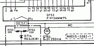

The display of the tuner doesn't display any more.
I measure about 14 V DC on the pins of the display.
As the tuner only has DC voltage levels of up to 18 V I suppose the supply voltage to the pins is all right.

The display runs at 3.2V from a seperate winding on the transformer, this winding also runs the light above the power switch.
In the attached partial schematic, the relevant lines I have highlighted in red.
Hope this helps

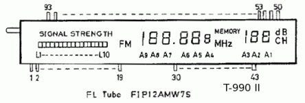

Great! It certainly helps. One of the supply pins didn't connect well. I resoldered and the display gave light!
The voltage across pins 1 and 36 is 3.04 V AC.
I can now see what frequency I tune to.
The display is however still rather dim. 2 elements light at a proper level, all the others are dim (I can see it when the tuner is searching).
What should I measure on the other pins?
