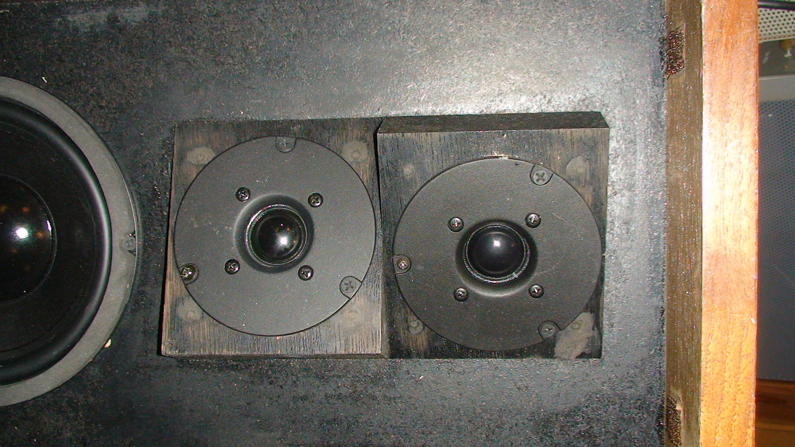

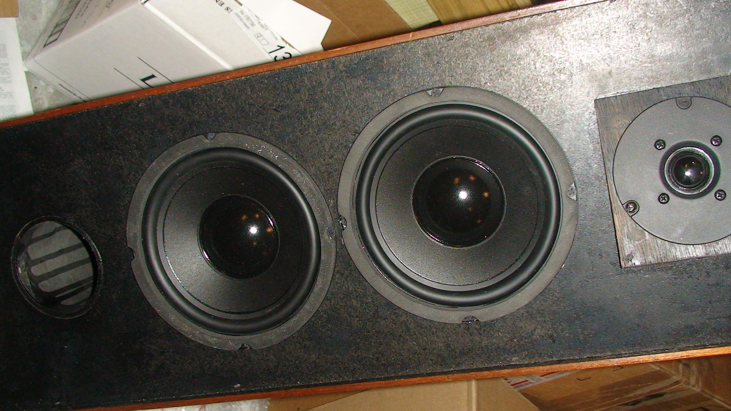

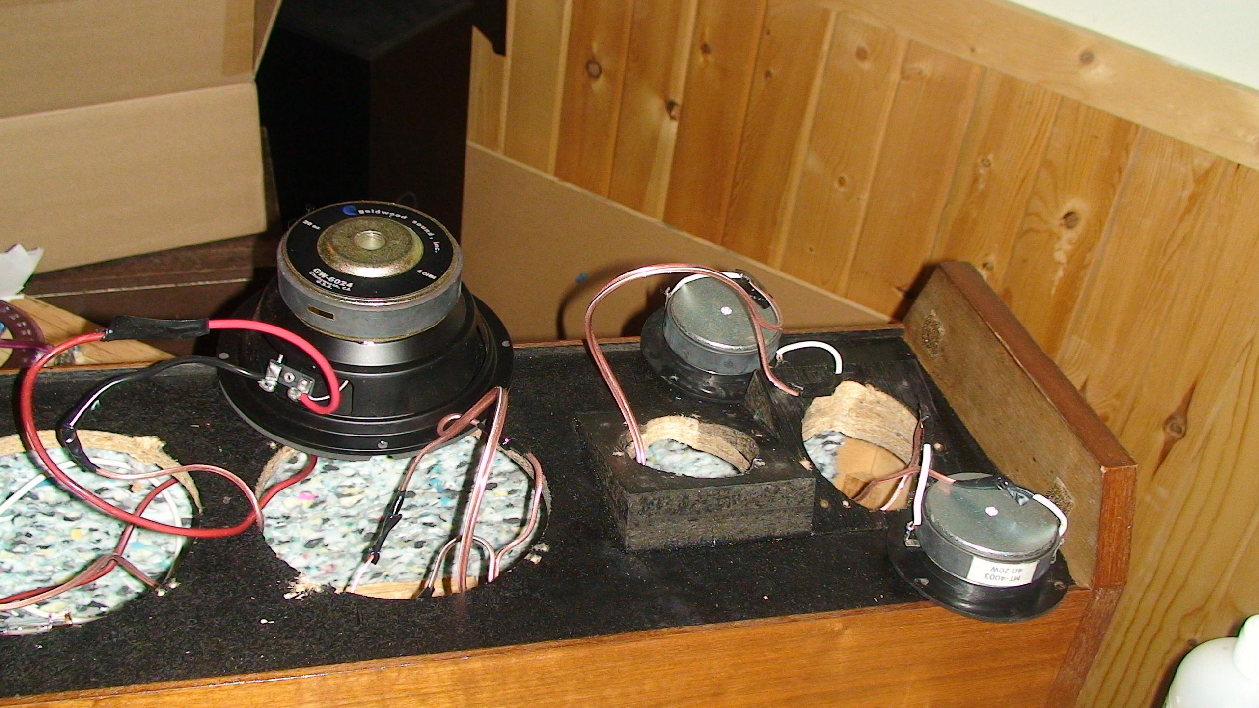

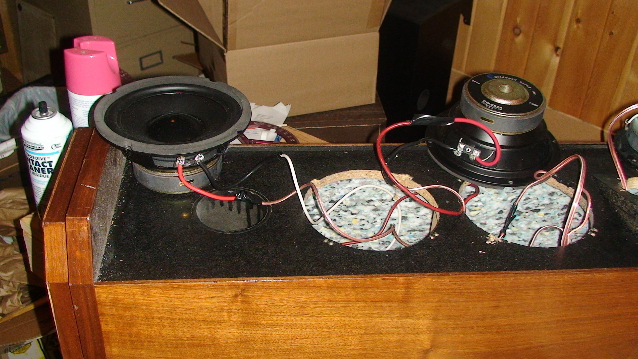

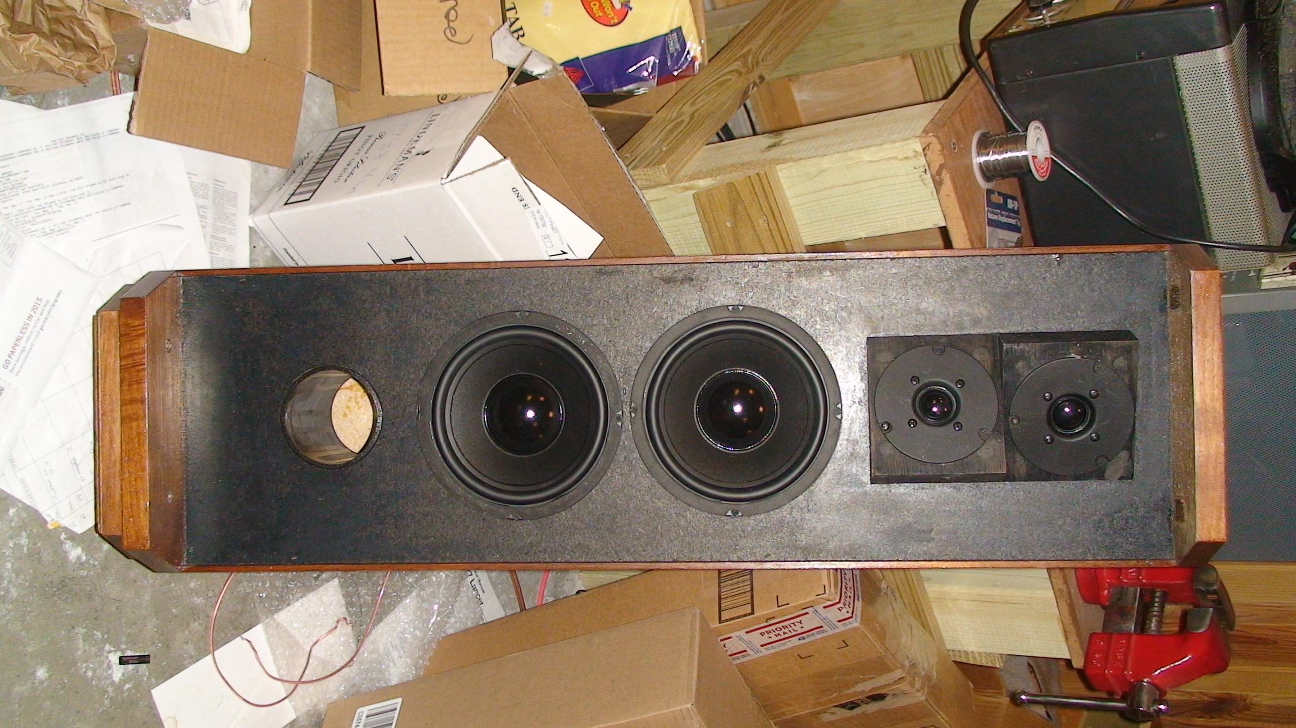

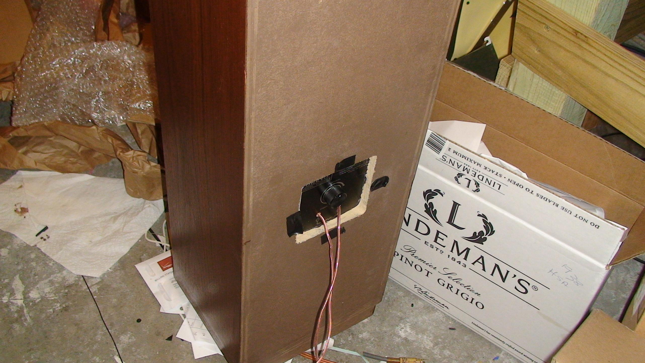

For several months I have been working off and on rebuilding 2 Onkyo radian III speakers. I have attached a few pics of my progress. The cabinets in good condition. I have the original screens.
I removed the xover and drivers and set way aside.
the volume inside are listed by Onkyo (1971), as:
volume
+ 52762.56 cc
= 52.76256 liter
1657.5 in3
30 x 6.5 x 8.5in
= 27.161 558 58 liter.
I measure the volume as 30.75in x 9in x 7in. = 1937.25 cu. in. = 31.745 liter
The drivers I put in are 2) MW Audio MT4003 1500Hz - 20khz, FS: 1350. 4ohm.
2) Goldwood 4 ohm, GW6024
0.84 cubic foot = 23.786 liter
Nominal Diameter6-1/2"
Power Handling (RMS)90 Watts
Power Handling (max)170 Watts
Impedance4 ohms
Frequency Response29 to 4,800 Hz
Sensitivity89.5 dB 2.83V/1m
Thiele-Small Parameters
Resonant Frequency (Fs)53.7 Hz
DC Resistance (Re)3.6 ohms
Voice Coil Inductance (Le)0.4 mH
Mechanical Q (Qms)3.05
Electromagnetic Q (Qes)0.71
Total Q (Qts)0.57

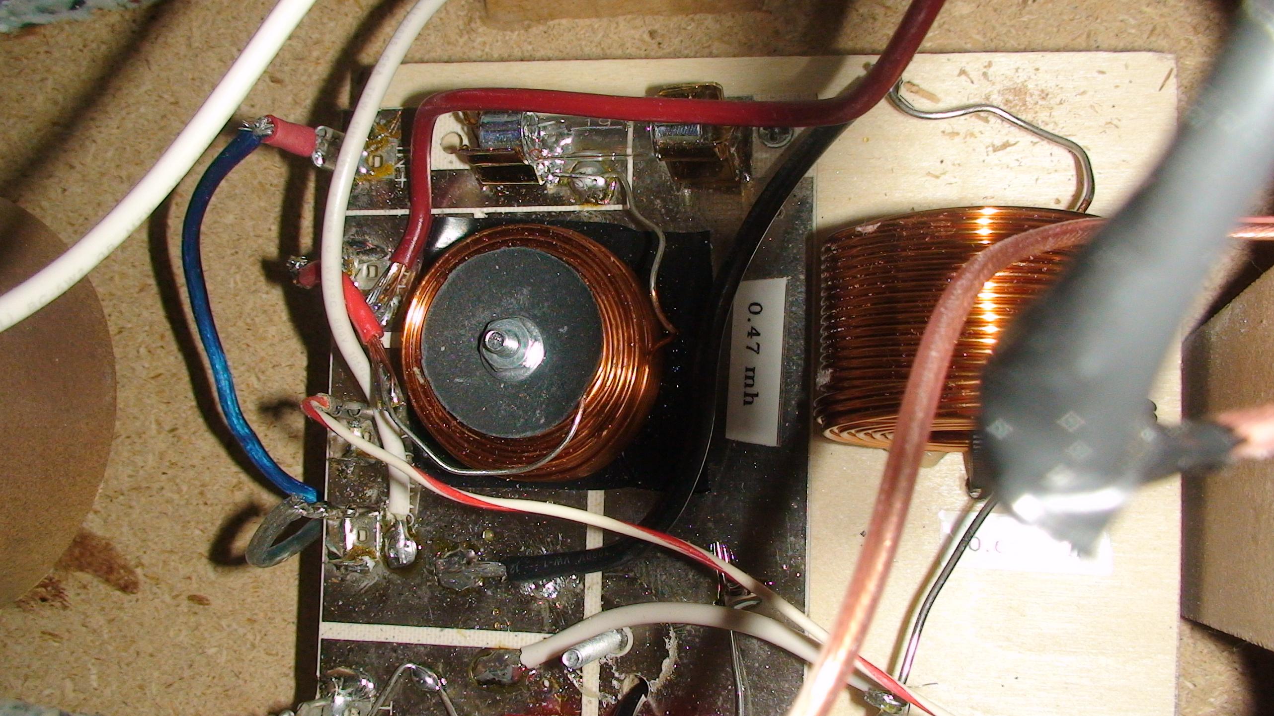

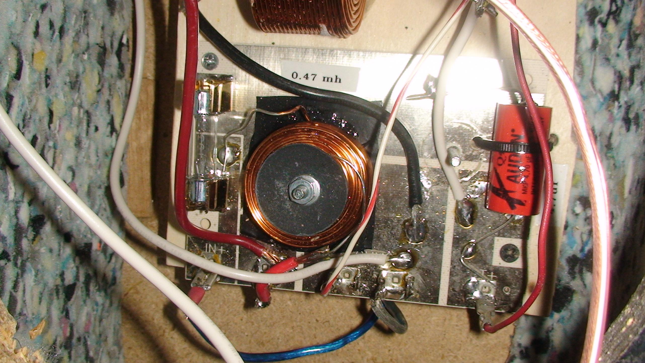

I have them wired in series. A no no? Also, the crossover frequency I was aiming at was 2500hz. attached is the xover schemat.
Any help is appreciated, I think converting to 4 ohm is the way to go, wiring them in parellel, also, correcting the xover. I copied the
circuit from a commercial crossover from Midwest Speaker in St Paul. I may have done it wrong. The bass has a midbass hump, and the highs are congested and harsh, according to my ears.
Tom

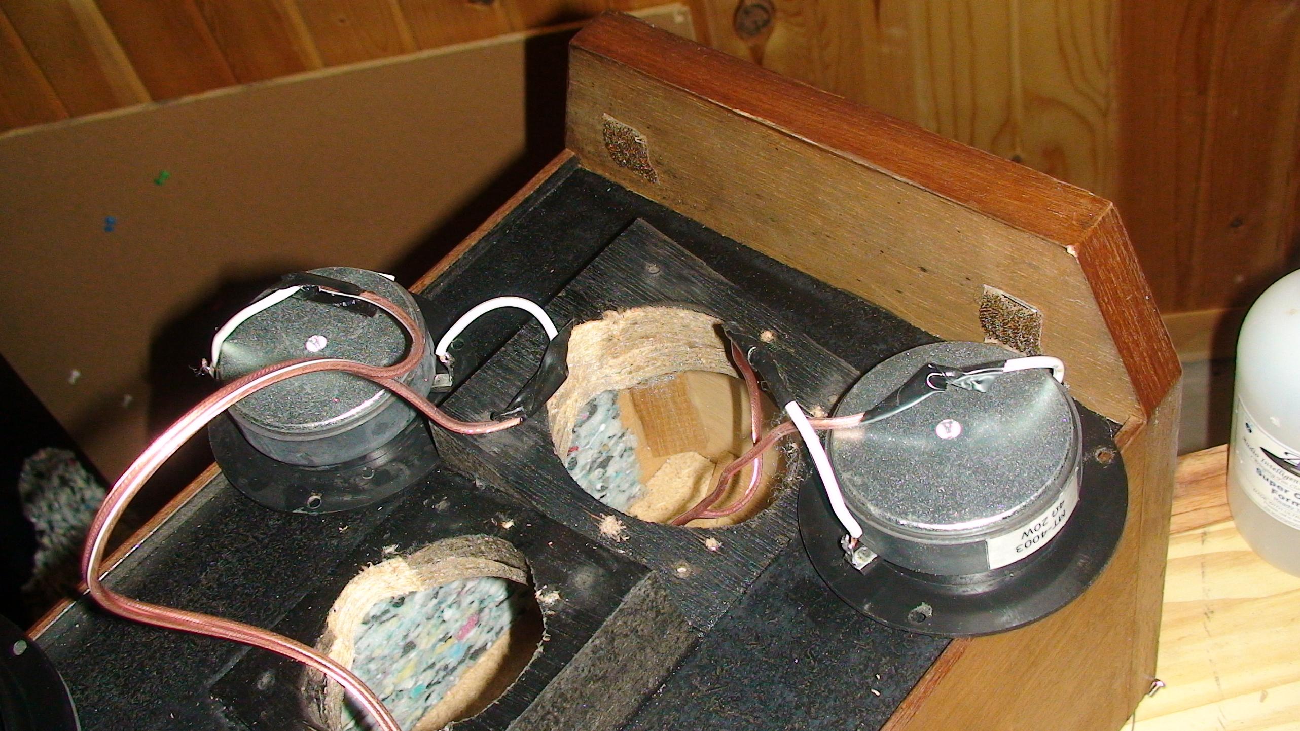

I have gotten this pair sounding pretty good, except lacking in bass. The mid woofs only down to 75hz or something? I will submit technical stuff and diagrams forthwith. Also anyone ever used a crossover/schematic drawing software thjey fell in love with?

re"crossover/schematic drawing software' - google this site for 'Xsim"
'bass has a midbass hump' - usually due to a high Q driver in too small a box - try disconnecting one woofer. With judicious tuning you should be able to improve the low end
'I copied the circuit' - expect to cop some flack for that, ideally the xover is designed for the exact drivers you're using
'highs are congested and harsh' - probably crossed over too low
'wired in series. A no no?' - not a problem

Pete, thx for your replies, much to chew on. Currently I am working on drawing the xover schema, I have put in 4 JBL LE20 tweets and they sound good, no harshness. The harshness is gone, just tuning the bass is left. Can't believe how good they sound now.
My Mom is dying of Alzheimer's and that is taking alot of my time, predictably.
But I still want to measure the speaker out. I bought a mic from Parts Ex., dloaded software, etc., don't know if I need a good soundcard setup for my
laptop? Or can I just use the mic input on the laptop. I know it works, I use it currrently for line level programming.
