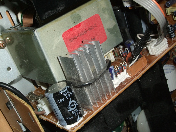

I have a ONKYO CR-305TX that I've checked the fuses, but it doesnt power up.

Looking inside at the PSU there is a lot of paste around the bases of some components - is this normal? (see attached photo)

Looks like caulking.
I assume it is semi hard?
Not sure why they did it other than to keep them from being microphonic or vibrate.
I don't think it is leaking from anything.
I haven't been inside an Onkyo but it almost looks like something a DIY would do, not the factory.

Thanks for you reply Tom,
yes its hardened and also on a couple of large capacitors & some other components that you cant see in the photo - perhaps signs of a previous repair then.

They put that Gunk on some of the components to anchor them down because with an amp the virbrations can over time cause come components come loose ...... I generally see it on the larger components like big capacitors .....

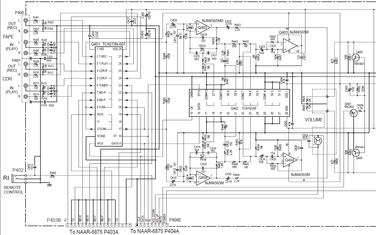

Different issue - distorted audio
Mine has distorted audio in preamp stage, both channels. See attached schematic portion. Audio is loud and clear going into pin 5 of Q403 & Q405, but pins 6&7 (on both) are extremely low and highly distorted. Thoughts??
Disconnect one end of C429. Does pin 7 now give signal? Then problem is a short past that point. (But not much there, unless the mice have been storing pennies on the Volume pot lugs.)
Shorted C413, but 100p caps don't short. Also you say both channels? Has to be something common to both.
DC voltages at NJM4565 pins? Decent or dubious?
A dead NJM4565 seems very very unlikely, but if nothing else comes to light, it is going that way. TL072 is probably a fine replacement, just to check and maybe forever. (Wait-- the gyrator at Q403 2-3-1 has a 680r, which is a bit low for TL072, which may be why a NJM4565. Still, audio should pass no-fault when the Loudness(?) feature is not selected, and small-fault when it is.

For purposes of following up on your post, I'm usuing even number (right side) component testing - only because that side is easy to access on the board without requireming me to fully remove the board...
Yes problem is on both channels.
So disconnect C430 shows no change. EXCELLENT debug tip though to cutoff the following part of the circuit. I will file that under "always remember this tip"!
Voltages on NJM4565 are as follows:
Pin 1 13.2V
Pin 2 13.2V
Pin 3 83mv
Pin 4 -133mv
Pin 5 53mv
Pin 6 12.5V
Pin 7 13.1V
Pin 8 13.8V
Some minior variations around those reading depending when I took them, but no more than .5V on the big ones.
