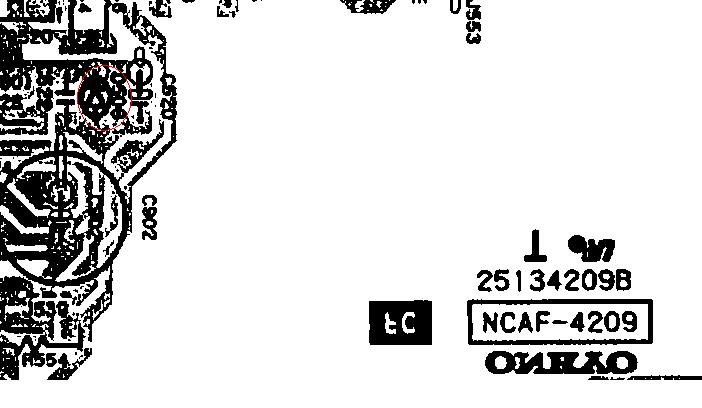

if you can could you indicate the location of c853 physically on board ?
the red light diode is on NCAF-4209 board, that on official service manual is NAAF-4209, the diode is D506
please see the image : the red point, on the right

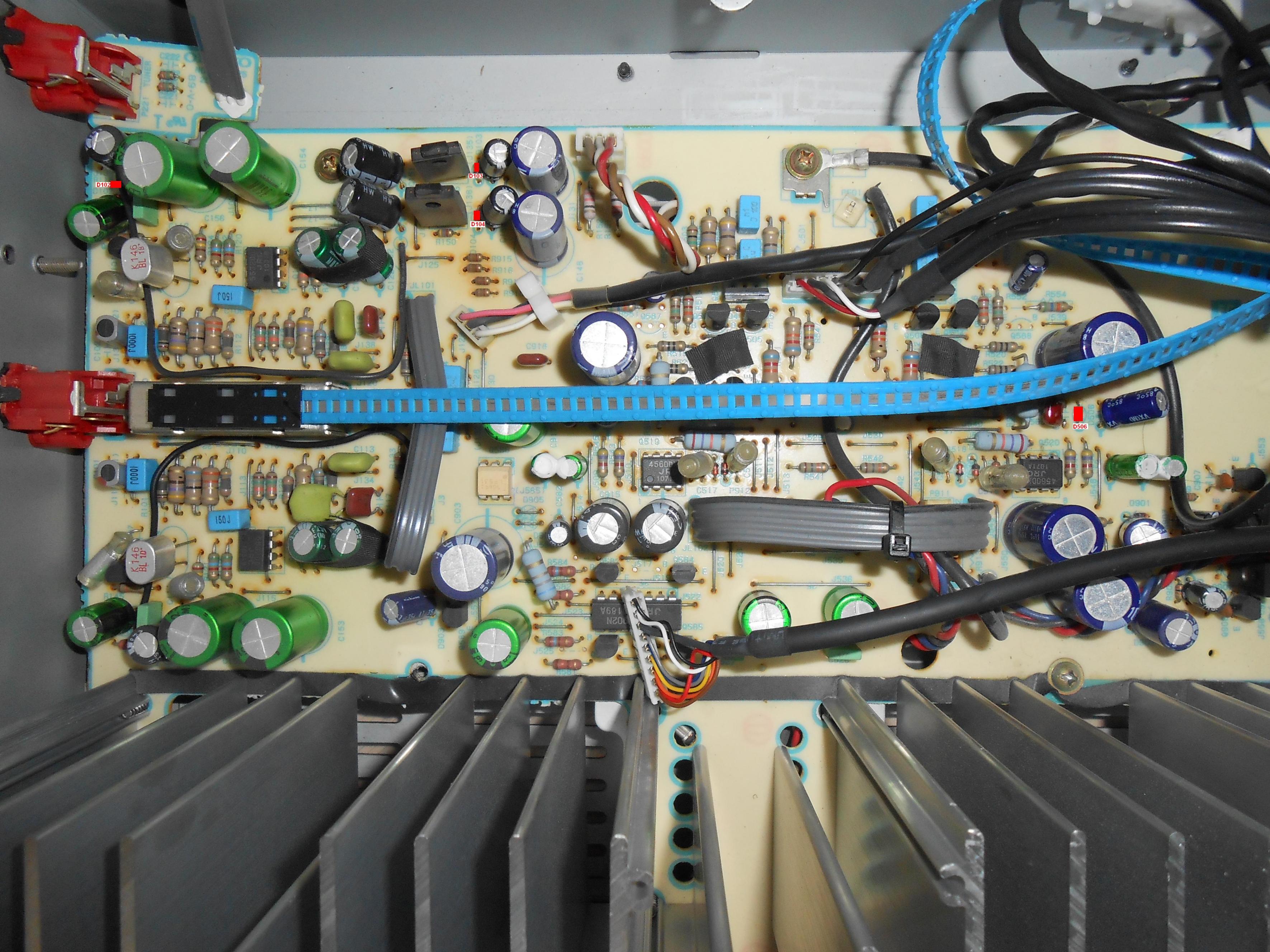

i controlled and the diode that have red ligh are four!!
please see the image red marks
the diode numbers are D506, D102, D103, D104
upgrade :
when i disconnect the cable P104 the diodes D102, D103, D104 power off none red light.
this cable come from power board
diode D506 again red light
does the problem on power board ?
does it is the phone stage ?, i don't need it and i could disable it
Please don't try to remove the indicator LEDs or any other circuitry. This what I meant by saying "don't shoot the messenger" which is what many people think is the way to fix protection and control circuits. If you don't understand exactly how it works (or will work when other faults are cleared) then don't remove or disable anything.
Find the IC Q851 on the power board first. It has 9 pins in a single row (SIP type) and nearby will be the capacitor(s) to check. I'm not going to point it out but I recognize it near the bottom of your pic, about 30mm to left of the lower end of the heatsink. The part numbers will be marked so it can't be all that difficult.
i can't find IC Q851, i've seen s.m. and probably it is in the front panel
where i could search it ?
As before in #2, start with C853. Surely you can see 3 round caps either side of the IC? Look at the cap values and check this against the part numbers printed on the PCB - assuming you have the parts list of the service manual to refer to. Have you also got a meter that reads capacitance or a similar part to substitute there yet?
Ok, if you have power at pin 9 of the IC (~ 40-60V) it should still be OK. The other 2 caps should be checked also but first, do either speaker relays RL851, 852 or headphone relay RL853 close (click) when you power up? If you can't hear them easily, you can make a simple "stethoscope" by holding a short stick of wood, like a short kebab skewer or hard plastic rod between the relay case and your ear lobe. I often use a screwdriver. Crude, but it works.
