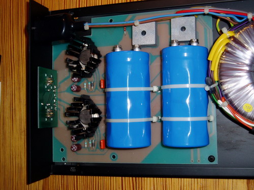

i have soap2, oa24 pre and oa601 power amp
i don't know if they are compatible but soap2 has two outputs - one that is non-regulated (only filtrated) +/-36V and second output that is "24V regulated" - i assume that this one might be +/-24V regulated but i am not sure on that one.....i can provide you with the pictures of the back of the soap2 but in a few days...(my camera is not here at the moment)....

Sparkle, the regulated 24v output is for the Onix tuner I believe. The +-36v output (un-regulated) is for the OA21/other Onix amps.
I am fairly sure that the OA21 Mk1 uses 36v like the OA21S.
I think it was purely the connector that was changed.

"regulated 24V" is also used for my OA24 preamplifier power supply......i don't know about the tuner psu - +/-36V is used (i believe) for OA401 power amp and maybe other higher current components because it is not regulated (it has only 2*10.000uF filtration) and "24V regulated" i believe to be only "+" using (i think) 2 LM317 in to3 package - it was a long time since i have opened the box - i know for sure that there is on LM317 in there and for the other one i am not sure - i can check if you need if the other one is LM317 or LM337.......
The OA21 has no pre amp, just a volume pot. The SOAP goes straight into the power amp. I would therefore assume that it uses the non-regulated supply from the SOAP.

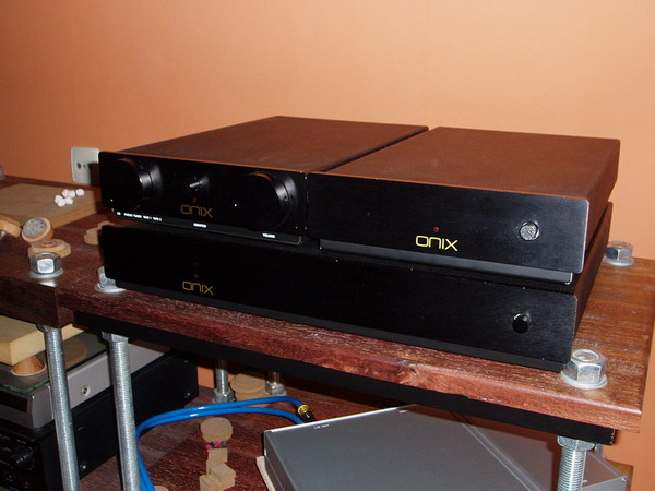

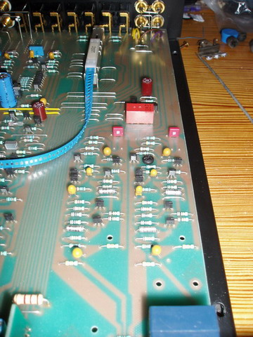

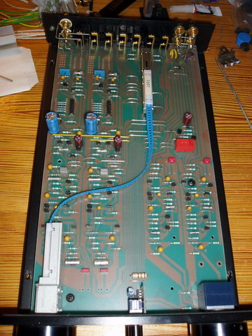

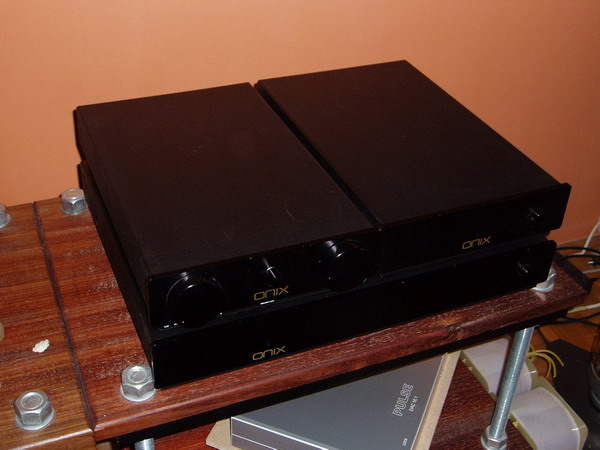

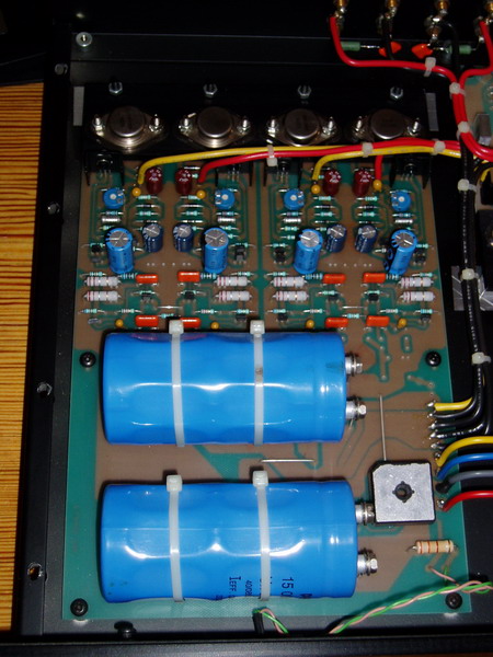

some images....
Dear Carlos - i do not have enough data related this amp because this company do not exist any more (unfortunatelly) ..... no schematic, no user or service manual - pitty
the output transistors are SM3159 and SM3160 - don't know the manufacturer......
how it is sounding - well, you can imagine - the problematic part is to use good interconnect cable between preamplifier and amplifier (i was using Kimber Cable Silver Streak) - with a good cable this baby is sounding a lot better than everything that you can find for the normal price arround - this combo is a monster that will never bite you - it is alike a good friend that you can count on - very reliable and very good made.....has also good parts in it that will last long....
i don't know when it is made but from the output transistor markings i assume 1994-95......
it is 70W/8ohm, 140W/4ohm, 240W (or 260W not sure)/2ohm.......
the price is arround 700Euro's more or less.....
