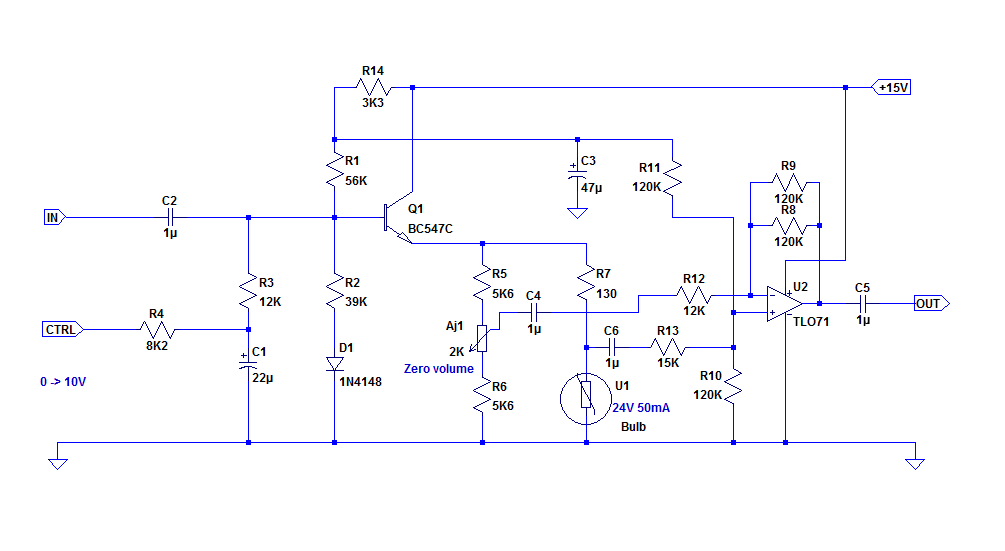

I have already presented a number of "creative" volume controls.
Here is another item to add to the collection: this one uses a light bulb as control element.
Brilliant idea, isn't it?
Volume is controlled from zero to the maximum with a 0 to 10V control voltage.
Couldn't be simpler.
How does it sound?
Bright is the first word that comes to mind....
How does it sound?
It might even be more linear than an LDR volume control. At least we know a bulb is ohmic, provided you are quick enough.
Indeed: nowadays, all LDR's seem to be made by film deposition on a ceramic substrate and are severely non-linear.It might even be more linear than an LDR volume control.
