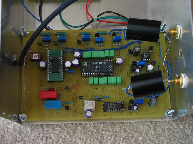

Here's a closer look at the DAC board.
You can see one of the AD844s on the right.
Big 10uF solen MKPs as output.
Tent clock on the bottom. I'm using the suggested powersupply from the XO documentation for the clock.
That's a 74HC4040 divider which I'll switch to VHC later.

good question.. the most expensive part was the TDA1541A S2.. it cost $90USD. The Tent clock was about $25 USD. I guess overall, it cost about $150USD to make? Not too bad.
those two jacks on the left are digital in. BNC and RCA jacks. I mainly use BNC so the RCA is free.
That empty hole on the right between the two output RCA jacks IS a drilling mistake!

the blue rectanges are bournes multiturn pots. I got them locally.

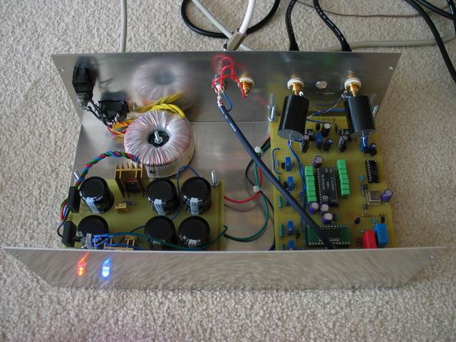

Most of the heat comes from the 1W resistors that are in series with the TL431. They dissipate about .8W and i measured it with a temp gun at 50degrees C.
The TDA1541 gets slightly warm.
The power supply outputs +/- 16VDC and its regulated down to +5, +5 for the CS8414 , +5, -5,-15 for the TDA1541, +/-15 for the AD844, +5 for the clock.

I see some Active Surplus Electrolytic caps in there!
10,000 uf if I am not mistaken.

Active surplus caps? No I only got the 74hc4040 and the IC sockets from there. I got several things from Sayal and Supremetronic though. The caps in the AD844 stage are nichicon low ESR caps. They're 100uF and 220uF. The power supply caps are 4700uF/100V I had lying around and they're Panasonic TSHA series from Digikey.
I basically used the schematic from here:
http://www.geocities.com/react_71/audio/tda1541a_dac/tda1541a_dac.htm
for the digital part (excluding the clock).
For the clock power supply, I used the schematic from here:
http://home-4.worldonline.nl/~t708955/pdf/XO%20folder.pdf
I used Doede's method for feeding the clock signal using a 74HC4040 from here:
http://www.dddac.de/files/dddac1543ver22.pdf
Put them all together and that's pretty much it.

Hi, i'm the brother-in-law of the person who built this DAC.. so i can jump and answer some of the questions..
His output caps are 10uf Solens. I would try to get something beyond solen unless you're on a budget. For resistors, I believe he's using Dales if I'm not mistaken. And yes he's using oscons as his digital and analog bypass caps. I've read on many occasions that oscons are not great as analog bypass caps. He's also using 0.1 uf wima caps near the tda1541 s2 chip. He's definitely using shunt regulators, which are quite good. For the diode bridge, he's just using generic bridges and again I would get schottkey type diodes for the bridge if i were doing this. As for the transformer, I forgot which one it is, but it's the one that's listed in the crystal recommended datasheet in the cs8414 section. He bought it off digikey. He's also stated which one it is somewhere in the diyaudio board. Just search for it.

74hc4040 doesn't seem a good choice
I don't understand why people try to upgrade their clock section and use a ripple carry (asynchroon) counter! 😱 😱
Their must be better choises for a clockdivider.
Or do they try to create a latency between the 2 clock inputs on purpose? (less harsh ripple on VCC?)
