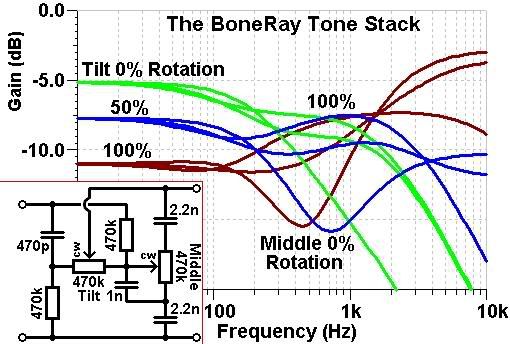

Yes they look ok for tubes.. You might also be interested in a tilt+mid control I designed:
http://i81.photobucket.com/albums/j207/merlinblencowe/BoaneRayStack.jpg?t=1269469948
Tubes need high resistances because the tubes themselves have high output resistance. If you tried to connect the output of a tube to a low resistance you will lose most of your signal level.

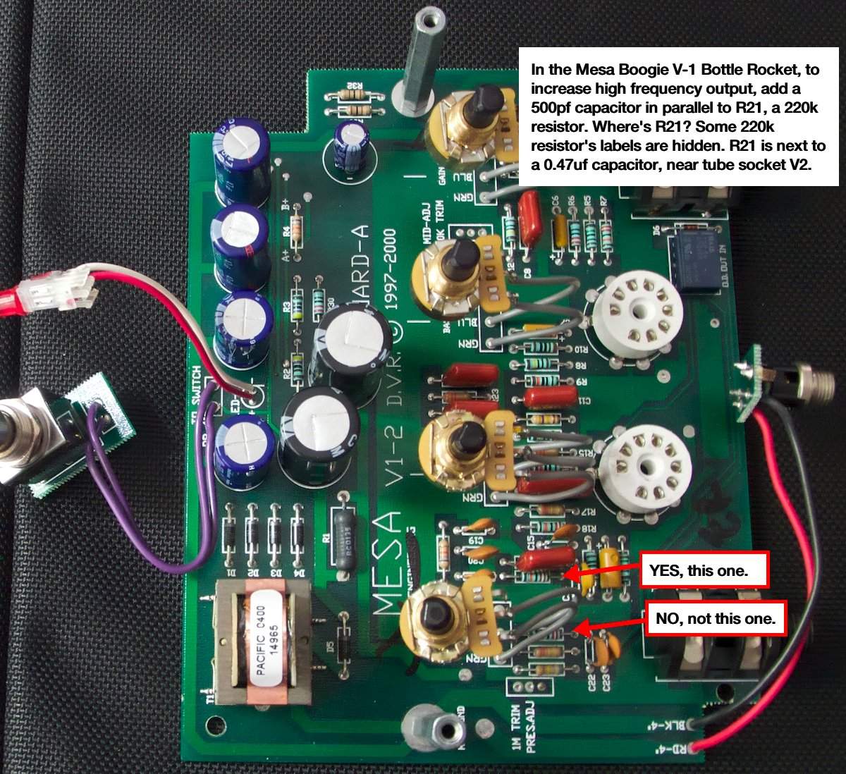

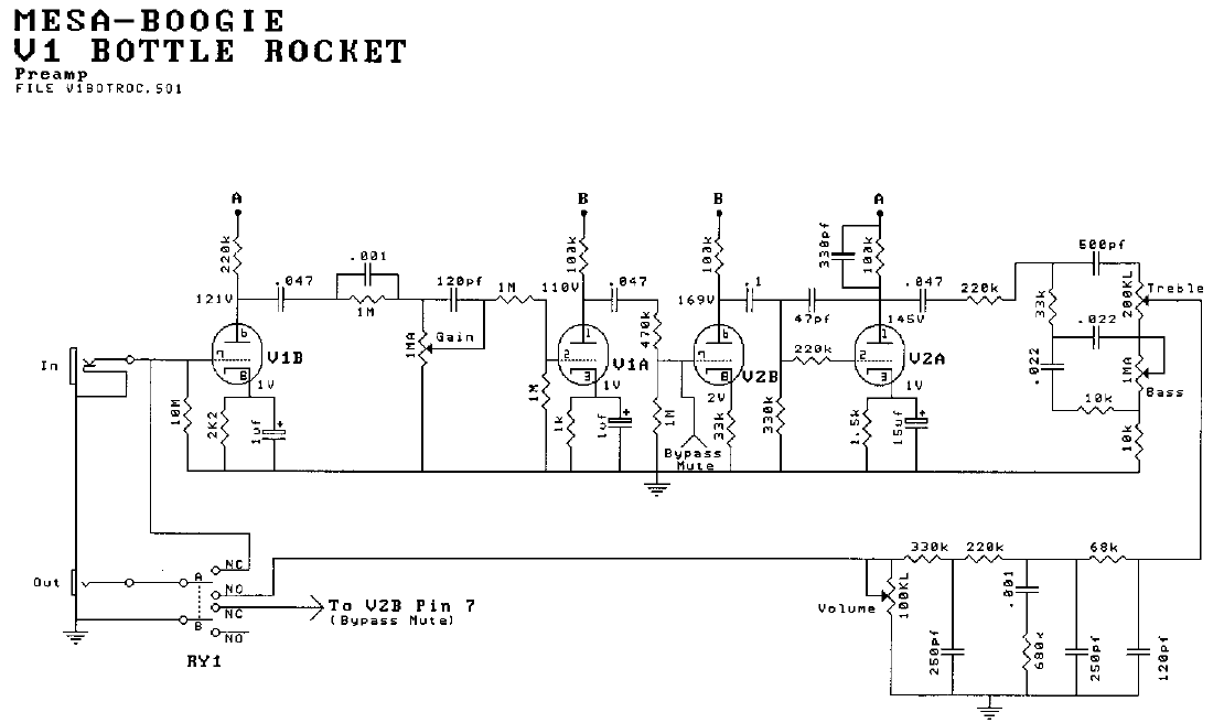

i've picked up a Bottle Rocket pedal, made by Mesa;
it's cool, but lacks midrange and headroom.
i need help to fix the loss in tone stack and maybe reduce the clipping.
theres two places in the PCB with slots to install potentiometers: one for mid (20k), other for presence adjustment (1m)
i've tried these, there was a slight difference, but i've felt there was a faint loss in the output, tried with suggested values and diff. values too... no good
also tried diming to 0 bass + treble to achieve a mid tone, but this approach also resulted in loss of output rather than resolving my need
maybe we should start by lifting the tonestack to full bypass it with raw signal?
